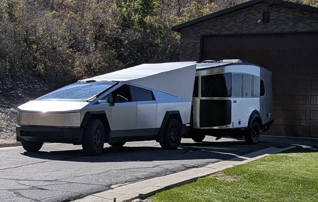

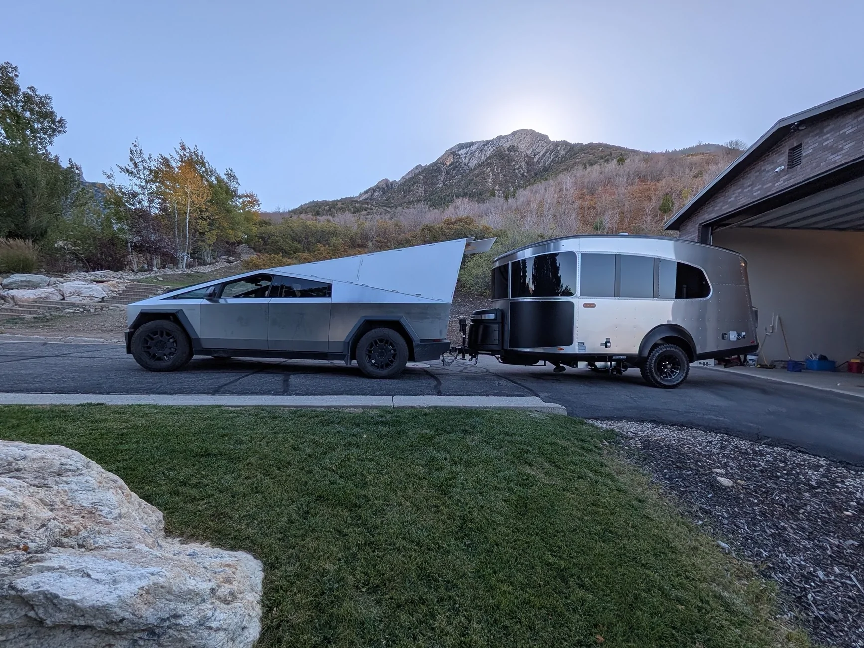

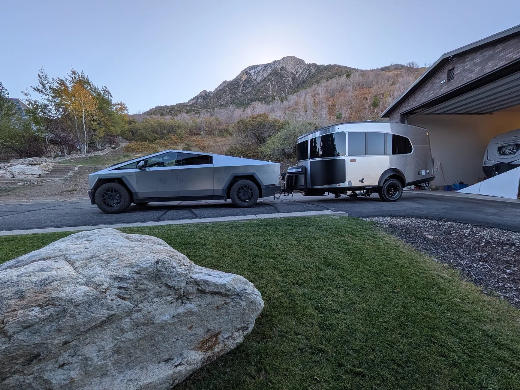

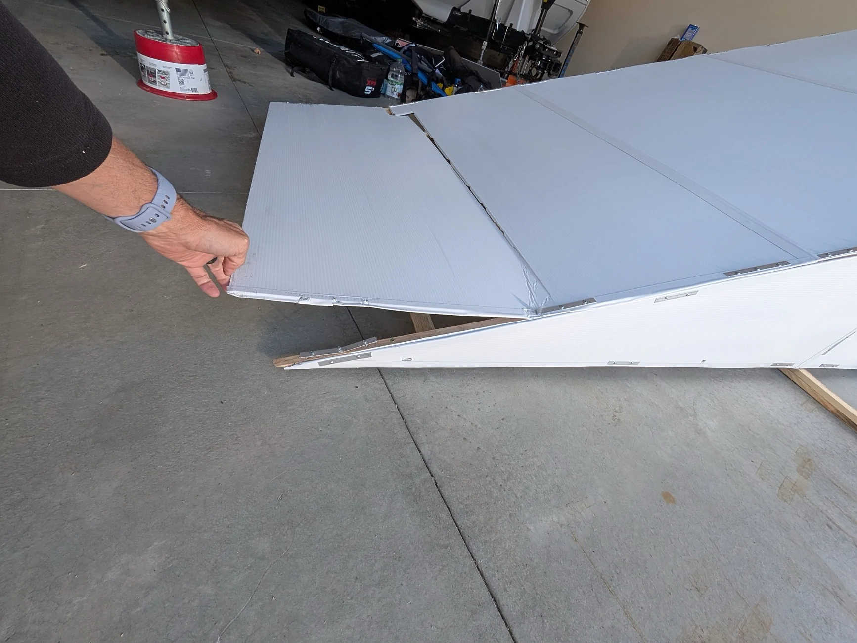

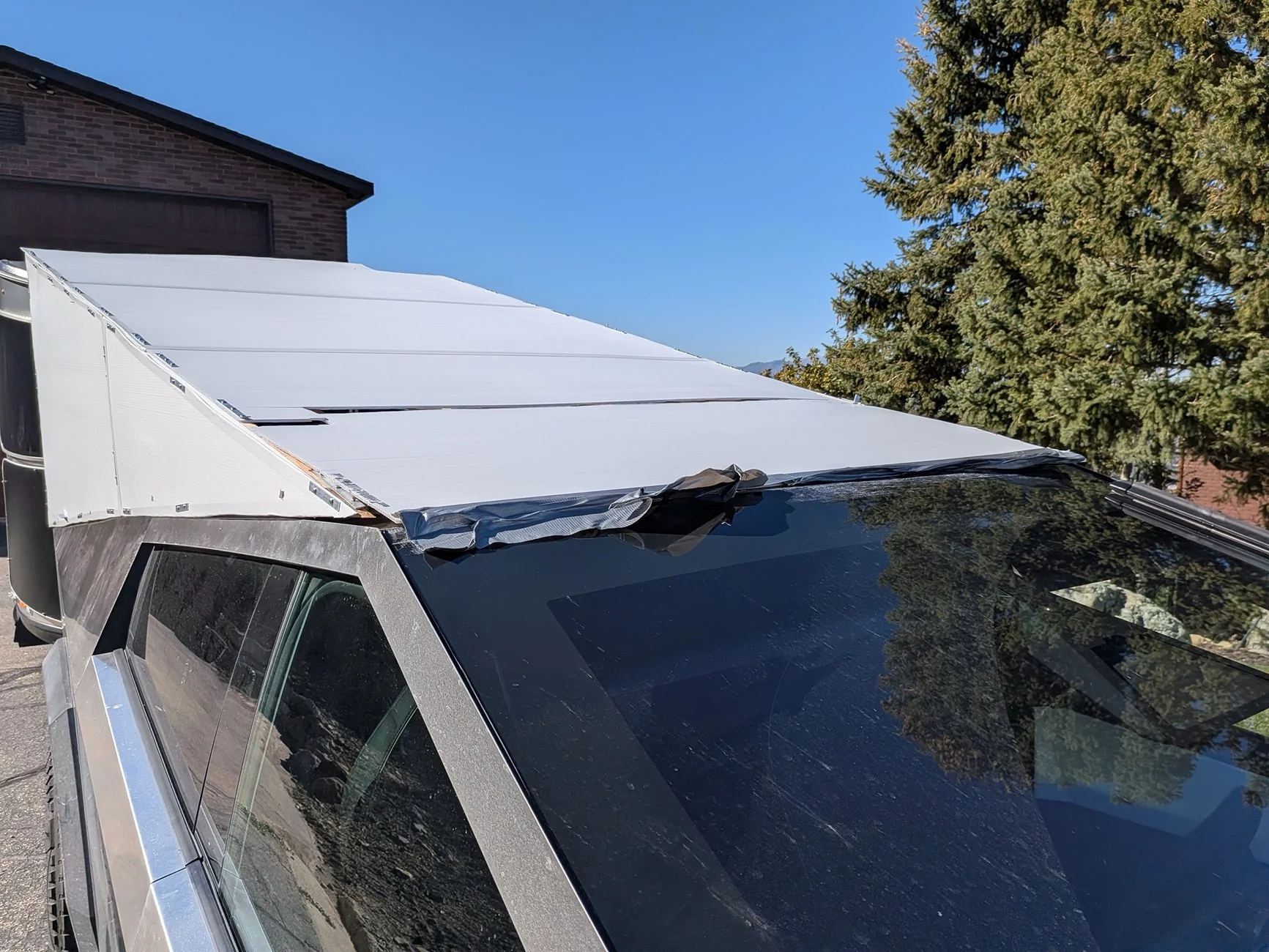

Test Complete!!!! Big Thanks to Airstream of Utah for letting me do the test.
I did a 17 mile (total) out and back (4 times total) with cruise control set for 60 and 65. Temp around 50. Flag along the highway basically limp (very little wind). Climate control off to minimize any weather related battery usage. A little bit of altitude loss heading West, which I gained back heading East. I hit trip reset at the start and took a picture of the energy usage when I passed the same spot coming back.
It did not go perfectly, in that the front of my wind deflector was fluttering like crazy with the trailer behind it. This is in contrast to no flutter without the trailer. I tried to stop the flutter by duck taping the front edge down to the top of the windshield. It would only hold for about 7 miles. It would flutter badly for about a mile with masking tape everywhere until I got to my U-turn spot, at which point I would get out, tape it again, and then do the leg back. Once again, it would flutter about a mile from the end. Without the flutter, I think the range would have been even better. After the test was complete, it pulled off the front completely on the way home. Luckily I was able to limp home.
Altitude about 4,500 above sea level, which gives me better range than anyone at sea level. In the summer, the density altitude is over 7,000, so towing range will be even better in the summer.
Results towing Airstream Basecamp 20X with (stupid) off-road tires at 4,500 MSL:
No Deflector 60 mph - 620 Wh/mi = 198 mile range
No Deflector 65 mph - 688 Wh/mi = 178 mile range
Deflector 60 mph - 546 Wh/mi = 225 mile range
Defector 65 mph - 601 Wh/mi = 204 mile range
So with the Defector, range is at least 10% better. If I had had access to the trailer earlier, I would have made the side panels longer to bridge more of the gap, probably increasing range even more. Vortex Generators on the sides would also probably increase range.

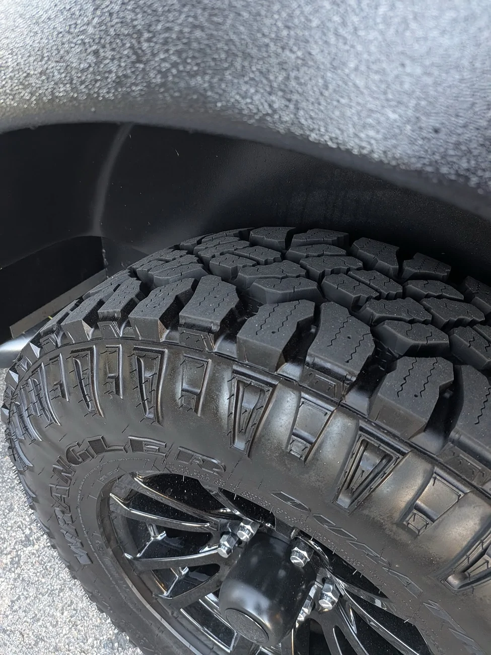

Tires on the trailer are RIDICULOUSLY knobby. I can probably get another 10% improvement with road tires.
This wind screen was a rough prototype. If I would built it again, I would use 1 inch Aluminum square tubing, and a metal flat section for the front roof just above the windshield to prevent flapping.
I was originally going to make this for my son, who is getting a Basecamp, but the design got so long and tall that he has no place to store it. So I think the project dies here for now.....

Test Complete!!!!
Altitude about 4,500 above sea level, which gives me better range that anyone at sea level. In the summer, the density altitude is over 7,000, so towing range will be even better in the summer.

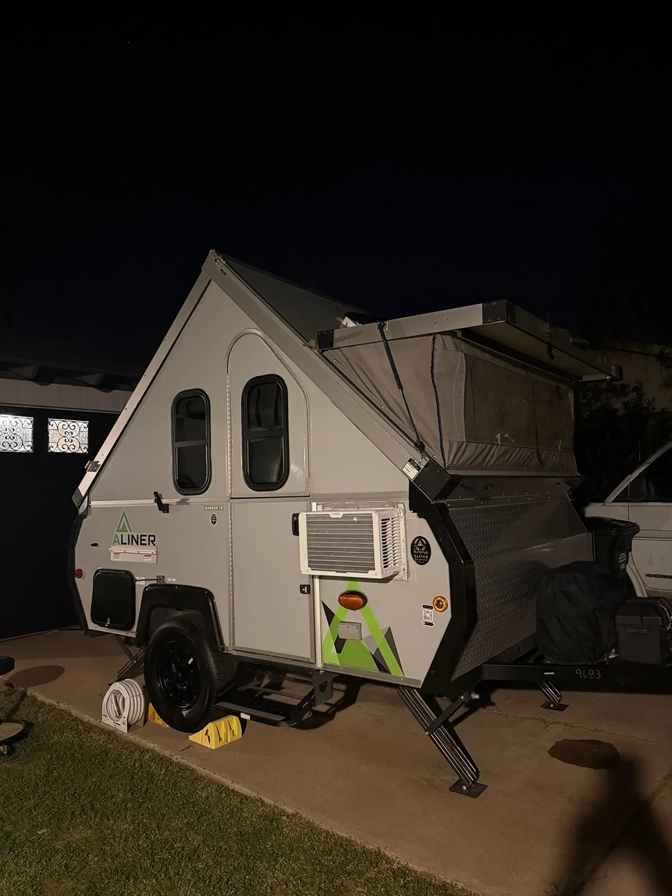

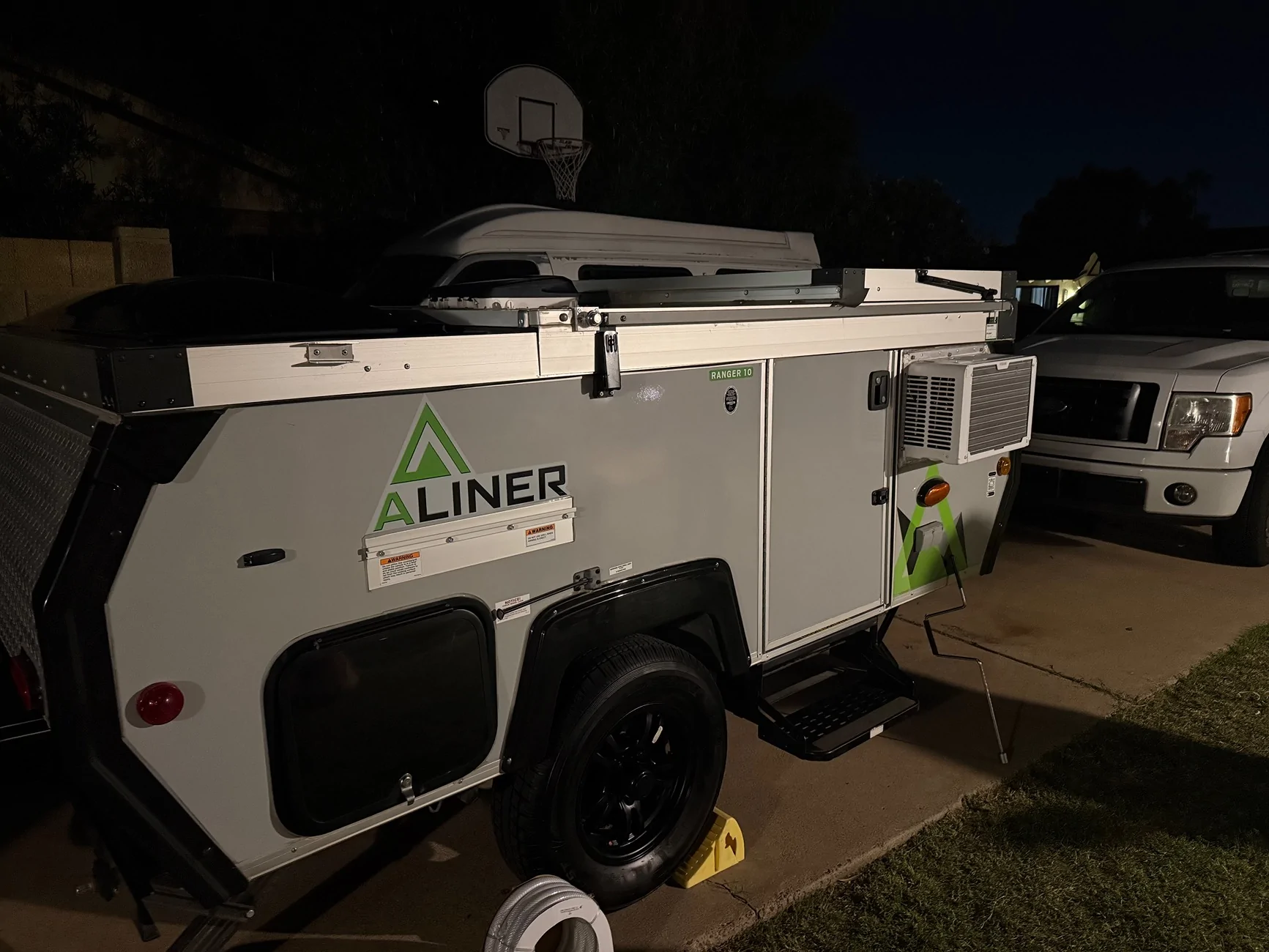

Picked up this new toy over the weekend for a song. Going to split it with my in-laws. Will keep it in washington over the summers and here in Arizona during the winters.
Do you guys think there is any benefit to “deflecting” for something low like a pop-up?
It would be easier to tell the potential benefit once we have a photo of the truck/trailer combo from the side view.
It would have been nice if that air conditioner could "pop-in" when not in use!

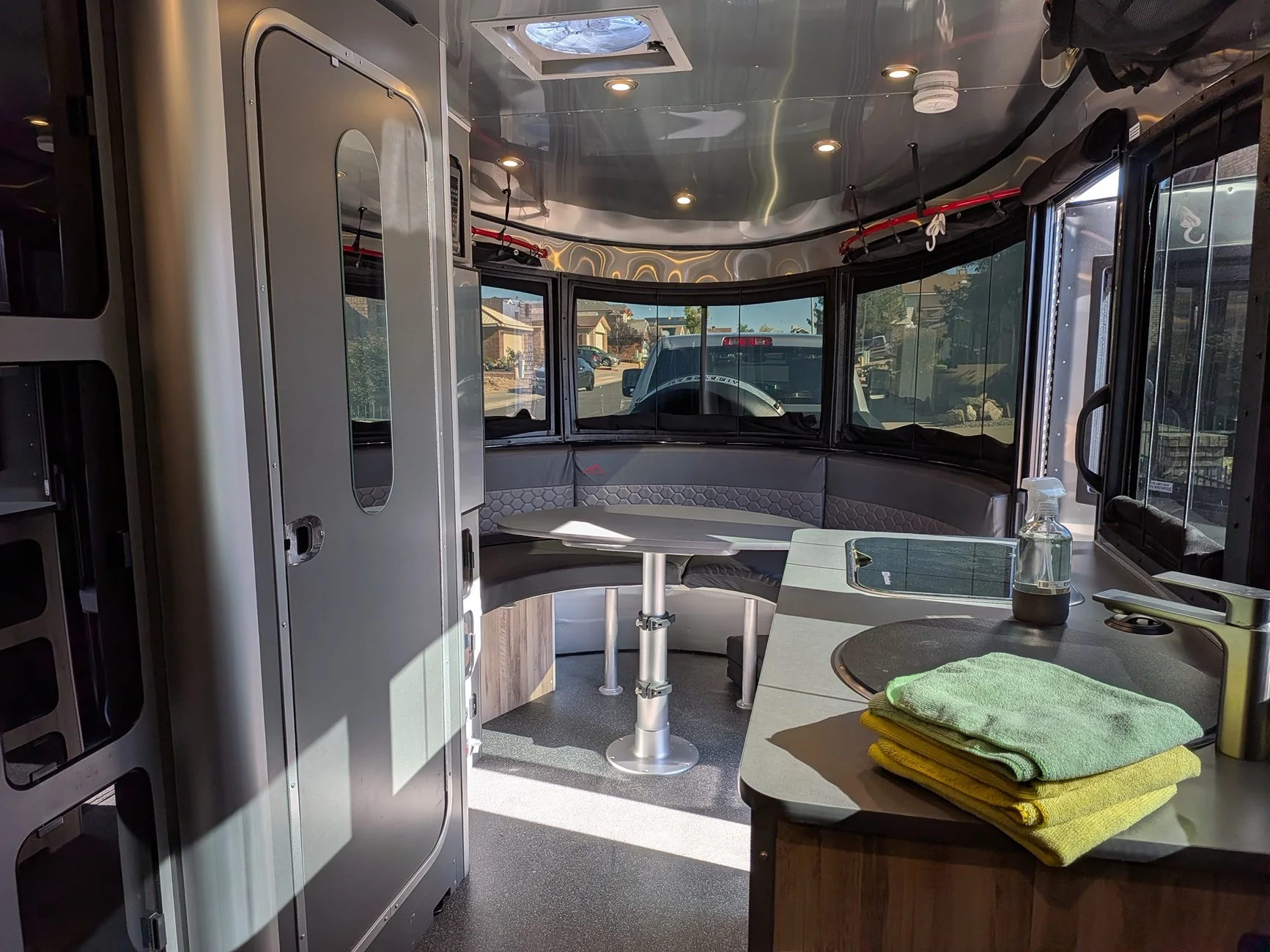

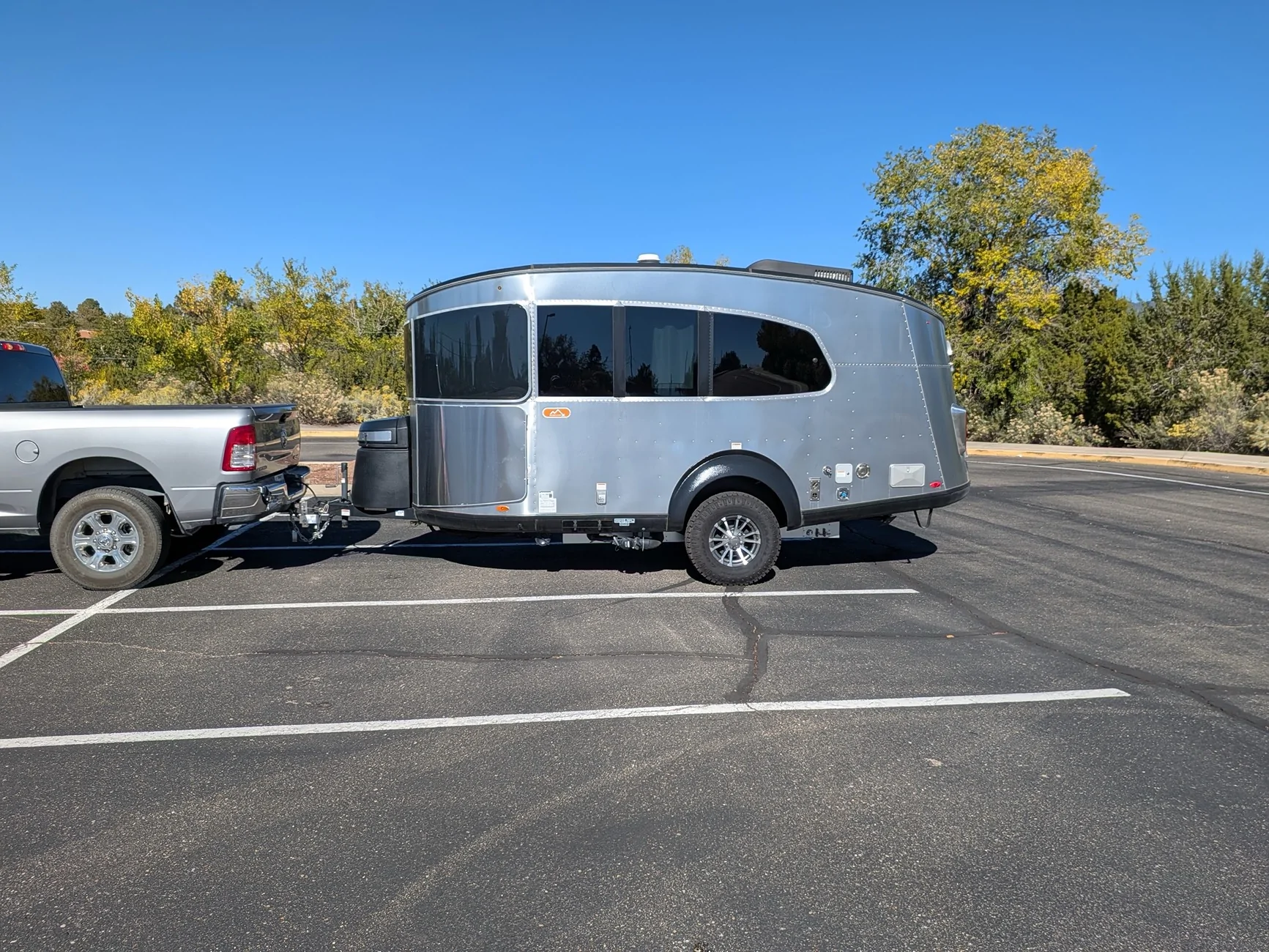

We were looking at Aliners for my son, but the daughter in law really wanted an inside shower. We ended up getting a 2023 Basecamp 20 with only 500 miles for $39,500. The dealer wanted $36k for the Aliner Evolution LG. The fact that they were similar in price was crazy.
The Aliner should be under 550Wh/mi at 65. I don't think a deflector will help much because it is pretty much shielded behind the CT already. But see how it lines up, and maybe do something small starting at the start of the tonneau and just going horizontal.

That airstream is incredible. Wasn’t actually planning on a trailer at all, it’s just one of those “happened upon an amazing deal” things.
My thoughts at this point are that between the cybertent and that thing , I’ll have the ability to sleep my whole family off the ground and without unloading anything., nice for weather, wildlife or any other reason.
The idea would be that I can fold up quickly and hit the road in the morning.
im also going to cover it in cigs panels and even carry my delta pro-3 in there so maybe I can charge the truck a little while boondocking. Probably a couple of my 400w suitcase panels or 600w solar blankets too to set up on the ground by the trailer.
Plus, my father in law really wanted it and he’s a good old retired dude. He wouldn’t have bought it if I didn’t go for half. Always nice when they agree to any kind of help. I also think he’ll make good use of it fishing.
