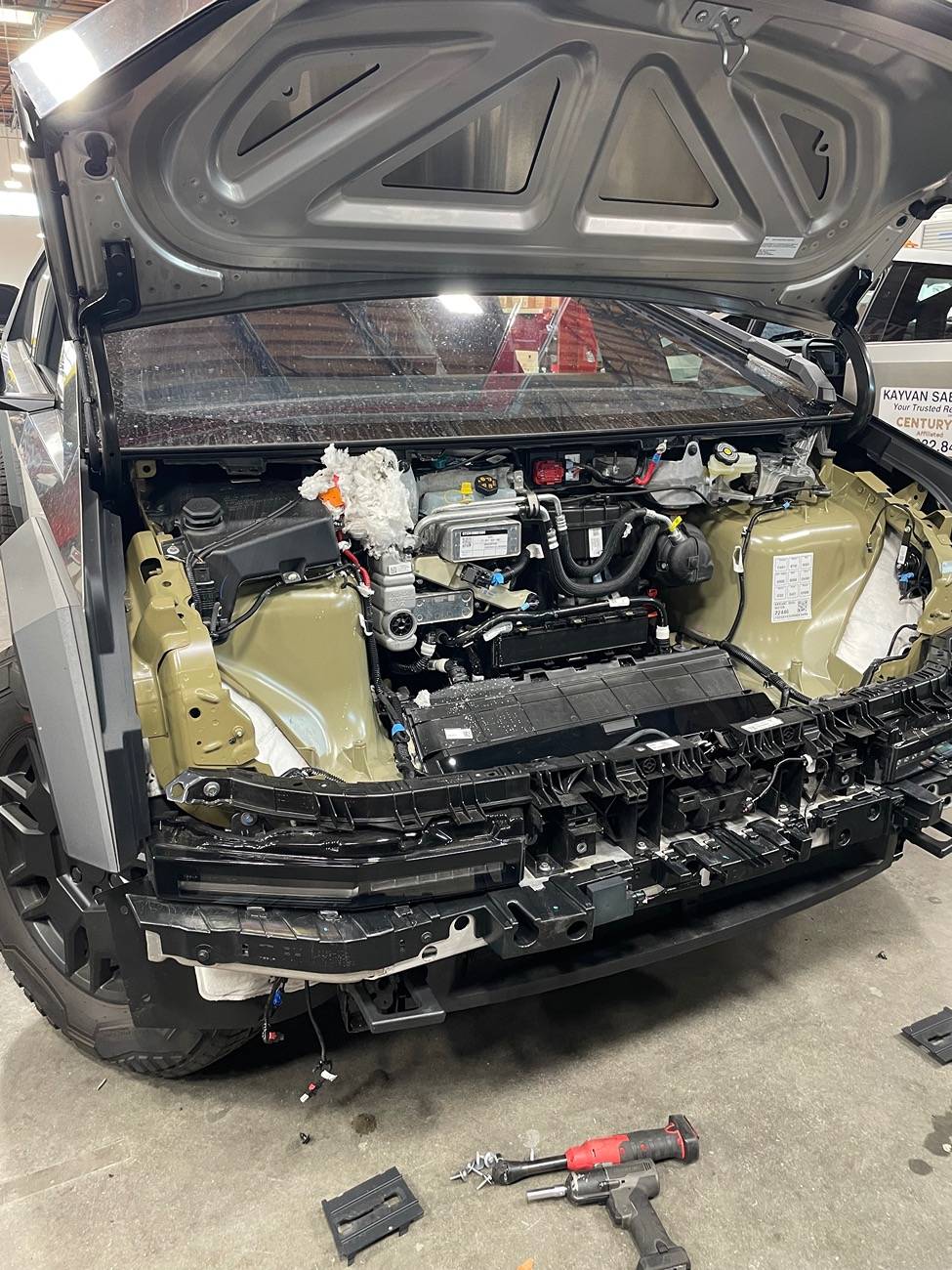

Tesla Cybertruck Rodent damage - any ideas or tricks to prevent? Screenshot 2024-11-17 at 06.17.25

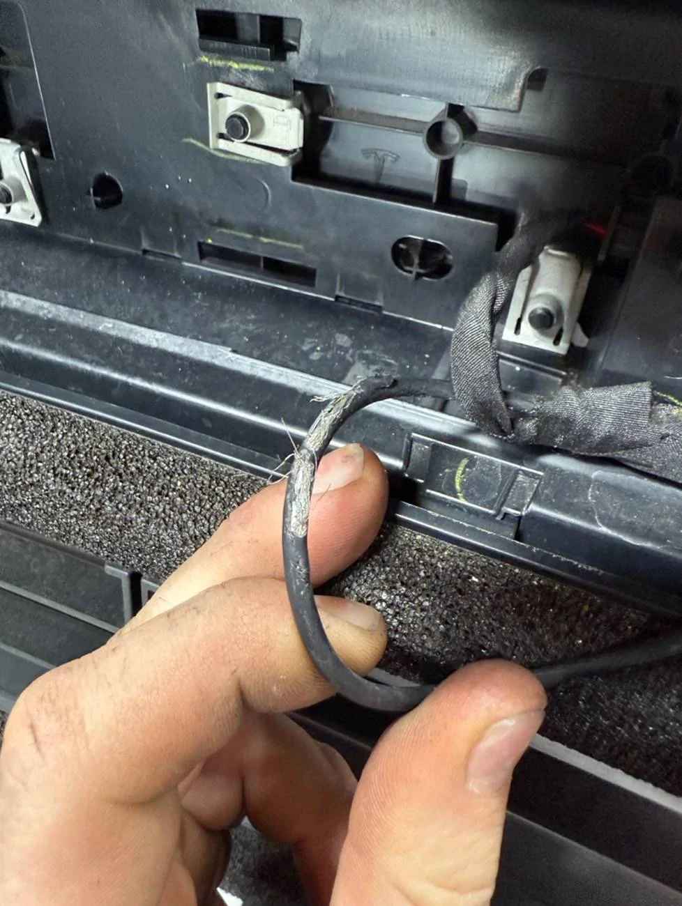

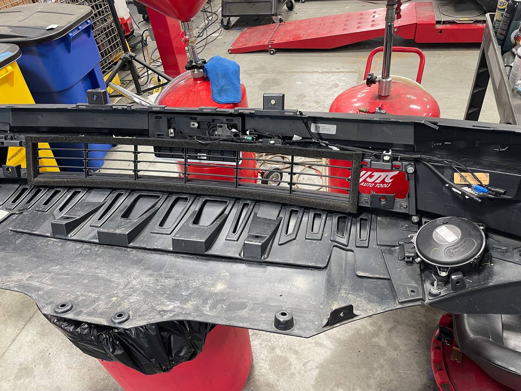

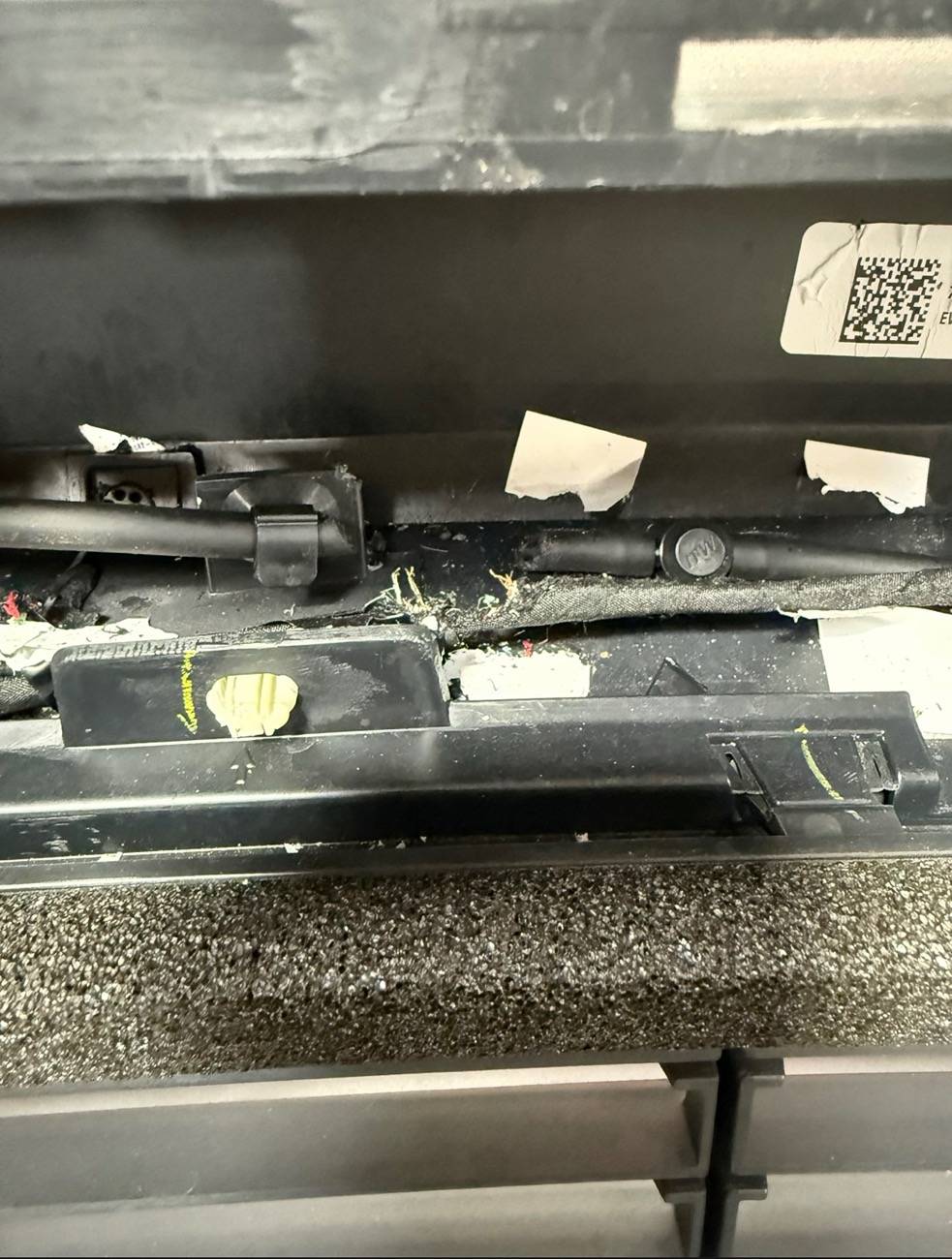

My local service center discovered why my front camera stopped working. The evidence points to rodents chewing up some wires, plastic, and insulation behind the front bumper and frunk area. They must really like Tesla plastic/rubber for some reason. Any ideas/tricks to help protect from rodents going forward?

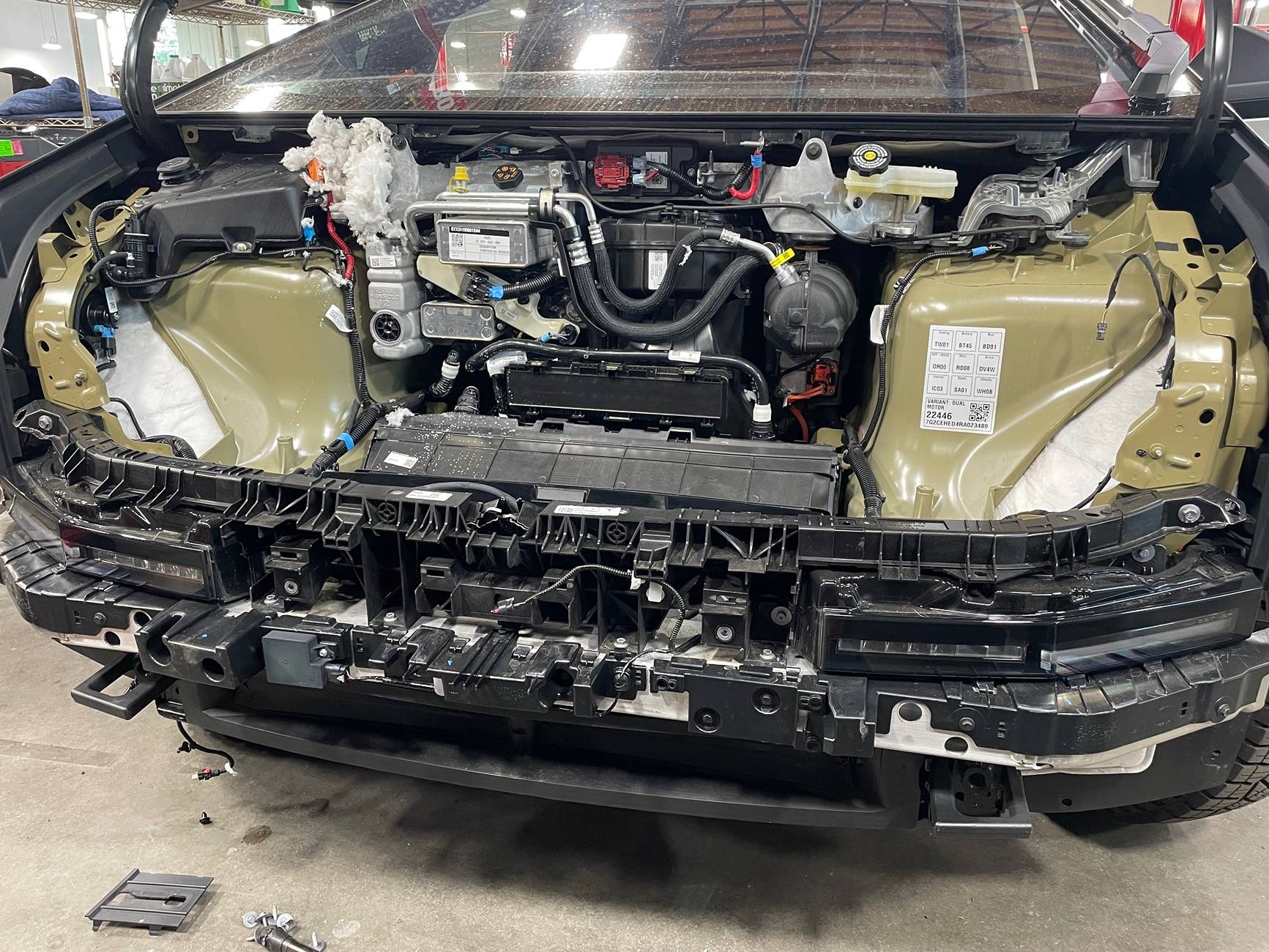

Tesla Cybertruck Rodent damage - any ideas or tricks to prevent? IMG_0601

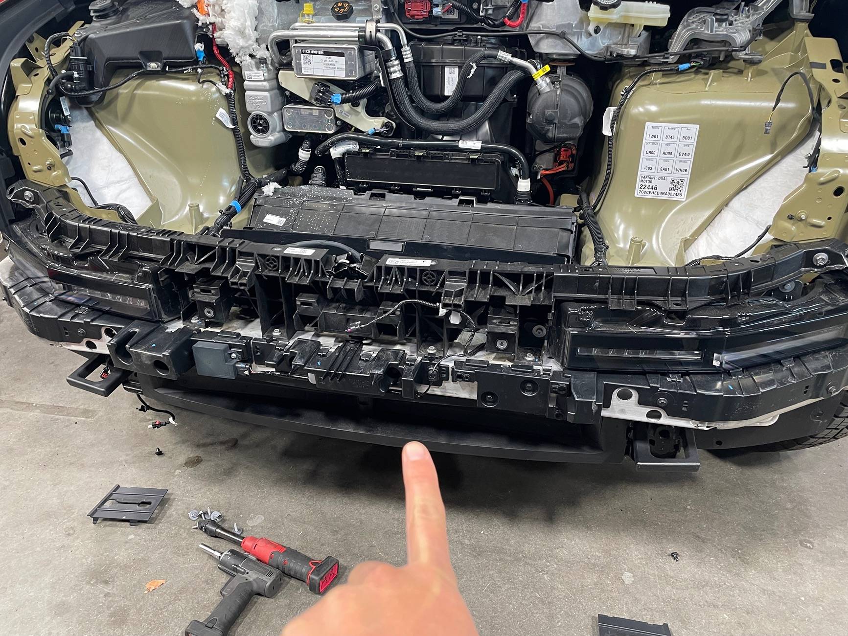

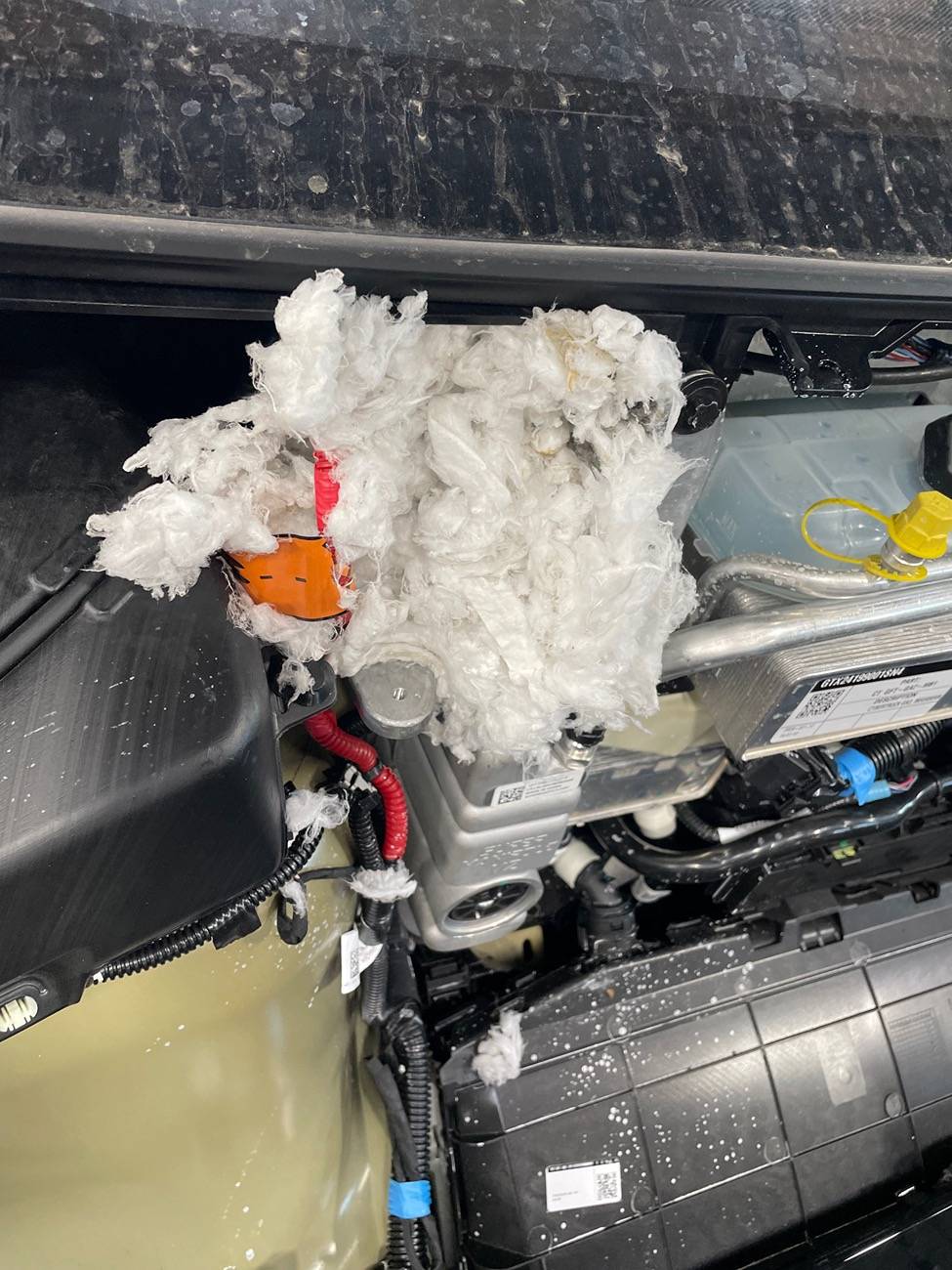

I've had rodent issues with my snowmobiles, they like to chew wires. I don't know if the scent would enter the truck cabin but I have eliminated the issue with moth balls. They do not like the scent and I have not had any issues in the last 5 years.

Why is your bumper damaged here?

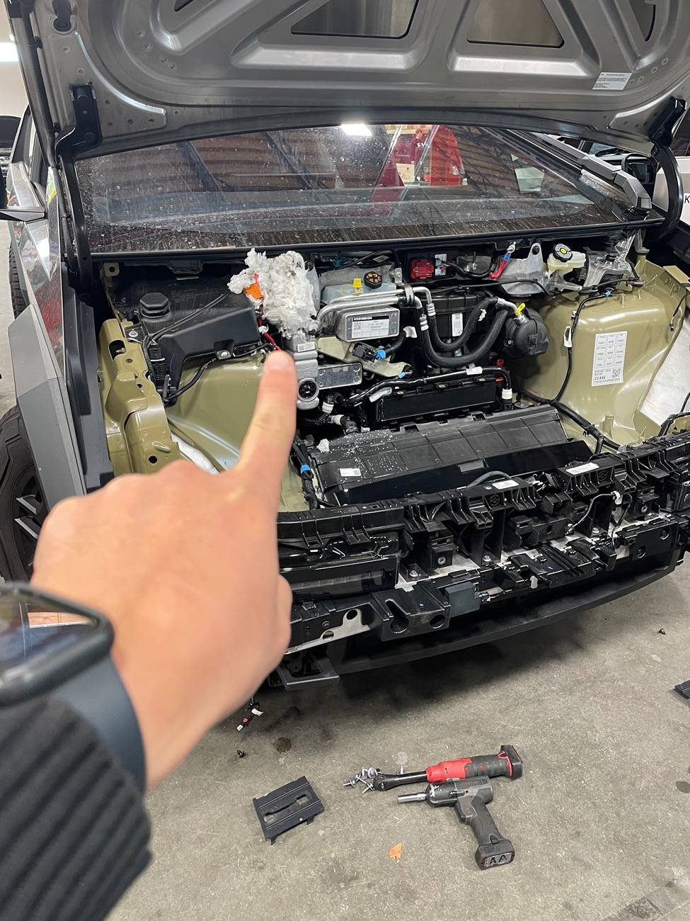

1. No food, or food wrappers in garage in or around the car (I see trash cans in your garage)
2. Keep the garage lights on overnight, all the time.
3. keep a radio on overnight. talk radio is good
4. A flashing light and sound rodent device is placed near the front of the car.
5. A gallon jug of Peppermint Spray is good to use. spray under the front of the car every night.
6. Do not bait rat traps in the garage. They attract rats and usually don't work.
7. A cat would work best. Grandpa had one but one cold night "Tommy" climbed up in the engine compartment near the fan and that was the last of "Tommy".
