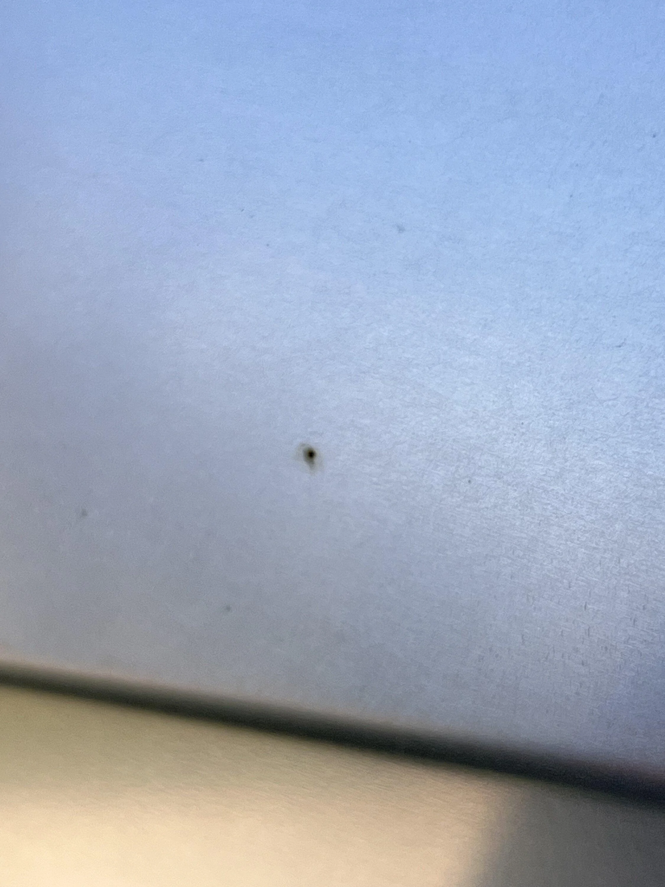

So far, looking over my panels, the rust specks are very obviously fallout from environment and/or rail dust. If you do the plastic bag trick, you can feel the bumps.
I used a clay bar and it removes the specks of iron that is still whole. All rust traces gone.

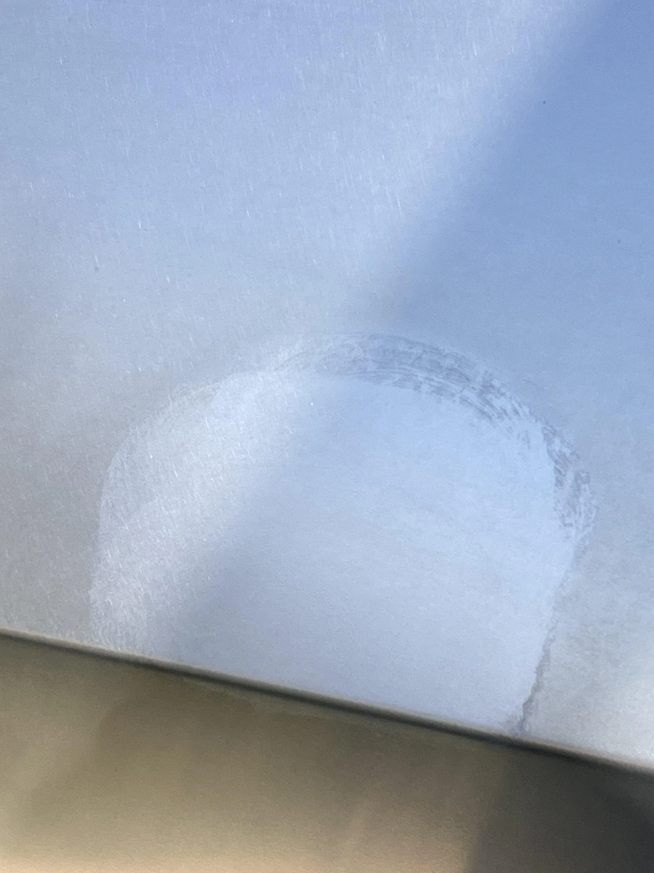

There was one spot I was testing the water spot remover. And it may have worked too well. Leaving a spot that is too clean now.
this was the worst one. But I couldn’t capture that it was visibly raised speck of iron.

Literally a couple of seconds with Water spot remover. And went to grab the windex to wipe off and it was too clean. Which meant I had to polish the rest of the panel.

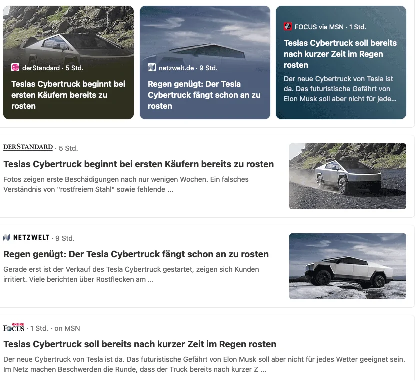

Thanks to this thread, news outlets have already picked up on the images to troll CT. They were in such a rush to not even grammar check the title. Apparently we, cybertruck owners, are already rusting!
Don’t forget to take Windex before jumping into shower today. :ROFLMAO:
https://news.yahoo.com/cybertruck-owners-theyre-already-rusting-154649229.html
Yes, also here in Europe all big news outlets cover the story with a link to this thread.... :rolleyes:
Here are some examples: Austrian "derStandard" and some German outlets:
Tesla Cybertruck Rust Spots/Corrosion is the Norm Bildschirm­foto 2024-02-14 um 17.03.59
10,313
34,184
The Yahoo link is just a re-post of the story, which originated from "futurism.com". They host a slew of other fascinating stories, such as "Cybertruck Goes Off-Road, Wheel Snaps Off"", "Cybertruck Drivers Reveal Terrible Range Over First 10,000 Miles", "Jupiter Used To Be Flat", and "Ancient Human Artifact Was Made With Extraterrestrial Material". :rolleyes:

Look at the water spot remover's ingredients. If it contains ammonia it may have removed the stainless steel's protective passivation layer of chromium oxide in that area. I would avoid any treatment that contains ammonia.
