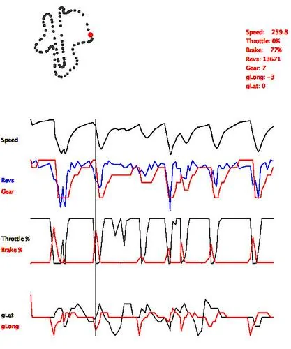

In the FPV drone world we live with 400Hz control loops (input commands are 400times a second/2.5ms) and accordingly they are nigh in-perceivable, despite also going through a radio transmitter and receiver as well as two controllers, an autopilot to translate etc. Measured control loop latencies are under 10ms in good systems, to the point that the video transmission of pictures back to the googles produces more latency, even though it's only 1-2 video frames out.
That's also why until more recently, most FPV was flown with analog video, that is essentially "phased locked loop" between the transmitter and receiver, meaning that the oscillation of the signal being transmitted was at the same time the receiver was getting it, and you had the least possible delay between light entering analog camera and exiting the analog screen in the googles. Even now the best digital transmission systems add another frame or so in latency because of digital processing inbetween, even though they are now running custom IC's dedicated to reduce latency. But that extra resolution and interference immunity is more beneficial than loosing an extra frame in time, so together with the lowered prices over the years is becoming more popular.
Here is a good reaction speed test to see how "low latency" 2 digit ms control latency is in comparison to our own reaction times. (Spoiler: we are an order of magnitude worse)
https://humanbenchmark.com/tests/reactiontime
Another thing to mention here is that humans also have "predictive" capabilities that can be learnt. This means that even though the control system has latency, a person can steer etc ahead of time in anticipation of the event occurring, instead of during the event, to compensate for the latency in the control. This is why professional drivers can reduce lap times by out-braking others on the track, in that they can accurately predict where to start braking at the maximum rate before a corner to get to the corner entry speed, despite the vehicle not being able to accurately track the control input because of vehicle physics and inertia. Doing so means that you spend the least amount of time braking, and spend a higher percentage of time on the track at a higher speed, resulting in a higher average speed overall and the shortest lap times. (Sorry but this isn't really a skill they use much in the Indy500 on a loop!) Funnily enough, like on a PC racing simulator using a keyboard, you can be pretty fast around a track with just a digital on/off switch for accelerator and braking, if you train that technique. Have a look at how steep the throttle/brake graph is here, in comparison to speed and acceleration forces that result. They are always going from maximum acceleration to maximum deceleration of available traction.

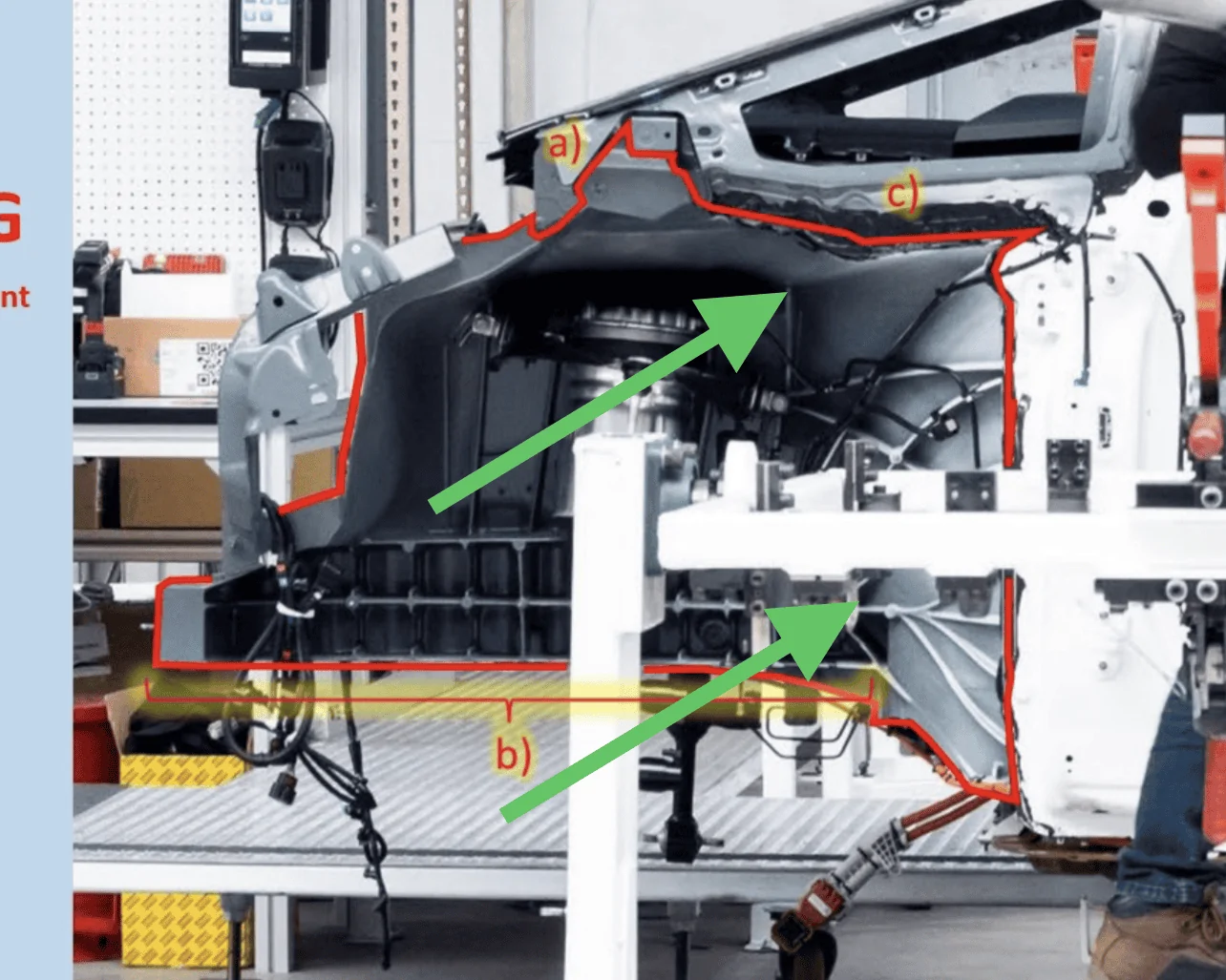

The above shows front and rear cast and cabin frame, probably without the structural battery underneath. Now if you add to that every "moving" stainless panel to the frame, being the doors and frunk, and then the top glass windscreen and the rear windscreen, and the structural battery from underneath, you will end up with only the four quarter fenders missing, one on each corner that are actually still made of the stainless steel skin.
The components in that BIW structure will support most of the load by itself without any skin attached however, only the fender quarter panels are stationary, and can actually be rigidly be attached so that they could carry a load together with the BIW. That is "if" there was a load at that point they could carry, as per the crane example.
So lets explore where the loads originate in comparison to the fenders, as to identify what loads, if any, could be supported by the fenders:
The front fender is external of any load, as you can see the front cast has the drive train sub-assembly points, that also supports the suspension. The fender does not offer any meaningful geometry to intercept the load from between the wheel and the frame from the suspension, to the point the suspension is not connected to the fender in any way. Note the sub assembly is attached to the frame on the inside of the suspension arms, with the airspring riser being supported into the top of the front cast recess, that is located directly underneath the a-pillar of the cabin frame and windscreen. (which you can see in the second picture below)
Tesla Cybertruck Some very apparent steer-by-wire action! 1696329050237
Tesla Cybertruck Some very apparent steer-by-wire action! 1696330073022
Try to imagine from where a operational load/force can be applied to the front fender, or even harder where a force should originate from on the vehicle in it's normal state, that then needs to find a path to the suspension parts. You could lean on the fender, sit on the fender, maybe place a cement bag on the fender, and the fender would have to resist that force. But is that where you would load the CT? Unlikely.
You could even twist the vehicle for torsion, but those forces are only directly in between the suspension assemblies that is attached internally to the cast, cabin frame and structural battery, and as such would only influence the relative force on each wheel, through those parts, but not something that lays outside of the load path, being the fender. In the front there is little to no load to support in the vicinity of the fender, considering that the HVAC and frunk sit inside the cast frame, so would it be beneficial to have a meaningful rigid connection from the cast to distribute load through the fender? No it's not, and that is why you don't see very much in the way of connection points on the cast to connect the fender. The front fender has a bunch of other roles, (aero, wheel guard etc) but structural support is not one of them. In a failure mode, like for crash impact protection, all the skin panels play a roll as they are compressed against the BIW, so the fender is definitely doing something, so it's worth having, but it is not supporting the vehicle mass structurally.

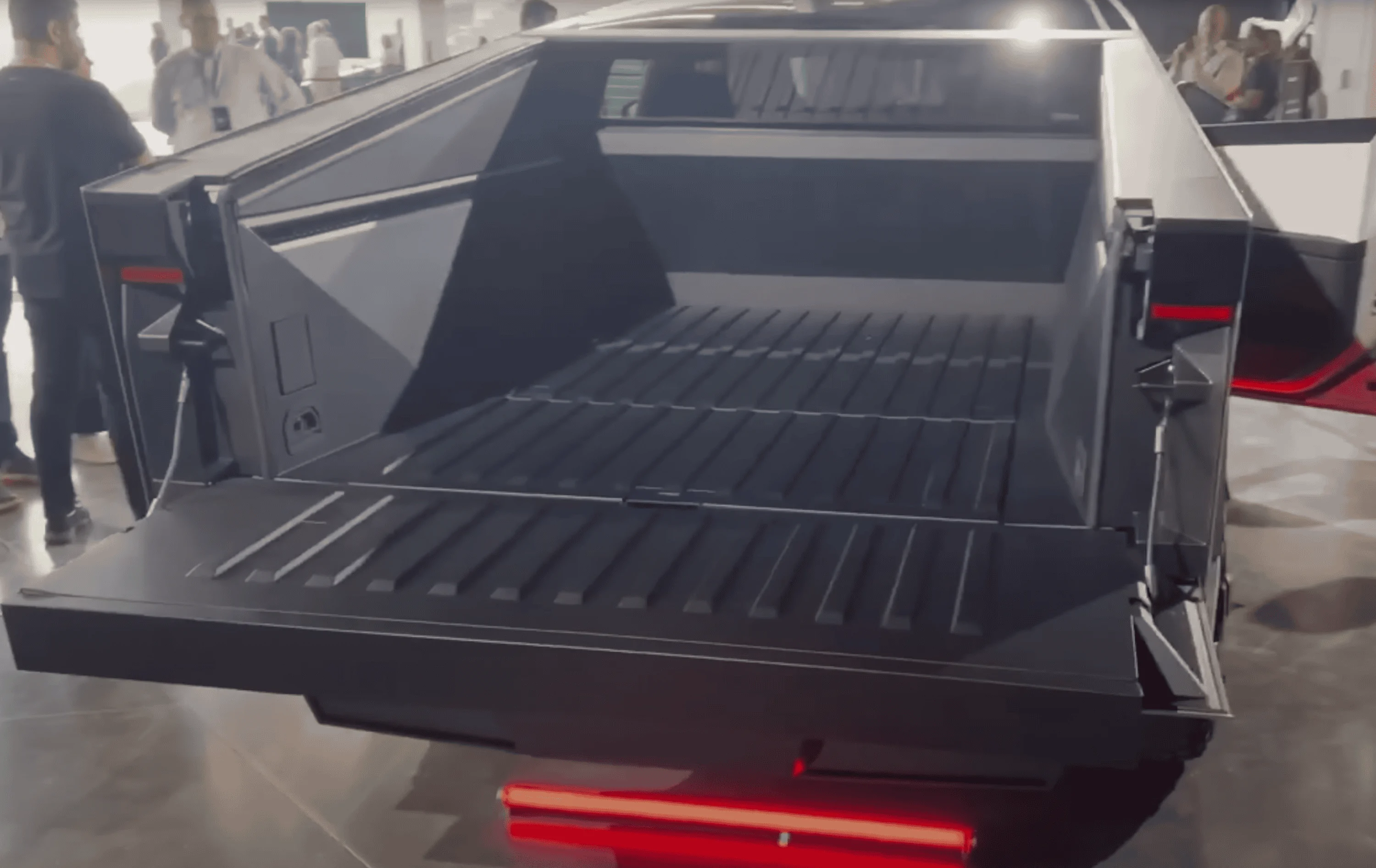

In the rear it is a little different, in that depending on where the bed is loaded there might be some addition force on the rear fender, or rear sail panel. Originally this was split to house storage behind it, but now it's likely without storage. However, as you can see in the picture below the cast structure is along the internal wall of the bed, not the external wall of the CT. As such it also doesn't have any meaningful interconnection to the skin to transfer forces through the fender. In the rear of the cast you can actually see the mounting points for the tailgate hinge and locks if you compare the two photos below.
Tesla Cybertruck Some very apparent steer-by-wire action! ertruck-body-shell-frame-reveal-giga-factory-texas
Tesla Cybertruck Some very apparent steer-by-wire action! CT Open Bed Dimensions
The skins, as are the door skins, a quite a distance from the cabin frame and casts. But once again, lets go back to where the load/force originated from, and where it has to go to to get to the wheels.
The bed itself would connected to the cast, and I think it is sitting on top of the flat spot next to the rear wheel arches, along with across the front under the bed front wall (midgate), and spanned across the rear tailgate. Like a pallet. The point here is that directly underneath those flat spots near the wheel arch, are also the suspension springs for the rear axle, where all the load from the bed must go anyway to get to the ground. So the fastest route for load in the bed to be supported by the wheels is through the suspension, the cast and then the bed that sits on the cast. The fender is not in between the load and the suspension, so no load will be transferred out to the fender, and then back into the cast and suspension down to the wheel. (Once again like the crane example above)
Now in torsion, we have the same as with the front fender, in that the force is between the wheels only, until that time that one wheel leaves the ground, or the body of the vehicle touches the ground by over compressing the suspension or being wedged by the ground. Once again the load is inside of the lifting arm, and the fender plays no role until the outside of the vehicle touches the ground which will result in damage of the vehicle like any other vehicle.
In fact this highlights another reason "not" to connect the quarter panels to the casts to structurally transfer load, and that is that the stainless steel skin sheet is fairly two dimensional, in that it barely has any depth in it's geometry, unlike a stressed skin aircraft fuselage that is fully circular, the CT skin is just a flat plane. This means that "if" a load was put on it unevenly, it's likely that it would result in enough twisting of the skin, that you could visibly see it in the reflective surface of the CT.

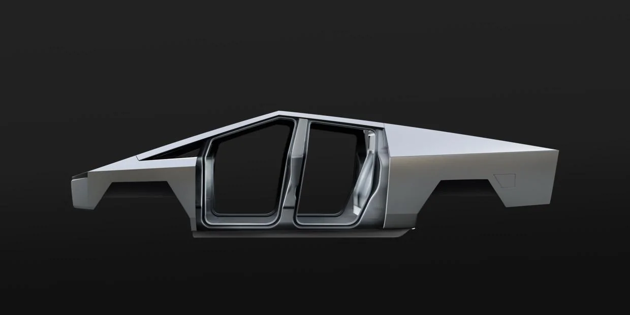

There is no evidence the design has changed. The render they shared on reveal night has the same cabin structure we're seeing on current Cybertrucks:
Tesla Cybertruck Some very apparent steer-by-wire action! {filename}
That image shows no front and rear casts whatsoever, nor any definition of a structural battery pack, both of which do more than any skin surface on the vehicle.
It's just a placeholder to show the "intent" of the design, and it's form, but in no way indicates if the exterior is structural or not.
As for changes, we know it's not the same length, not the same angles etc, so yes it has changed.
To the better as far as I can tell. ;)
