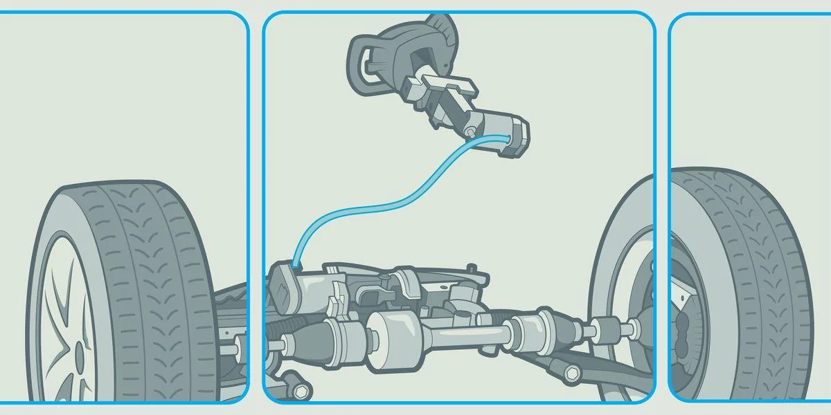

How Toyota Is Making the Case for Steer-By-Wire
Soon, the Lexus RZ450e will be the first car sold in America without a shaft connecting the steering wheel and the front wheels.
BY CHRIS PERKINS PUBLISHED: MAR 17, 2023
American customers will get their chance to try Toyota’s steer-by-wire system in the Lexus RZ450e electric crossover, with the option set to become available in the next few years.
There’s nothing in the Federal Motor Vehicle Safety Standards that defines minimum performance parameters for steering systems in cars sold in the U.S. Just standards regarding the crash safety of conventional steering systems. That said, the National Highway Traffic Safety Agency (NHTSA) published a study in August 2018 on steer-by-wire systems, their potential failure modes, and fail-safes/backups, seemingly with an eye towards implementing new standards. UN regulations detail all sorts of performance parameters, and Lexus says they'll meet these, plus any additional regional requirements where the system is offered.
