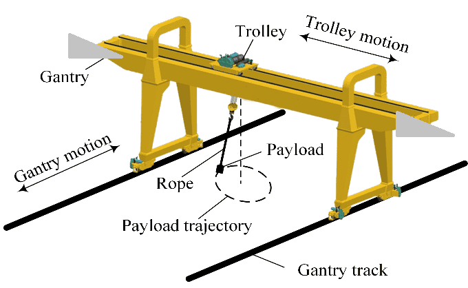

In reality, if looking from the rear, the CT line diagram is more like a gantry crane like the below, with the two towers, being the suspension spring towers of the rear axle, and the fenders being mounted outside of the towers as depicted by the grey triangles. Remember, like the front, the load in the bed is between the towers, not on the outside of it, so unless you put something on the fenders in this diagram, there would be no load transferred to the towers from them.
Tesla Cybertruck Some very apparent steer-by-wire action! Motions-of-the-3D-gantry-crane-and-payload
Now there is a possibility to use the fenders for stiffening torsional loads in the bed area, by allowing it to take load when the cast deforms. But the bending modulus of different materials also plays a roll, in that unless you carefully calibrated the aluminium cast to match the deforming characteristics of the stainless steel fender, you would experience material fatigue through load cycles, resulting in fractures of the cast or the stainless. Depending on which moved more in relation to the other under load. The easiest way to deal with this is to ignore routing loads into the fender by mounting it on rubber bushes.
Let alone trying to match up the different material thermal expansion rates which would create forces beyond those of the loads being put into the bed. (Alu is 21-24, whilst SS is exactly 17.3)
This is why they have soft bushes between different parts of the car, as the exterior heats and cools differently from the interior, and those result in length changes that need to compensated for in a soft material.
This is similar to a bitmetal thermostat, where each layer of material would expand differently. (btw this is also why you can't use aluminium as bar rein-enforcement for concrete, and only steel, because steel and concrete have the same thermal expansion co-efficient)

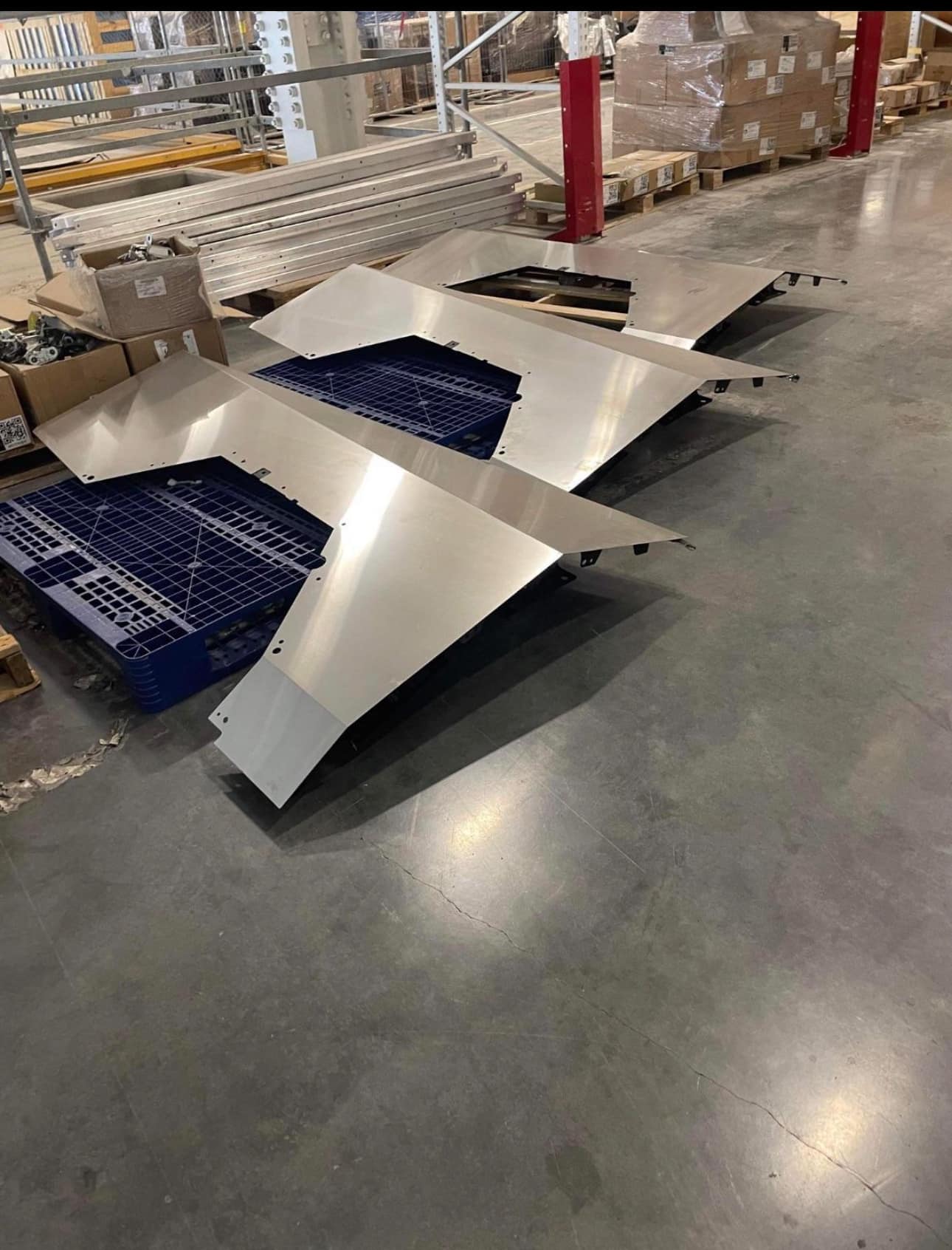

Lastly, if we look at the rear fenders pictures, it's fairly clear from the mounting brackets that they are not intended to carry bed load. You can see the black right angle plates with holes for fasteners are not in the direction of the torsional loads, and would simply bend that mounting bracket. For it to do something it would have to be attached to the rear wall of the cabin so that it can adsorb tension and compression forces across the top diagonal of the panel. Like the diagonals of the cast structure. Those little tabs won't cut it, and are instead just there to attach and adjust the panel to the BIW frame.
BTW if there were any more meaningful attachment points under the panel, then they would only be able to reach and attach to the cast, but not the cabin frame, meaning once again, the cast is supporting the panel, and not the panel the cast for any load. So there is no meaningful "exoskeleton stainless steel skin" for operational loads and this idea should be laid to rest.
Tesla Cybertruck Some very apparent steer-by-wire action! fender quarter panels
I’m not sure about that last bit?
Pretty sure rear QPs overlap the cabin frame
As for the attachment tabs seen: don’t you think they’re filling all the void between SS and casting with an adhesive foam or something?
At least, they’ve got to be somehow separating the SS panel from reacting with the Al casting
