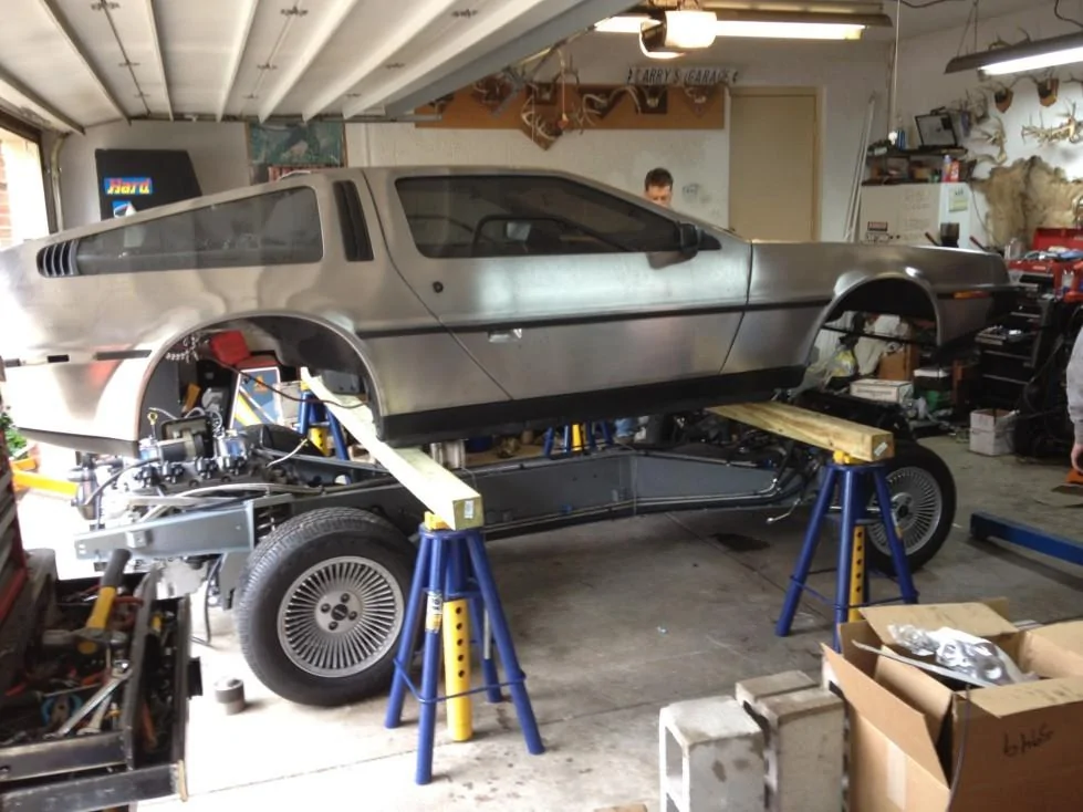

I'm not a ChemE either, but there is 40 years of history for stainless-steel vehicles. They've been in every climate, all sorts of weather, even pulled from a lake, and the stainless is the least of their problems.
A few DeLoreans have rusted out due to salted roads, BUT it was only the frame under the fibreglass shell which is plain old steel, epoxy-coated. Even when those were corroded beyond repair, the exterior stainless was still in good shape. I've never heard of a DeLorean panel needing to be replaced due to corrosion.

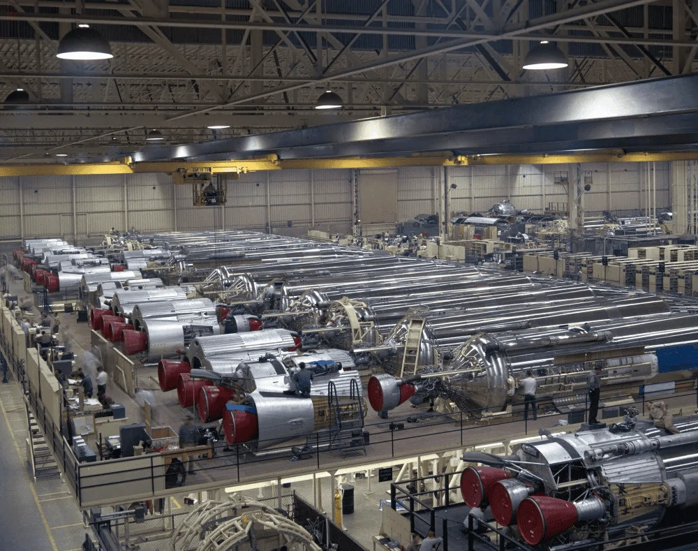

Early Atlas begs to differ.
The Centaur upper stages are also made of a type of stainless.
It shows up in alot of the earlier or long-lived designs but due to its cost and wight at the time fell out of use. Stainless steel is the miracle material of the 20th century.
