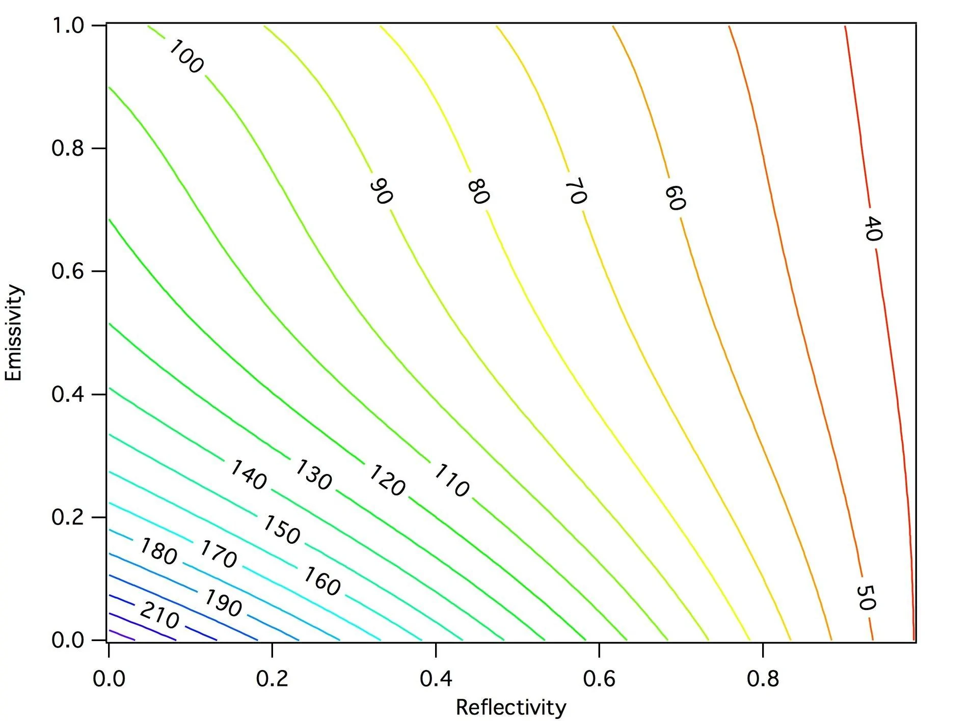

It's all well and good to talk about the theory and give one's opionions as to what will happen in a particular set of circumstances but of course we don't know what the emissivity or reflectivity are going to be for the metal used to surface the CT. Also keep in mind that radiation isn't the only way the skin can cool. Convection will cool it as surely as IR emission will. Here's a plot based on models used by the construction industry used to calculate the temperature of roofing materials to asses their suitability.
Tesla Cybertruck CyberTruck SS Heat NoWind
The numbers on the curves are estimates of the surface temperature (°C) of materials exposed to sunlight as a function of the materials reflectivity and emissivity in the absence of any air movement.. As we have stated throughout shiny and emissive materials will stay the coolest. What the curves show is the dramatic decrease in temperature as the reflectivity increases for a given emissivity. Thus polishing stainless dramatically reduces its temperature in sun. OTOH for highly reflective materials higher emissivity doesn't effect surface temperature so dramtically but for materials with low reflectivity it does. I'd say the ouchless region is the region to the right of the 50 °C curve.

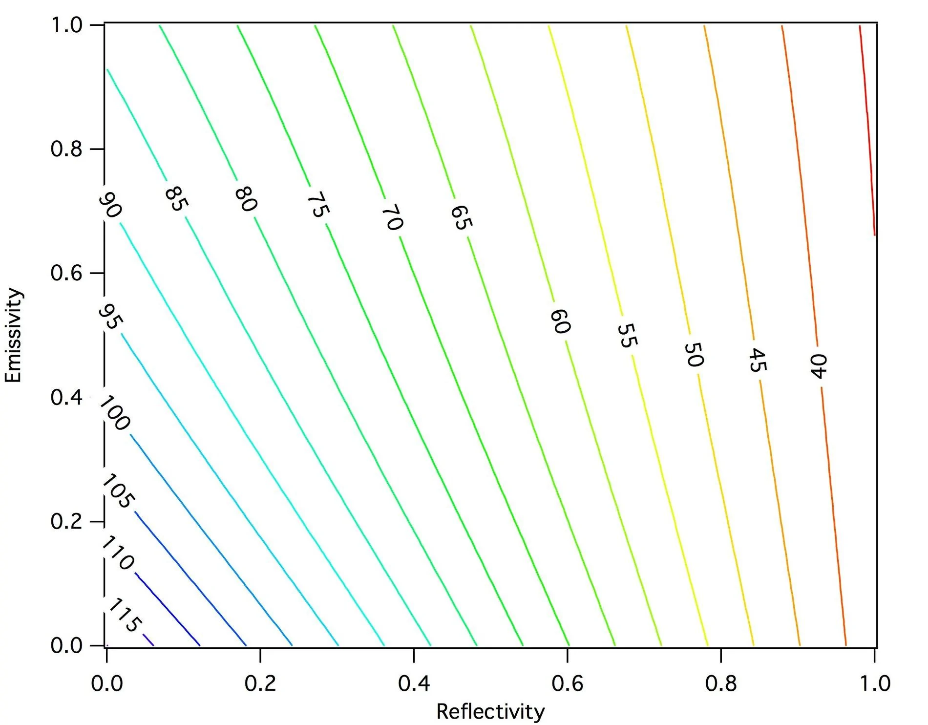

This next curve shows the effect of winds in the range of 4 - 13 mph. The ouchless range is obviously larger.
Tesla Cybertruck CyberTruck SS Heat 4to13Mph
