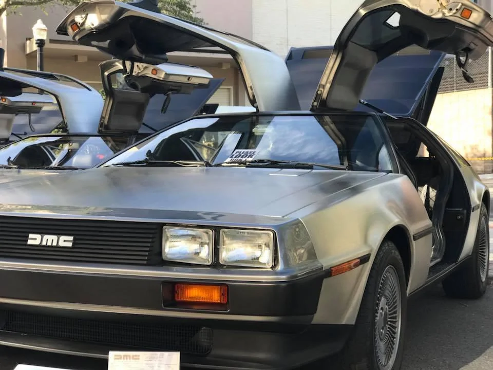

I have per-ordered a Cyber Truck and I got thinking about the stainless steel Tesla is going to use which was described as similar to the materials used in cooking pans. If so, I imagine the body of the Cyber Truck is going to get too hot to touch after spending time in the summer sun. This could be a major safety issue if my perception is correct. Did the DeLorean get too hot to touch in the summer? Does anyone know? Your thoughts?
I know the OP's post is from a year ago, but I'll weigh in:
Yes, it does. I have a sign that I place on my DeLorean's windshield at shows that states " Please look, don't touch". It is more than a reminder to use common courtesy or to avoid fingerprints. It is a warning. Bare stainless steel in the summer sun can burn skin. I am never far away from my car but routinely see people touching or leaning against the car (usually for a photo op) and invariably retract their body part like they touched a hot stove. I pay particular attention to children around the car to ensure their parents are aware of the situation.
It will be the same situation for the Cybertruck, although the height of the vehicle will preclude anyone laying their tender forearm on the roof to lean in for a photo. I'll probably carry the same sign for the CT.

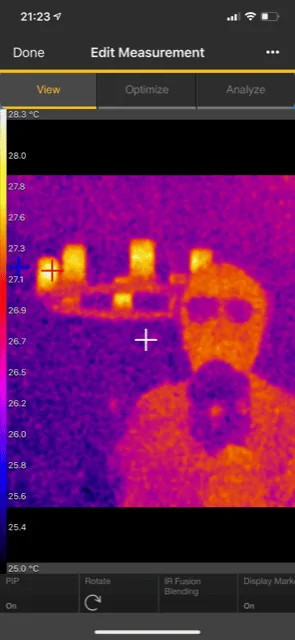

Glass doesn't transmit IR very well.
Tesla Cybertruck Stainless Steel in Hot Sun IMG_1323_IR
This is a picture of me or rather my reflection in a sheet of glass. I am standing in front of a full length glass door and the camera is pointing at the door. What you can't see in the pic is my SO who is on the other side of the glass. IR from her is blocked by the glass.
What heats the interior of a car is visible light and NIR which get converted to heat which is reradiated as long wave IR which can't get out through the glass. This is greenhouse effect. thua it is visible and NIR you want to block. It is also important to block UV to prevent deterioration of the internal furnishings of the car (and your skin when you are in it).

The Infra-red spectrum would definitely heat your scalp if allowed to pass through. All of these wavelengths will be converted into heat when absorbed by the object they are striking.

Well yes but the infa-red can't come through. Glass won't pass it. That's what the picture shows.
