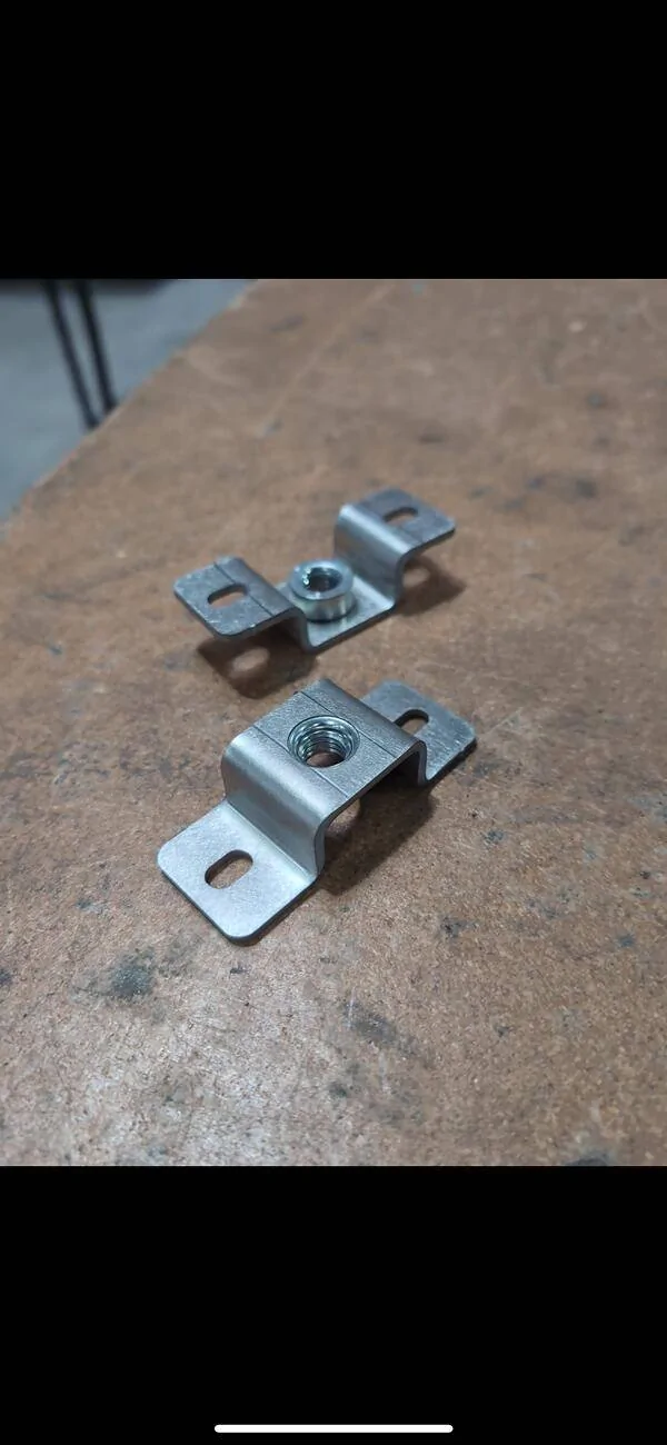

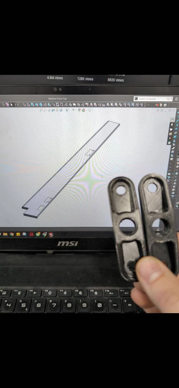

Reached out to Jasper today.. got a couple updates…
working on a multifunction bracket which can hold the sail panels down but also be used as an attachment point for a future stainless steel roof rack/ crossbar…
first he started with a 3d printed version that was ultimately gonna be machined out of solid aluminum or steel. This adds a layer of complexity so he decided to see what he could fabricate in house… I think the result is both elegant and simple.

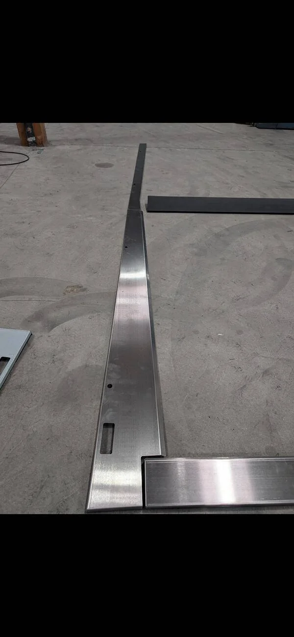

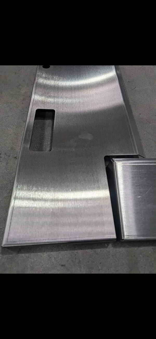

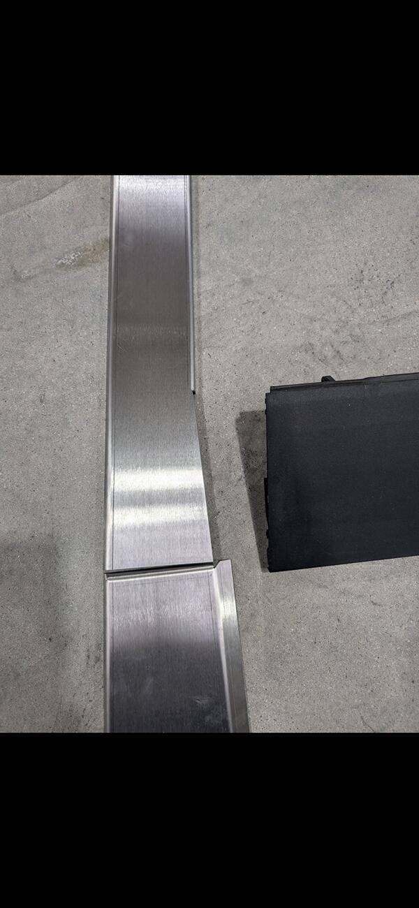

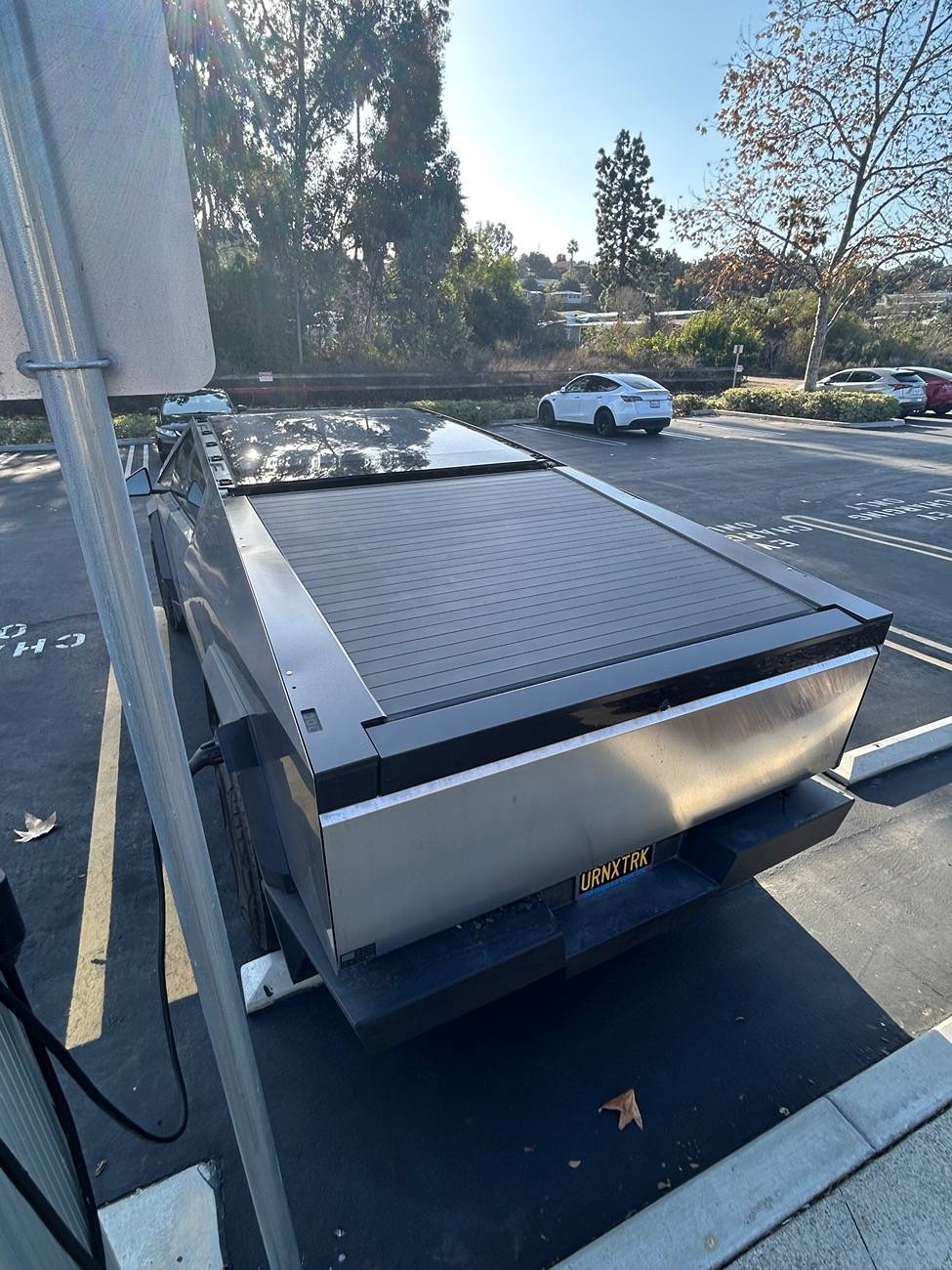

Produced the first stainless version of the tailgate cap and upper and lower sail panels. So far only has the driver side completed. Upper sail panel will bridge over the roller tonneau cross panel to give the sail panels a continuous look. This was something we talked about at our last visit and will need a final check to prove out the concept… I probably will end up running this set on my truck as my forever version but I could see a final round of revisions based on how these fit.
Gonna be epic!

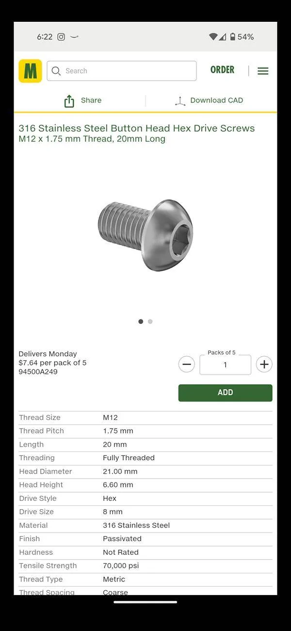

For those asking about attachment hardware he’s starting with these button head hex nuts. Not a crowd favorite, I’m sure someone here will source something better down the road, me personally, not offended….
