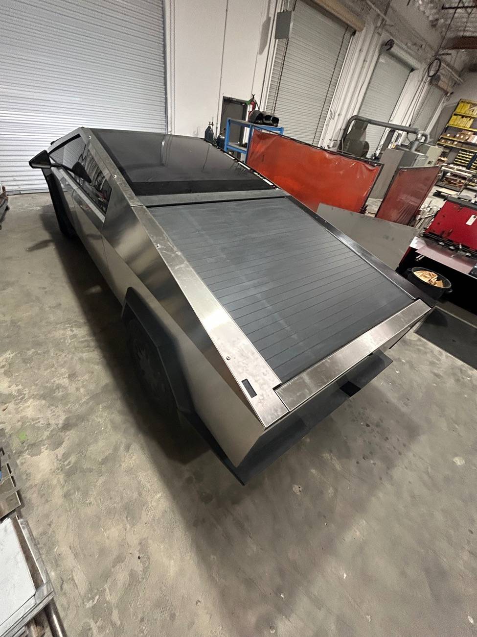

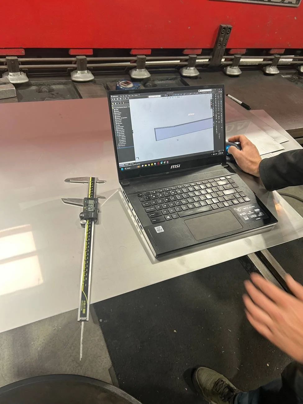

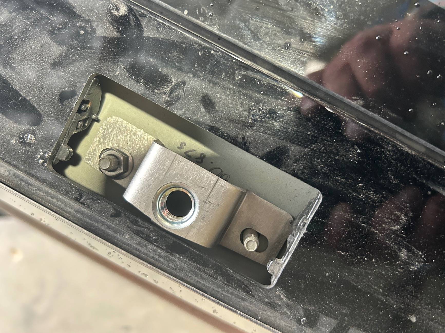

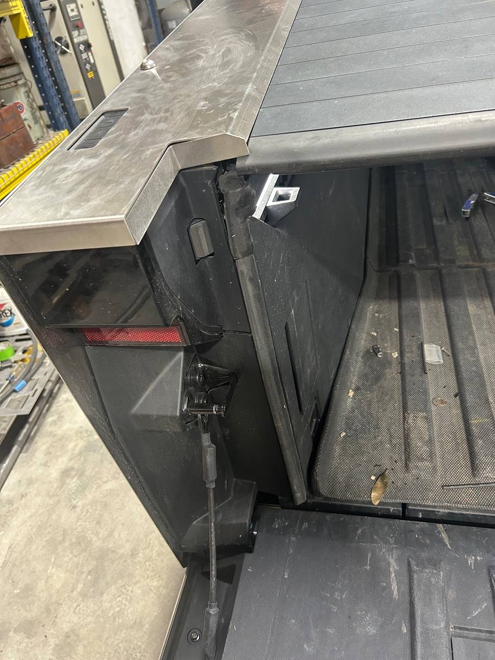

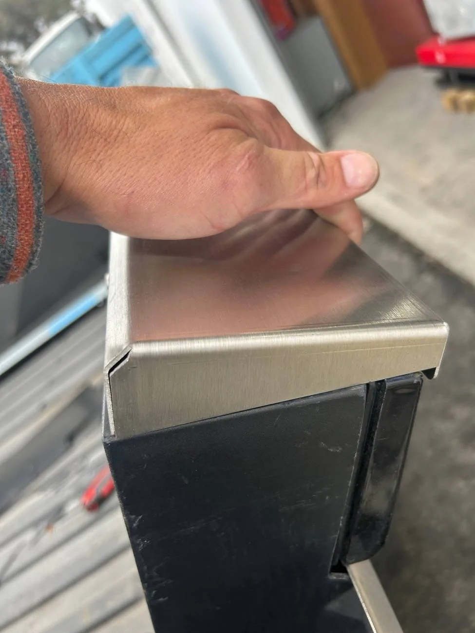

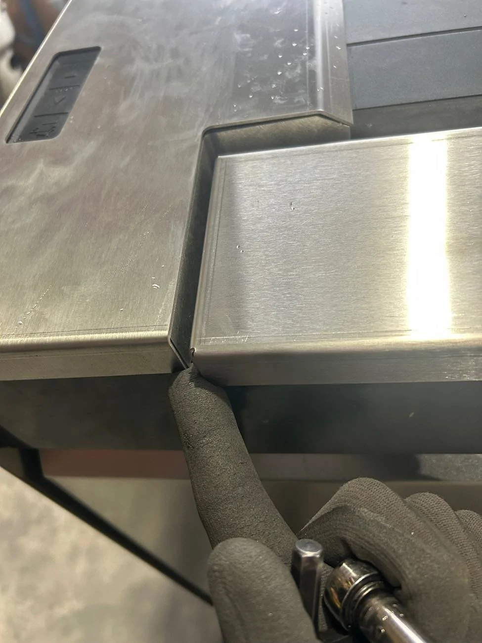

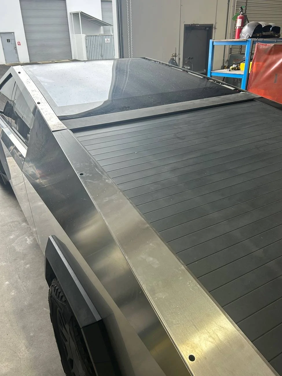

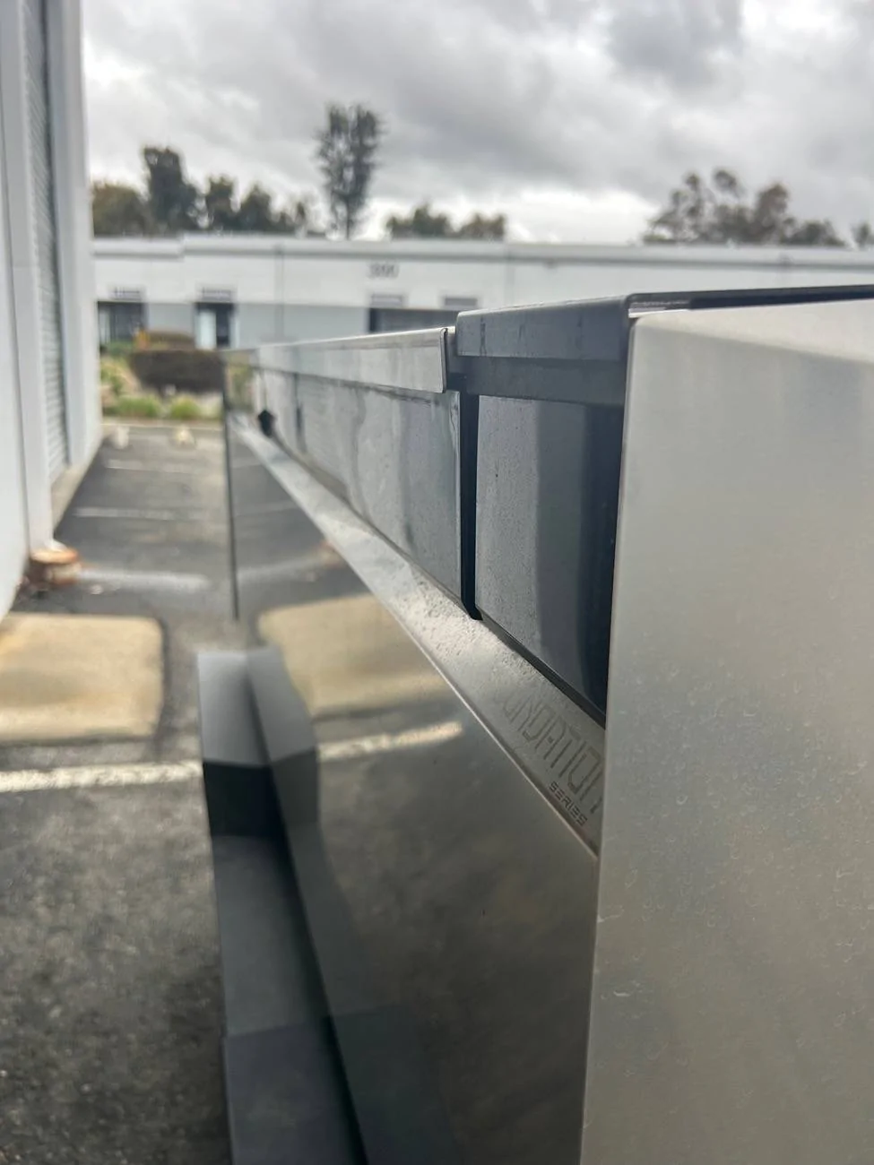

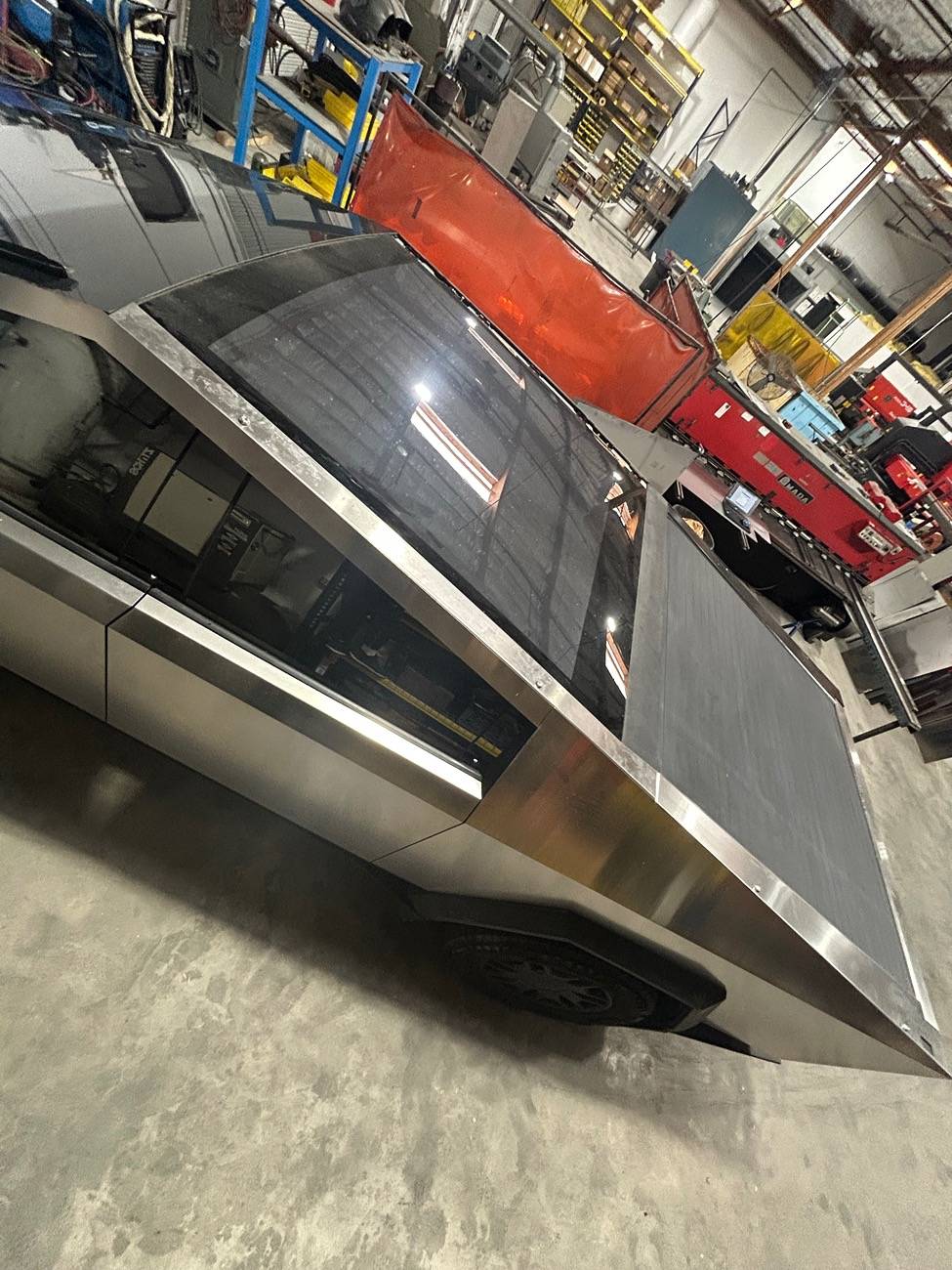

Ok Y’all. Today was the last prototype fitting session! Things are looking great! The tailgate cover is dialed in. The sail panels are perfect. The only adjustment is to the upper 2 sail panels which need to be extended about 1/4 inch to butt up to the lower sail panel and a few other edge details. Jasper says if you’re wanting a set he is ready to start taking deposits to order material. From deposit to delivery should be 4-6 weeks. The attachment nuts are still a point of discussion. The latest version is bigger and bulkier than the last type that nobody liked but the ultimate plan is to have a robust attachment for stainless crossbars. Jasper may switch to a flat head with a bevel to achieve a more flush mount look. He’s going to comb through the McMaster Carr catalog… Here’s a bunch of pictures!!!

No seam welding has been done in any of these pictures but rest assured every corner will have a clean tig weld if there is a gap or corner to be sealed.

Love the bevel on the inner lip of the tailgate cap. Makes it nice and rigid and allows plywood etc to slide in easily.
