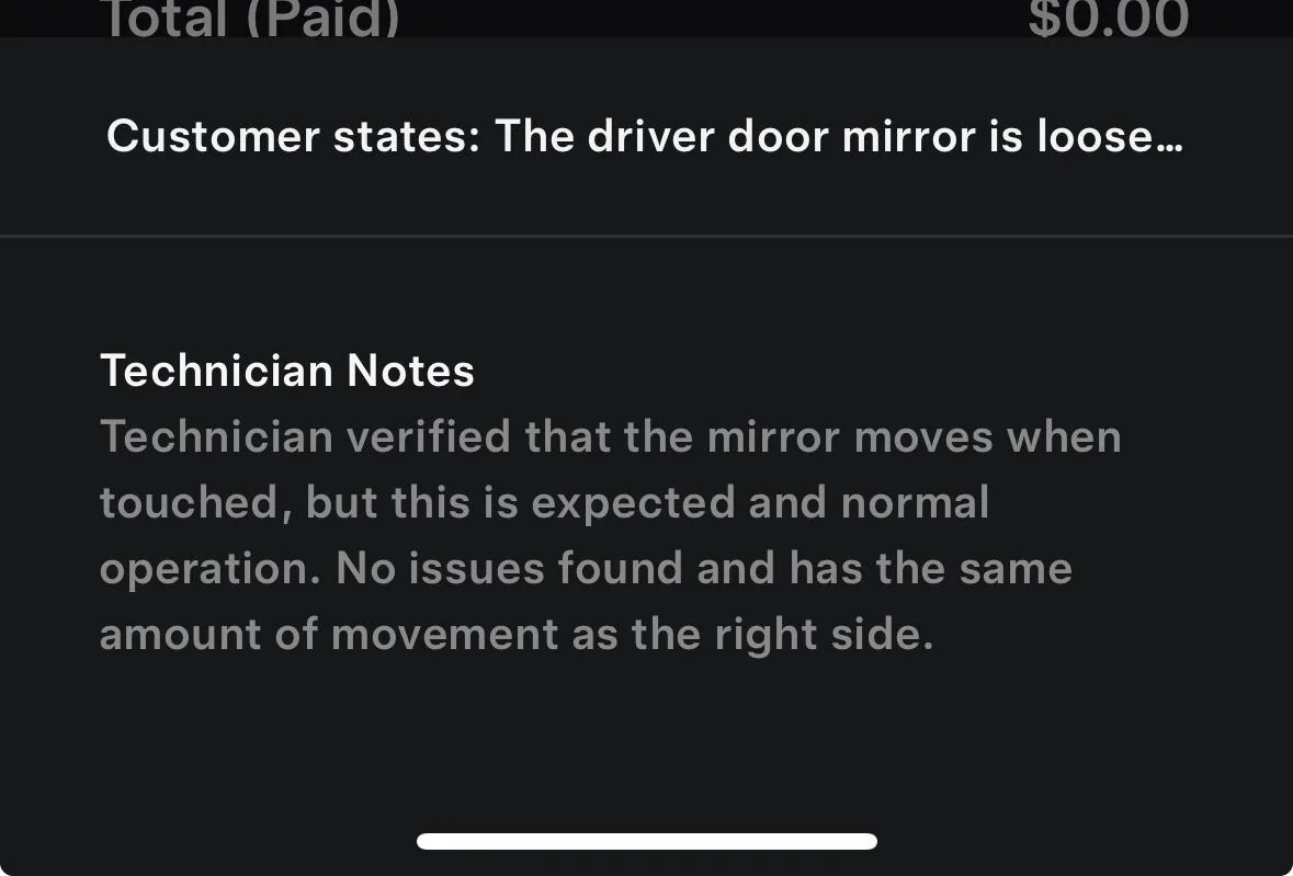

Just got mine back from SC here is what they said.
Tesla Cybertruck Side mirror shaking IMG_2042
