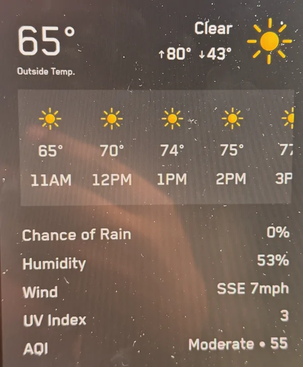

Both of my front doors have been replaced due to this issue in the past and then they got the new sealant in and ended up doing the bulletin (SB-25-10-002) two months ago. It was fine for a few months but now the driver's door and side mirror is shaking again. Anyone else dealing with the same issue? I was told that a new revision for the actual doors was coming soon by the service manager but that was a few months ago.
Video of mirror and pic of wind speed on day of below:
7mph winds
