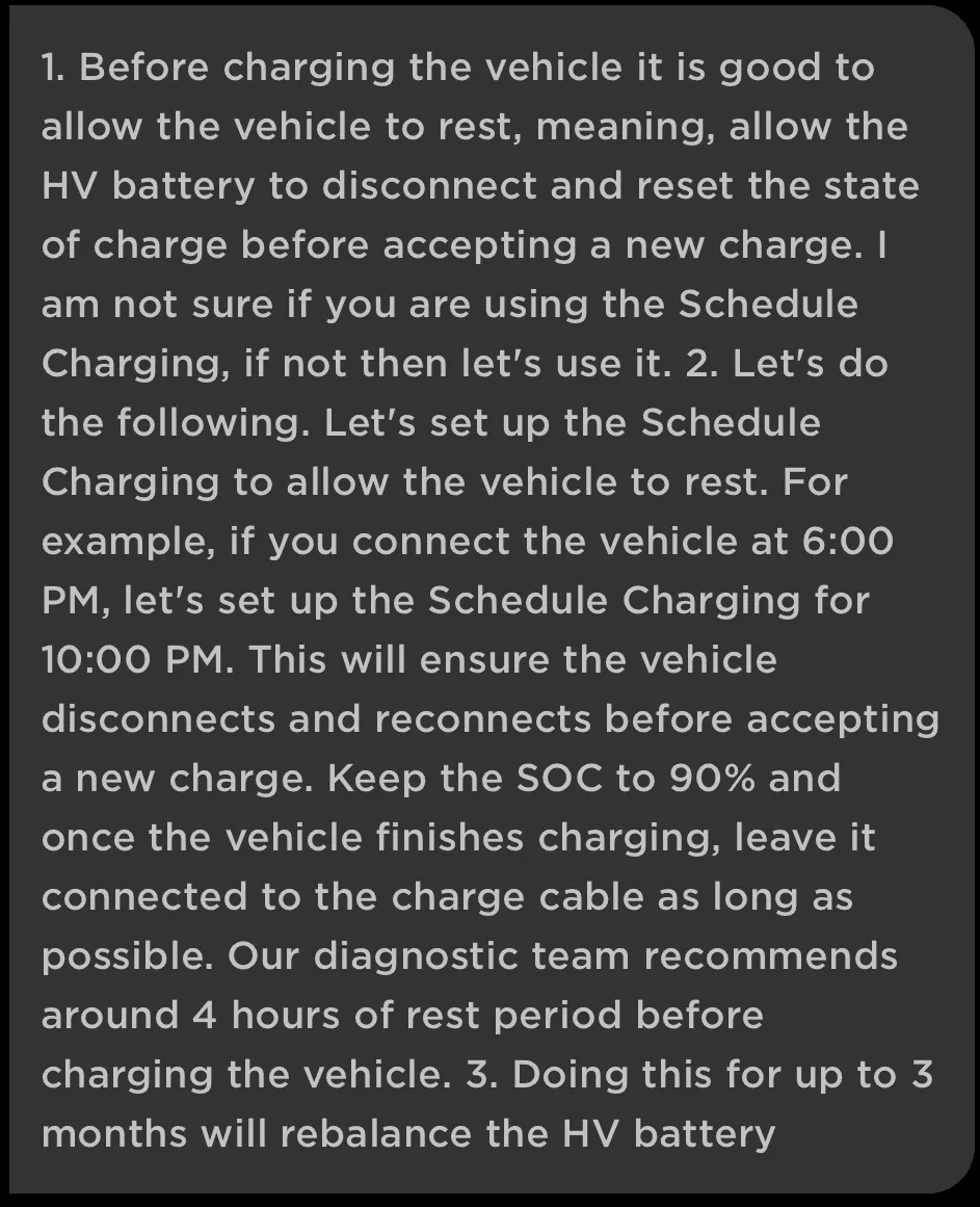

So Tesla said to do the following:

I have seen some other procedures but sticking to Tesla recommended for now. How did you calibrate your battery?
The technician from the local service center told me about how to calibrate your battery back in 2019. Frugal Tesla Guy put out a terrific series recently about Tesla's batteries. Check out the video on how to do it. It didn't seem to make a difference for him but give it a try. It worked for me.

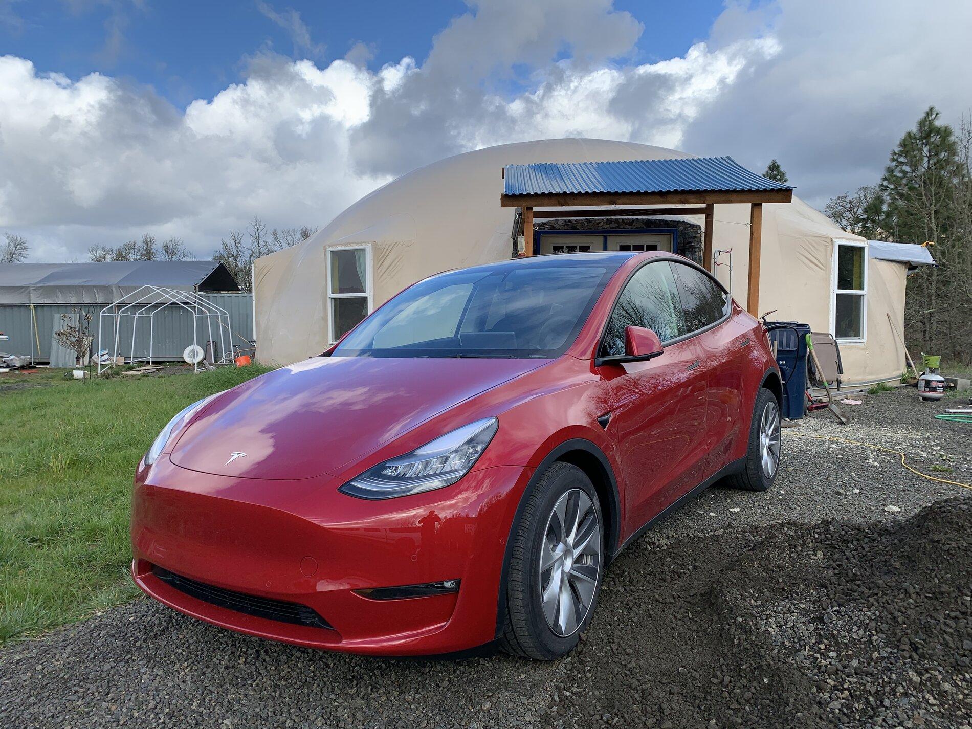

My house is... different. (Also my yard is a disaster right now!)
Tesla Cybertruck tax credit for the cybertruck 1628700282428
Dryer outlet is inside the back door, I'd have to cozy right up to the rear of the house and leave the door propped open.
220v is going to be outside on my other driveway, but going to have to wait for at least a month or two when I'll get the carport thing covered again and the ground is soft enough to trench.
