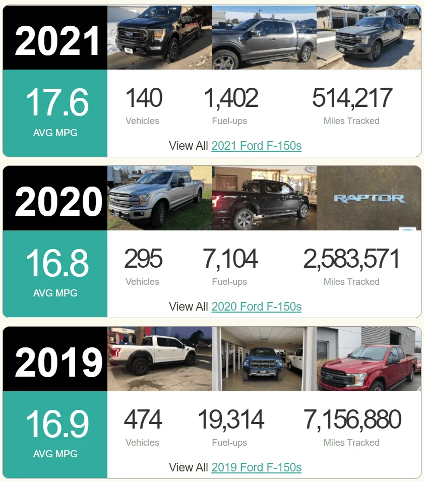

I just took a look at fuelly.com to see what the average F-150 is getting for fuel mileage. The numbers below are for ALL F-150 models, V6 and V8, as well as all cab and bed styles.
A V8, 4x4, crewcab is lucky to average 15 mpg.
Exactly. So comparing a hybrid sedan fuel economy when discussing trucks is not showing the true cost savings.
I use fuelly for my Ridgeline. The real world cost savings on the last three years of gas for actual mileage, if the suggested cost of charging a cyber truck is similar to what friends who own Tesla cars say it costs.. i am saving 3-5k over the same mileage on 3 years of ownership, or approximately $1100/yr at current prices. Prices will only go up. Good enough for me, especially given the cost of gas will only get more expensive.
