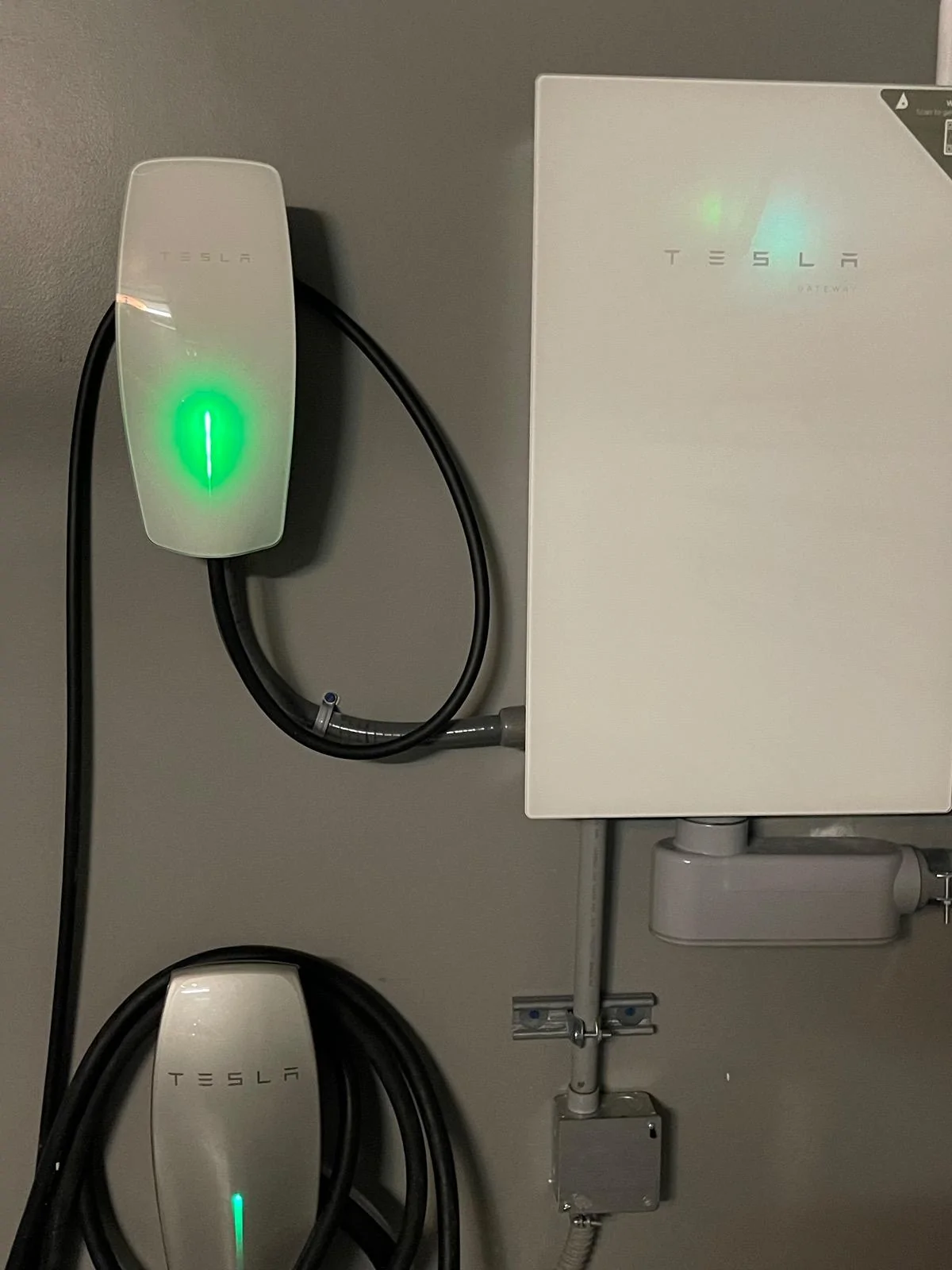

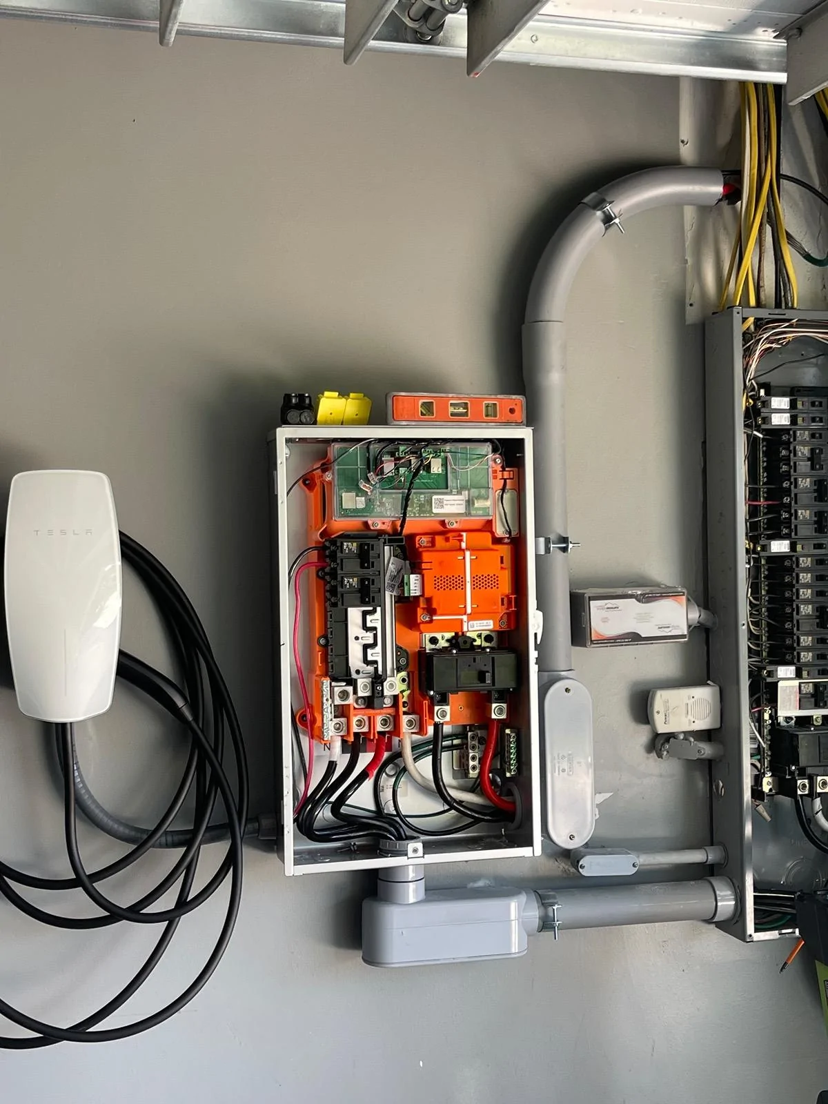

Mine was about 5000 all in, that’s in Naples Florida.
