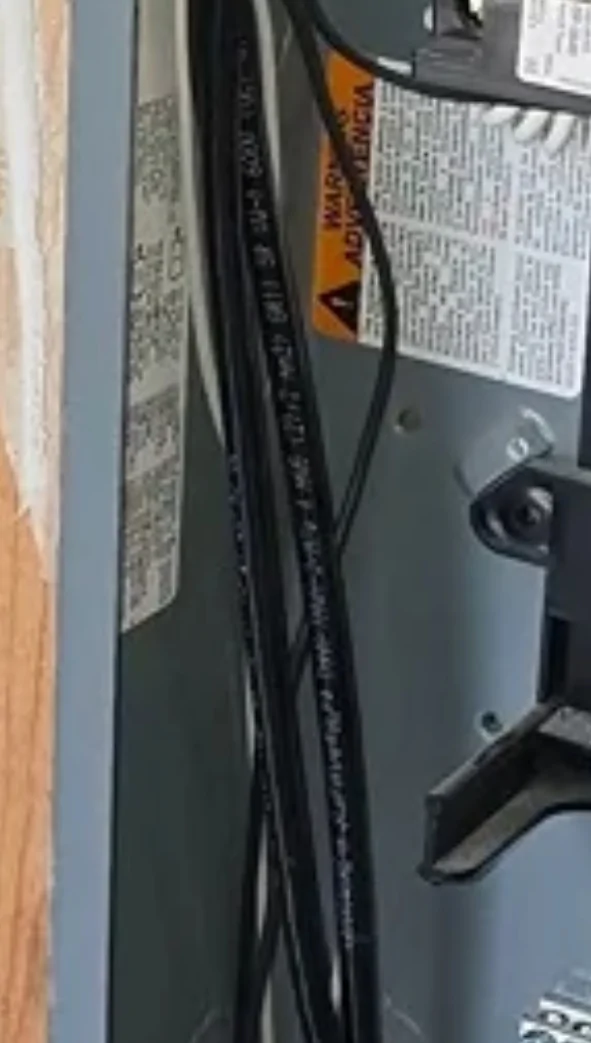

OK, I finally got around to pulling the front panel off and taking some pictures of the charger wiring to the breaker.
The first picture is the breaker and the wires.
The second picture is the panel to the charger.
The large cable coming through the wall at the bottom is the main power line coming into the house.

That is a bizarro Wall Connector positioning (so close to the adjacent wall and down low).

It's fine in use. Actually, it's several feet off the floor. I think about waist high.

Yep, definitely not 12 gauge. Can't quite read the printing, but looks like 4 or 6 either of which would be fine

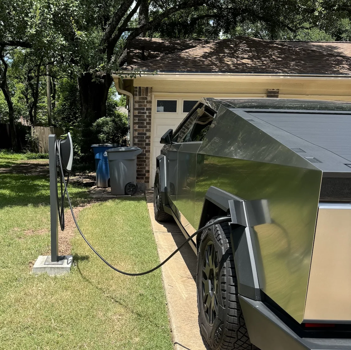

I knew I would be charging outside, because the garage is where I store all my worthless crap. Since I didn't want to back-in to park, and needed charging to be convenient enough to use daily, I bought the Tesla UWC Pedestal which I had mounted on a concrete pad:
Tesla Cybertruck The Cost of Installing a Level II Charger at Home uwc charge pedestal
The subterranean conduit runs to the corner of the house, then along the side to the main panel at the back.
This cost me about $1000, but was part of a $8k+ package that included the PowerShare 3V gateway, as well as replacing my vintage electrical service panel all the way back to the pole.

Any trepidation about having your charger/cable out on the street? I live in a nice neighborhood but still feel a little weird installing my charger outside. Maybe im being weird? There is a video on youtube where the guy comes out of his house and finds a lady charging her ev. He's telling her it's private property and she argues that she needs a charge and he has to force her out
It's true, probably anyone could pull in to my driveway and help themselves to a cup of electricity. But if a fellow EV traveler needs a charge that badly, I'm happy to help.
If I were concerned about an ongoing theft, the UWC can be configured to permit authorized vehicles only.
