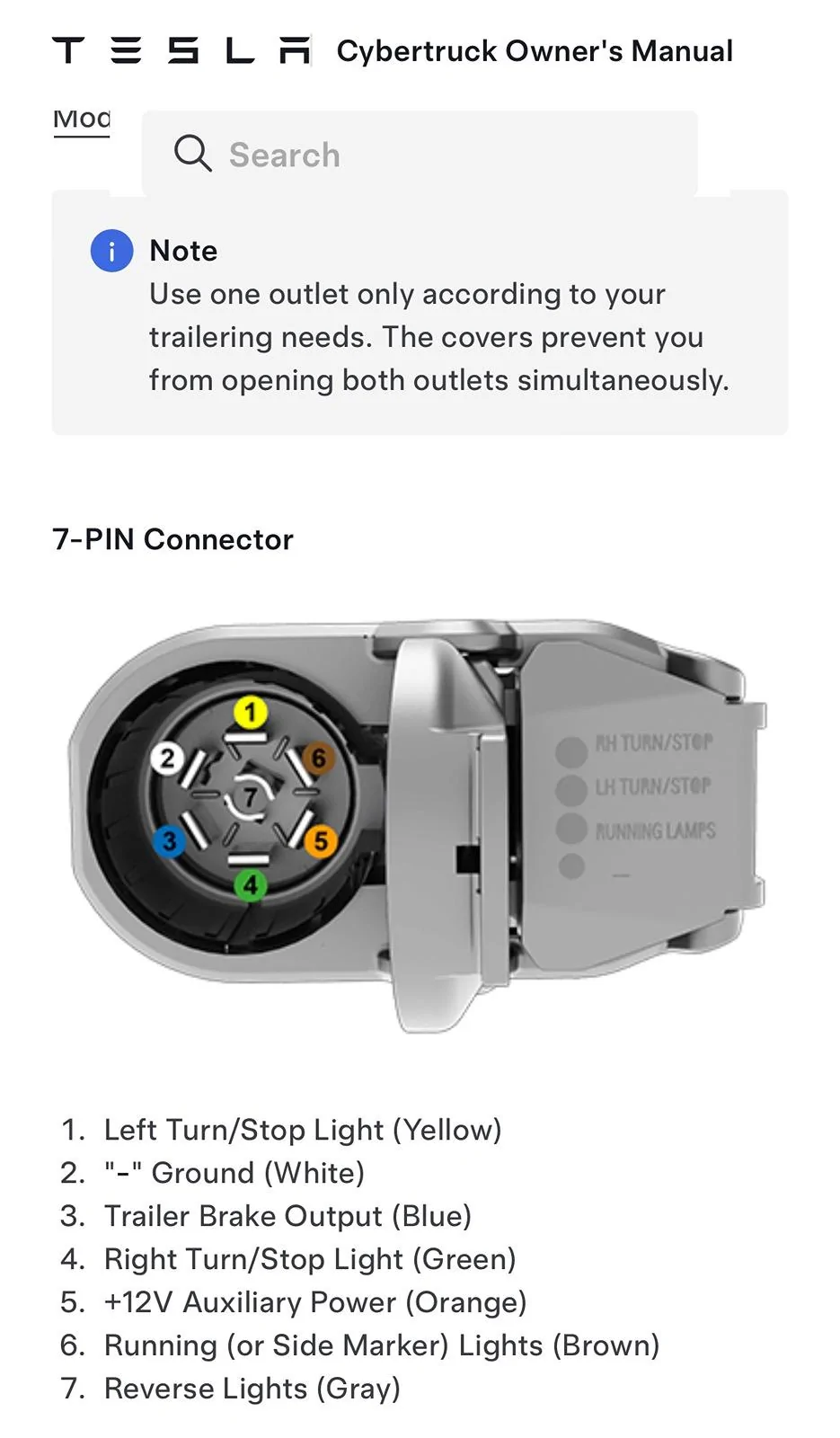

FWIW, if you want to use existing high current 12v on the CT use the trailer hitch electrical. No converters required.
Tesla Cybertruck Tire Inflator I’m using IMG_2075
Simply adapt a lights and brakes connector in place of battery alligator clips or cigarette light plug. Cheap and clean solution.
https://a.co/d/aj2I6i9 is the 7 pin connector for high current. Not sure if the 4-pin connector can power heavy duty jobs like the VIAIR at 30 amps. The VIAIR 7-pin adapter is $32 compared to the $8 Amazon linked.

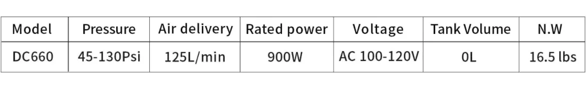

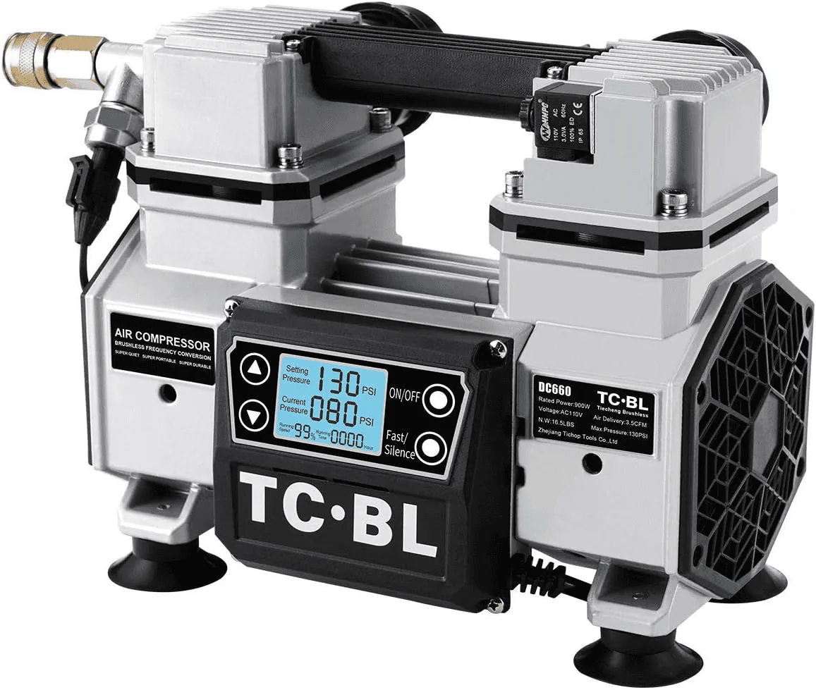

I didn't want to have to take the tow hitch cover off when off-roading (that cover prevents the mud from getting in your hitch receiver and all over your trailer electrical outlets). Plus, the quarter-turn retainers that hold the cover on get caked in mud too. So I'm using this 120V unit. Probably overkill, but with a MorrFlate 4 tire filling hose it will fill all four of Cybertruck's AT tires, simultaneously, from 50 psi to 65 psi in only 3 minutes and it just plugs into the 120V outlet with a heavy duty 3-prong 120V plug. Yes, it's blazing fast. Tesla recommends 65 psi for towing trailers.
Tesla Cybertruck Tire Inflator I’m using 1717170760584-qy
It's very quiet and solid sounding but I can't vouch for the reliability of the digital controls as I've only used it once. One of the four head bolts on one of the compressor cylinders had not been fully torqued from the factory. I tightened it before I used it, and all seems well. It doesn't jump around like most inflators, it weights 16.5 lbs. and is rated at 900W (which is why it can move some serious air).
I think it's an impressively engineered compressor, However, I don't think I could jerry-rig it to pump if the electrical controls failed, that seems to be the potential weak link. That said, it costs a fraction of the Viair solutions that are slower and require accessing the trailer's electrical plugs.

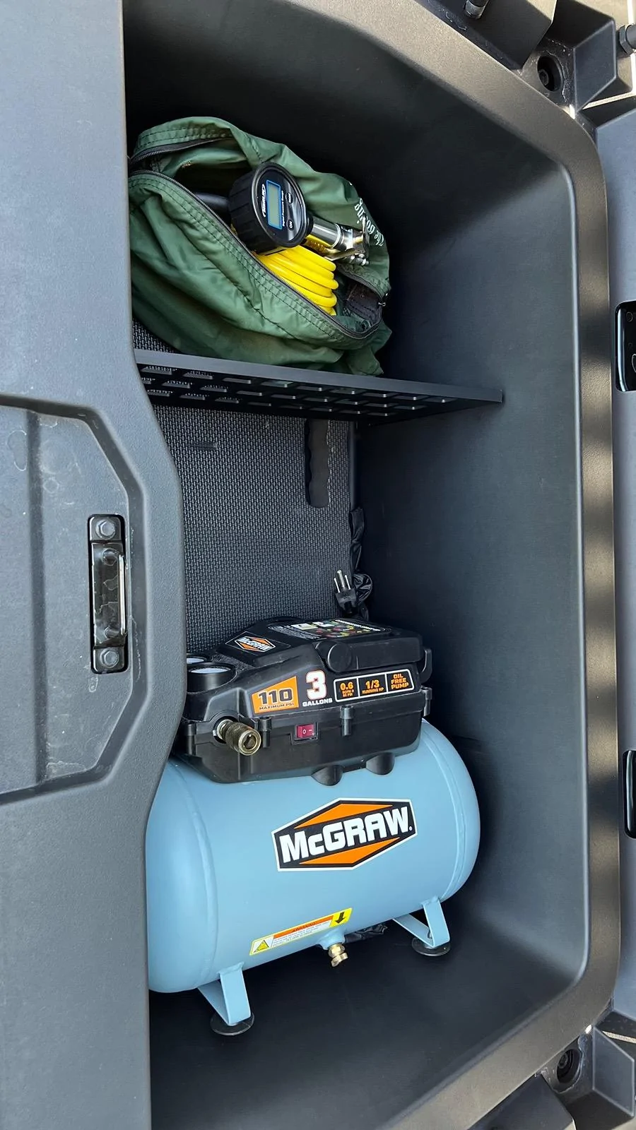

My interim solution is this Harbor Freight special until I decide to go with MF or VIAIR. Works well so far but need to do the 36 psi test.
MCGRAW 3 Gallon 1/3 HP 110 PSI Oil-Free Hot Dog Air Compressor - Item 57572 https://hftools.com/app57572
Tesla Cybertruck Tire Inflator I’m using IMG_2077
10,293
20,697
I like that one but specs might not support off-road deflation to ~36 psi.
That will be about 3 times as slow as the one I linked to.
Why do you think mine not be be suitable for 36 psi deflation/inflation to 50 psi? Don't make such silly statements. It will pump them up faster than that McGraw unit because it has higher airflow at 36-50 psi. Plus, it doesn't have to pressurize a steel tank first.
