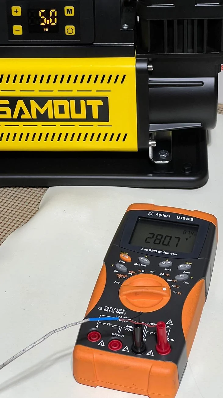

Here's the first compact 120V compressor I've seen that I think might be able to beat the one one I bought:
Amazon.com: SMAOUT 12V Air Compressor, Portable Inflator 7.06 CFM, Air Pump Max 150PSI for Heavy-Duty Offroad Tire, 4x4 Vehicle, SUV, RV : Automotive
Please note, I have no experience wth this unit and am not recommending it based on anything other than it looks like it might be a reasonable solution. I have no idea how it sounds, how hot it gets, how reliable it is, etc.
Unfortunately, it's quite heavy at 25 lbs. I think mine is 19 lbs.

It’s actually 12v, NOT 120v. I have this unit and run it with a 120v-12v converter that can handle the high amperage. Works great, but the heat generation is insane. I would never buy one that didn’t have the duty cycle and overheat protection. Most people will buy these for off roading, so 20 psi to 50 psi inflation. That’s a lot for a unit not designed for that use case.
Tesla Cybertruck Tire Inflator I’m using IMG_2238
