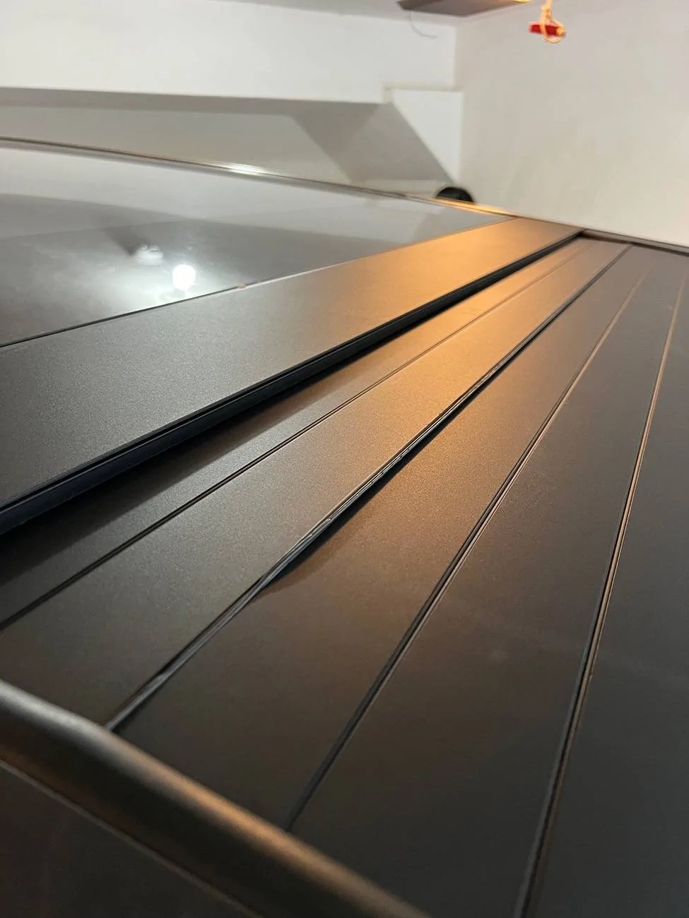

Just dropped my CT off at the SC last Friday, picking it up a week later in worse condition. Tried to open the cover and the rubber sides fell off as well there is a grinding noise and the cover won’t close all the way now.

I had mine done . Noticed the cover to be more of a rattle but certainly not like yours . Clearly they need to fix it

That’s clearly an improperly fitted tonneau … need to go back . Suprised they released it like that .

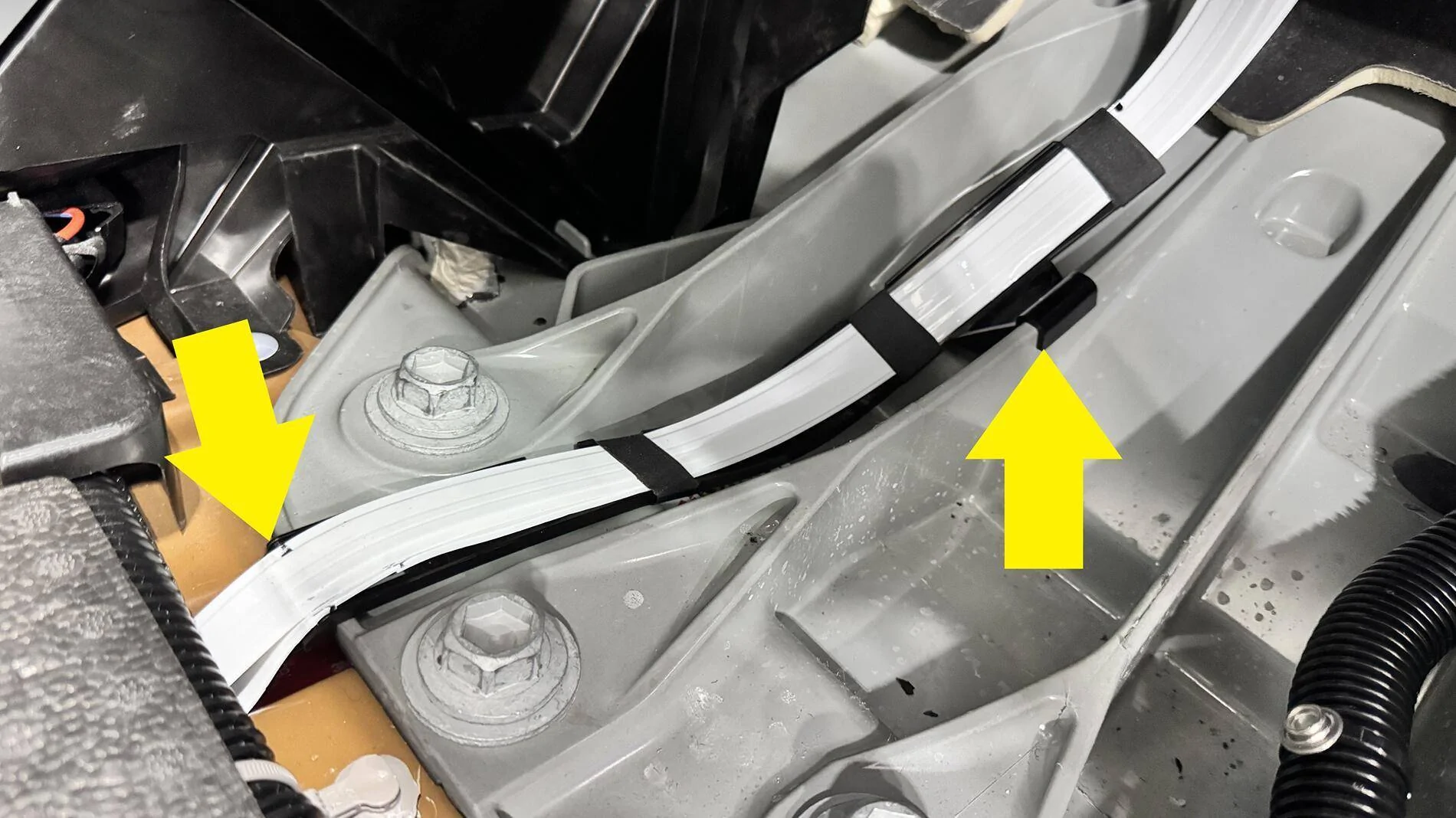

What is this about the flex cable? What is that part and what’s wrong with it?

There’s a long, flat data cable that runs along the floor from the front to the back. Tesla issued a service bulletin to check that the cable was properly routed, because it could fray and short.
https://service.tesla.com/docs/Serv...004_Install_Flat_Flex_Cable_Harness_Guide.pdf
Personally I’m not interested in the inspection, as the cable runs under the carpet, and thus inspecting it means pulling the carpet, the seats, and the center console.

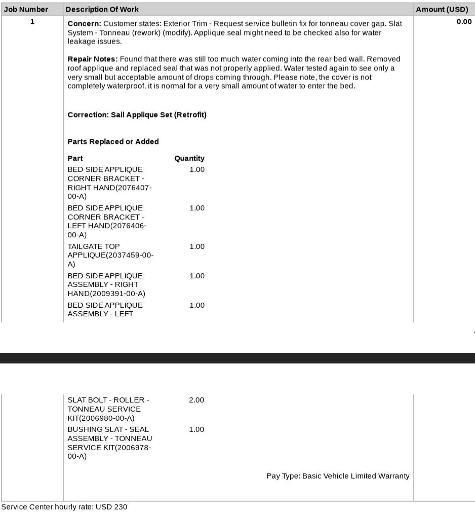

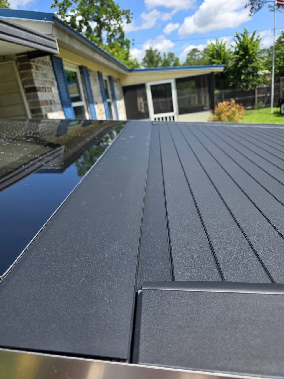

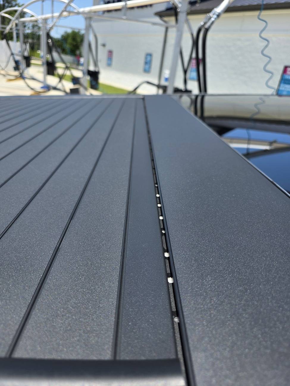

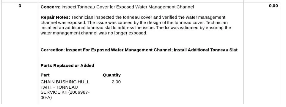

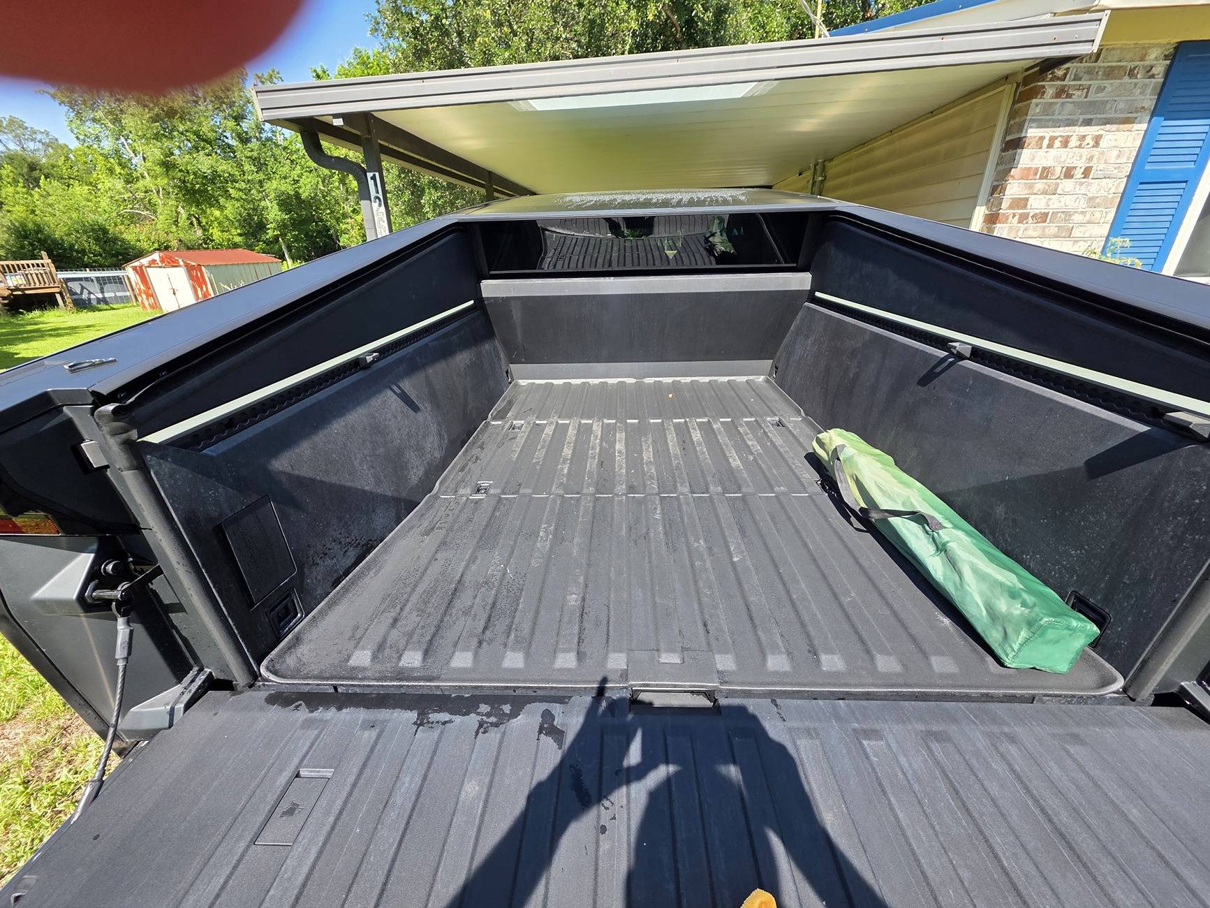

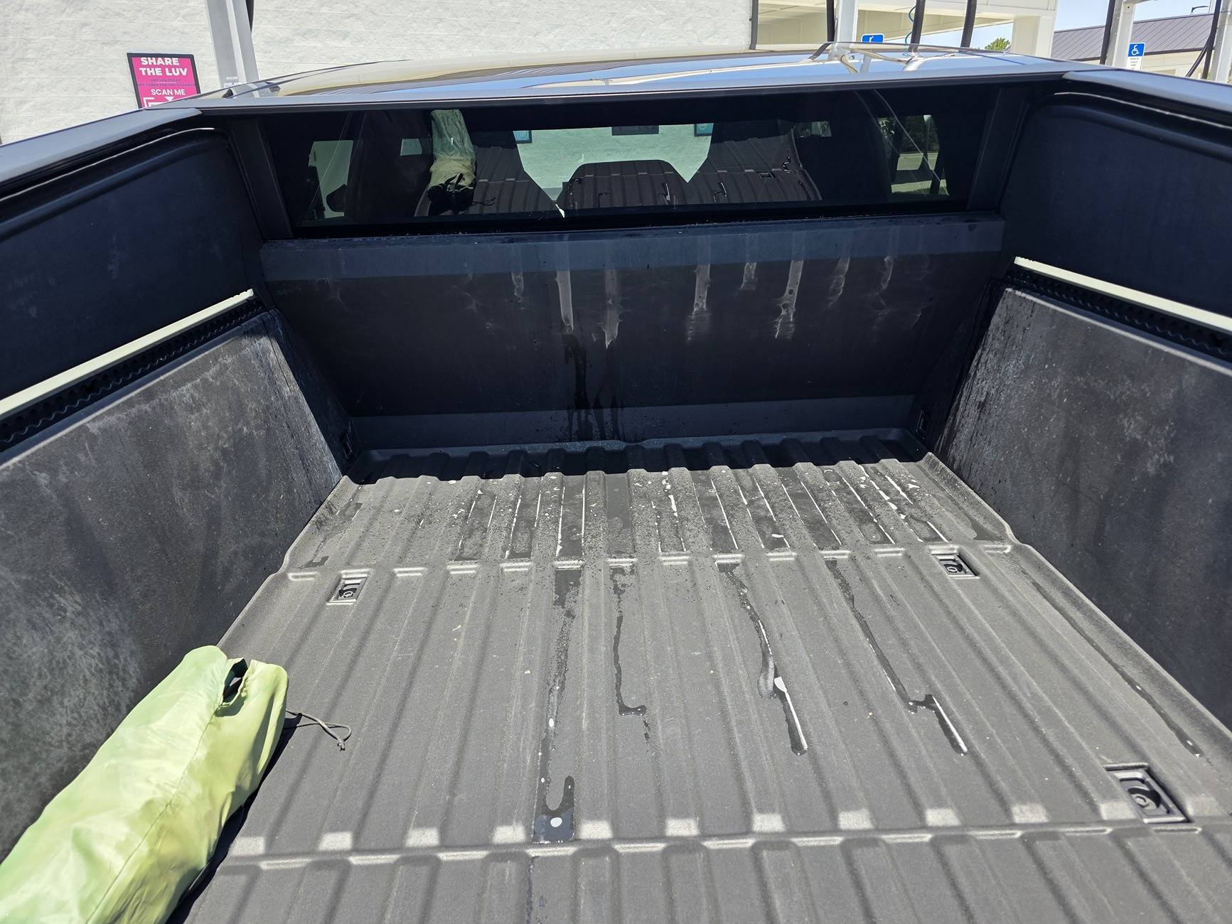

I got mine done yesterday by the Jacksonville FL SC. Everything they did so far looks good and it is working fine. No more leaks in the vault ether (I tested). I had much water leaking in before fix. Pics of invoice also for this fix. They started fixing at 11:00 am and finished at 1:00 pm.
Before slat fix done:
Tesla Cybertruck Tonneau cover gap issue fixed by Service Center under warranty 20250515_135706
After slat fix done:
Tesla Cybertruck Tonneau cover gap issue fixed by Service Center under warranty 20250530_113954
Water intrusion before fix:
Tesla Cybertruck Tonneau cover gap issue fixed by Service Center under warranty 20250515_135538
Water intrusion after fix (pretty much none):
Tesla Cybertruck Tonneau cover gap issue fixed by Service Center under warranty 20250530_103628

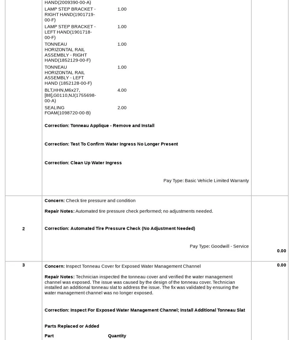

Invoice for this service work:
Tesla Cybertruck Tonneau cover gap issue fixed by Service Center under warranty 2025-05-30 14_27_19-page 1 invoice469af793-9961-4546-a1c3-0dba4b711e17.pdf
Tesla Cybertruck Tonneau cover gap issue fixed by Service Center under warranty 2025-05-30 14_27_19-page 2 invoice469af793-9961-4546-a1c3-0dba4b711e17.pdf
Tesla Cybertruck Tonneau cover gap issue fixed by Service Center under warranty 2025-05-30 14_27_19-page 3 invoice469af793-9961-4546-a1c3-0dba4b711e17.pdf
