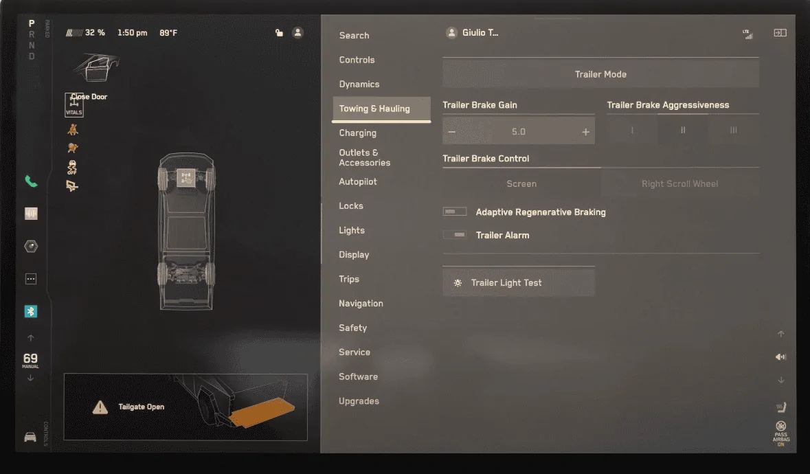

Tesla Cybertruck Towing Range Numbers? 1704904438793
