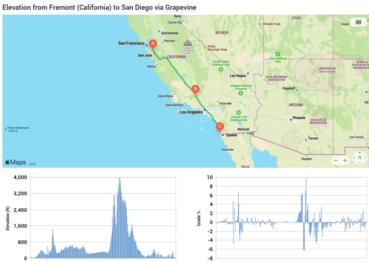

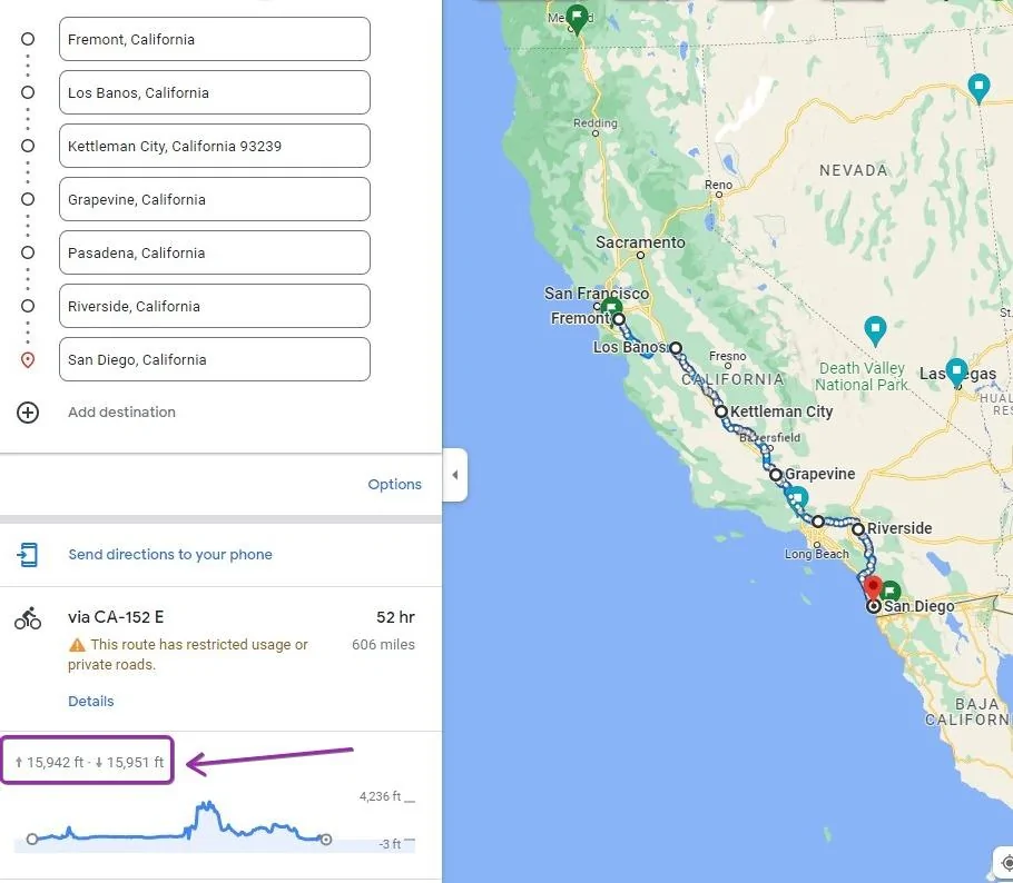

Here is a map I did for the 'famous' Tesla-Semi going 500 miles. It had about the same miles in gain of elevation vs drop in elevation. Pretty surprising the regen recovery and for them to hit that goal (although their speed was questionable).
Google maps with waypoints for all the locations in that graphics show 15942 ft up and down.
Tesla Cybertruck Towing Range Numbers? 2aiMc9z
This map has some % grades on it in the lower right.
See it here: Elevation from Fremont (California) to San Diego via Grapevine
Tesla Cybertruck Towing Range Numbers? 4phtEdH

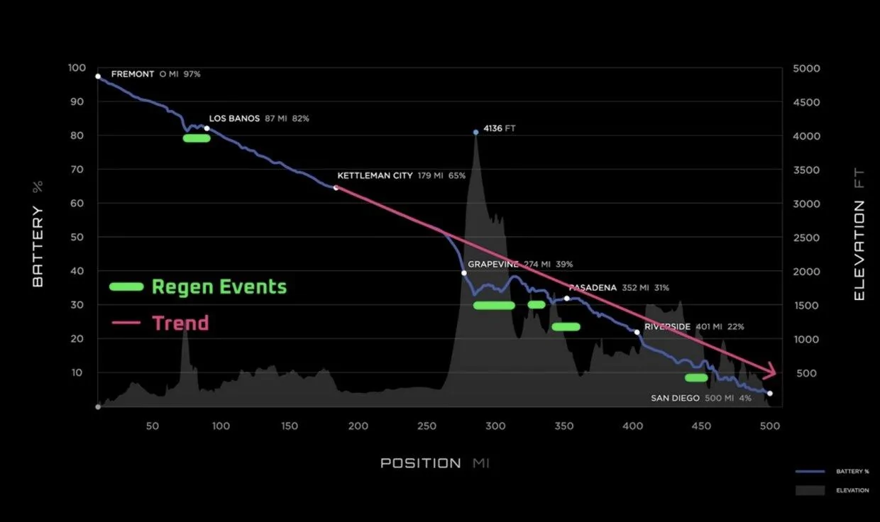

the one full of chips? ?
what’s interesting about your elevation map: if I understand it correctly, it’s sort of good conditions for getting good regen.
the truck went up a steep incline relatively rapidly (doesn’t take that much extra energy), but then the downhill portion took noticeably longer / over a longer distance
If you can eg go up 10k feet over 10mi, then go back down 10k feet over 50mi, you’re regen returns should be good
you basically get 50 ‘free’ miles of range at only the cost of going 10mi that spender say 15mi of range energy

thanks, looks cool. I can't tell from the data your showing, but exactly what difference did the brake regen have on the outcome?
10,238
33,893
Tesla Cybertruck Towing Range Numbers? IMG_2697
This shows SoC over distance, with the elevation changes overlaid. The green bars show how the SoC recovered when traveling downhill.

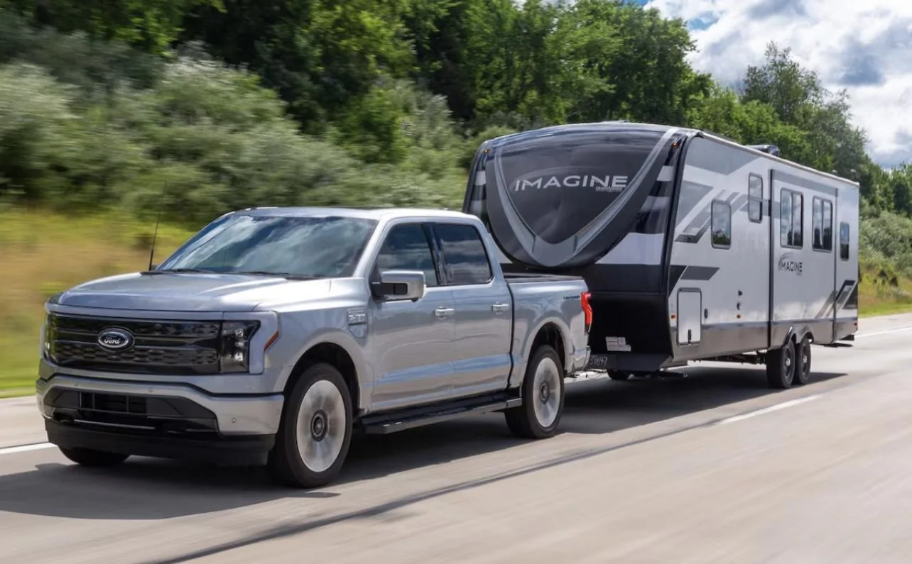

Sure, you can find reports out there of Gering less. Like this often-cited MotorTrend article from last July
but dig into those reports
First, MotorTrend used a Platinum trim. Everyone knows that the Plarinum range is 300 owing to the larger rims and additional weight. What fewer people understand is that “300” figure is the EPA combined rating. The Plarinum’s EPA hey rating is 267mi
Second, MotorTrend’s article focuses on the weight of the trailer. It gives near zero substantive attention to or discussion about the aero of the trailer - which oversight alone should be a red flag of the article’s attention to relevant detail. Here’s the “heaviest” trailer (7Klb, btw):
Tesla Cybertruck Towing Range Numbers? 5A2A9417-7975-4833-A748-6A695C7A5EB1
Third, they targeted 70mph, and averaged between 64-67.
Uh oh, that’s 20mph faster that the EPA highway conditions (48mph), so the Platinum that starts at 262mi max range is - even before counting a trailer - now down to around a 220mi range, at best.
With a max theoretical 220mi range unladen, where do things head once you put on a 34ft RV?
Well, MotorTrend says 90mi. Problem is, MotorTrend’s results are only reporting what the truck’s guess-o-meter was reporting at the end of a 80mi loop. In 2022 the truck’s guess-o-meter was notoriously finicky when presented with new driving scenarios, like hooking up a 34ft RV and doing its first and only 80mi with it. MotorTrend didn’t even mention PSI or if they (correctly) overinflated for long haul heavy towing. Or what the temp was. Or if they have a shit about any of this important info.
Meanwhile and sense then, actual owners with repeat experience have reported better and better results once they, and the truck, understand better how to - eg - maximize range if daring to attempt to tow long distance with a 34ft RV. Or, alternatively, viewing a 34ft RV as a non-starter for them.

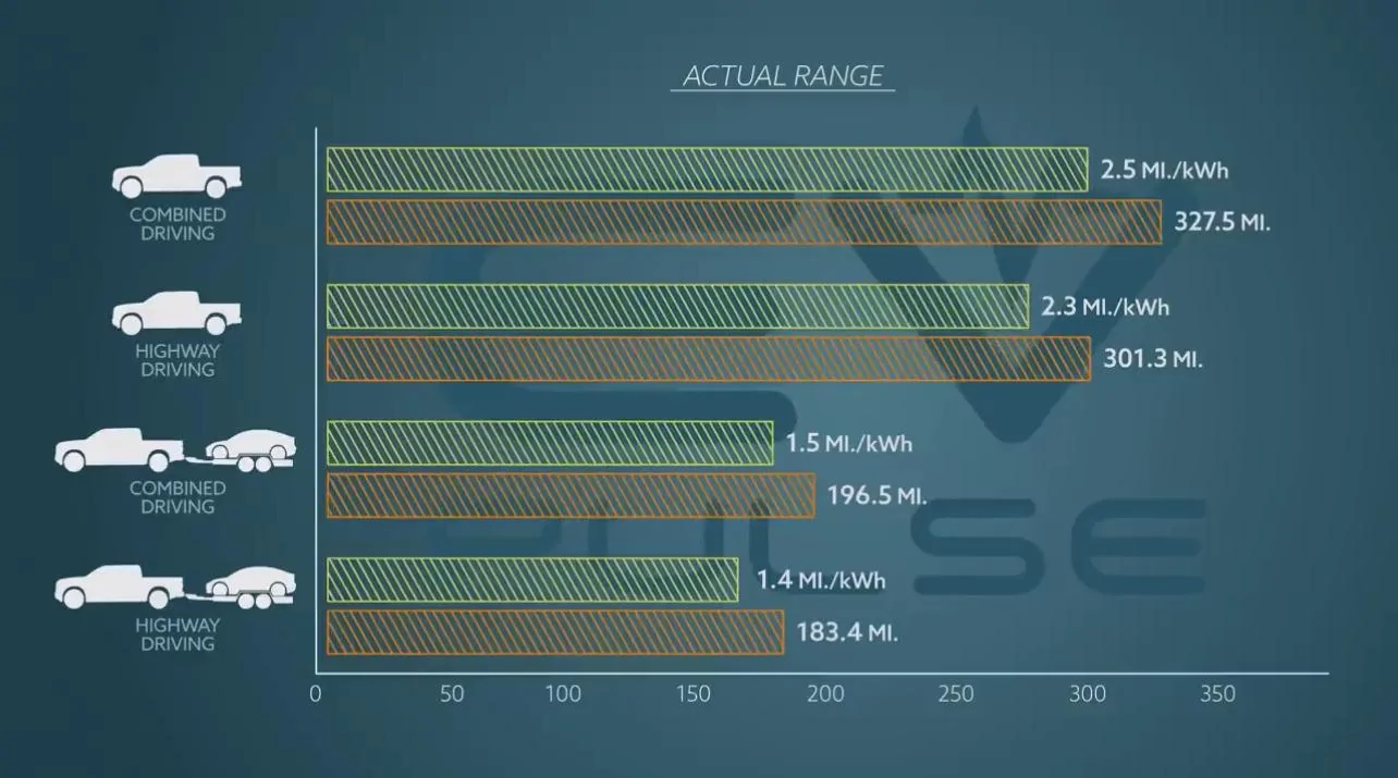

On the other end of the aero/weight equation, here’s (actually detail-oriented) EV-Pulse guys with a car hauler with a Model Y (7K lb), who did both blended city/hwy and full hwy tests, with and without the trailer, and these are their results:
Tesla Cybertruck Towing Range Numbers? C292ED35-22BF-4D0F-9834-3D13B3D26E64
That above 1.4mi/kWh / 183mi for their full highway towing test, results in a CT assumed equivalent of 172mi

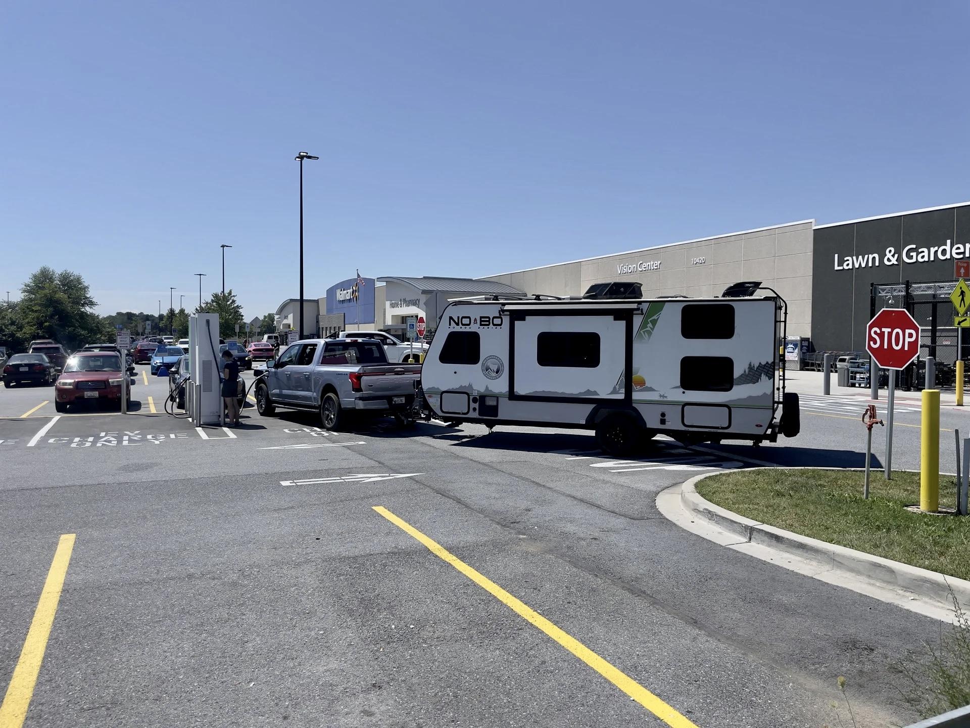

Then to scratch your camper-like scenario itch, here’s a guy with a 20’ No Boundaries (10’ tall and 8’ wide) (3700lb):
Tesla Cybertruck Towing Range Numbers? 00373D33-CDB8-4E8A-9C3E-09B31E24F27C
His was a major hilly route into the mountains, at while at an average of 55mph (more in that later), he averaged 1.22mi/kWh (from 1.3 on flats to 1.0 in major hills) in his ~1700' elevation change out trip, resulting in a CT assumed equivalent of 150mi
On his return trim (hills working for him), he averaged 1.34 mi/kWh, resulting in a CT assumed equivalence of 164mi
He later does a 280mi trip at 65mph, and gets 1mi/kWh or CT 123mi equiv

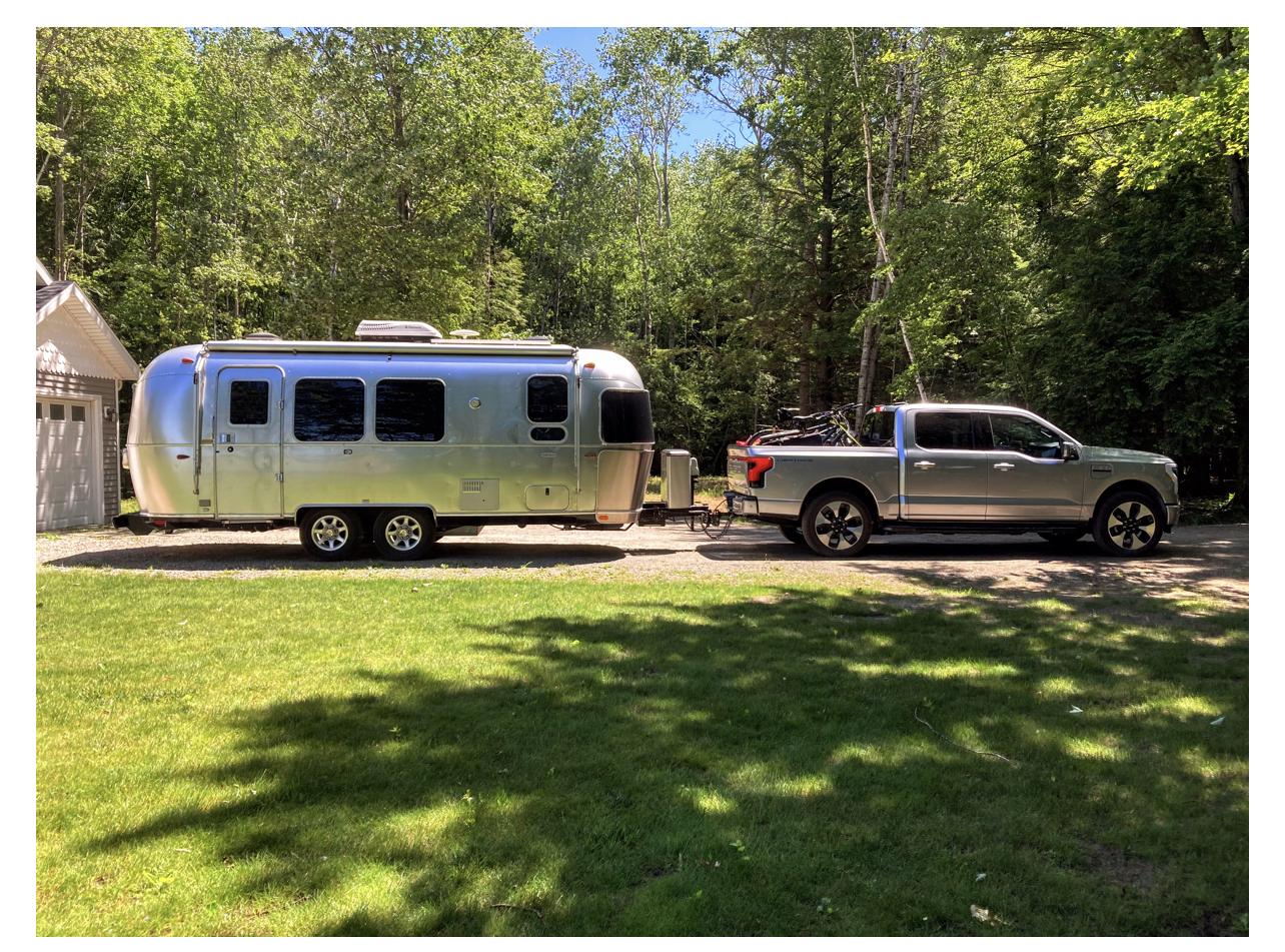

Similarly, here’s a guy with an good sized airstream, did his first ever trip (hadn’t yet even learned the tricks), did all speed limits, and got 1mi/kWh uphill in a headwind to destination and 1.4mi downhill no wind from
Tesla Cybertruck Towing Range Numbers? BABE9221-5821-4A45-BA04-2B910D2C4FA3
again, pulling a damn airstream (not as aerodynamic as people think) that’s a CT assume equivalence of 123mi uphill/headwind and 172mi downhill
Ok, so we’ve covered “people think are aerodynamic but aren’t” (the boat), “aerodynamic but heavy” (the car hauler with a Tesla on it), two reasonably large campers/RVs, which is a pretty good range of what (I think) anyone should expect to be doing with a 1/2 ton truck rated at 10K towing. And, these are reports from people who understand the truck and BEV truck towing, and even one guy who did his first tow With the airstream. And these again aren’t meant to be exceptions to the rule, but instead indicative of the rule observed when looking not at Y/T but instead real owners who have any clue what they’re doing.

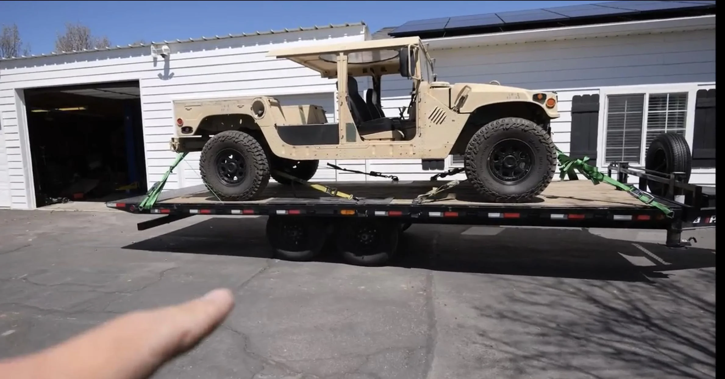

Here’s a Y/T towing 10,000lbs (really more than you want to do with any 1/2 ton truck), and while it’s a car hauler, it’s hauling in this case a f’n HumVee
Tesla Cybertruck Towing Range Numbers? 33AE4E4A-74D3-4AE0-998D-B0DF49685E1F
no one should be confused that this is both heavy and NOT aerodynamic. And it’s his first time towing with a Lightning.
112 miles driven, 80% freeway, and got 1mi/kWh
(which, he notes, is also the efficiency equivalent of the HumVee milage itself not towing anything)
