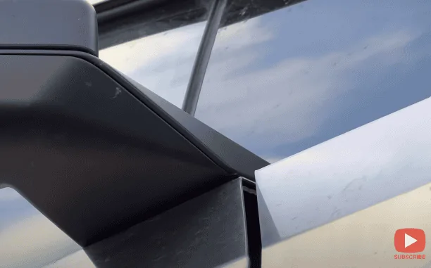

Wow, those are a some assumptions. The recent close up videos do seem to show the exterior being around 3mm. Internet videographers keep forgetting to carry their calipers with them. And I would like to see your engineering resource that confirms the castings provide all the strength needed.
I have been one of this sites biggest sceptics about the term exoskeleton, but Tesla engineers are not fools and they will not waste the strength of those exterior SS panels. They surely sized those castings as a composite frame with the SS panels glued and/or attached to them.
We don't know how much structural strength the SS panels provide. Some, according to Corey Stuben of Munro & Assoc. Which video are you referring to that shows 3mm? 3mm is 0.12 inches, nearly 1/8", and 5 lbs/sq ft. If the SS exterior is not providing much structural strength, is it worth the added weight of 3 mm SS stock which will reduce overall range? The weight of the SS exterior panels has been estimated at between 700 and 800 lbs. An analysis of tradeoffs between strength, range, and cost during final design after having discarded the exoskeleton concept, may have concluded that thinner SS panels is optimal. We'll have to wait and see.

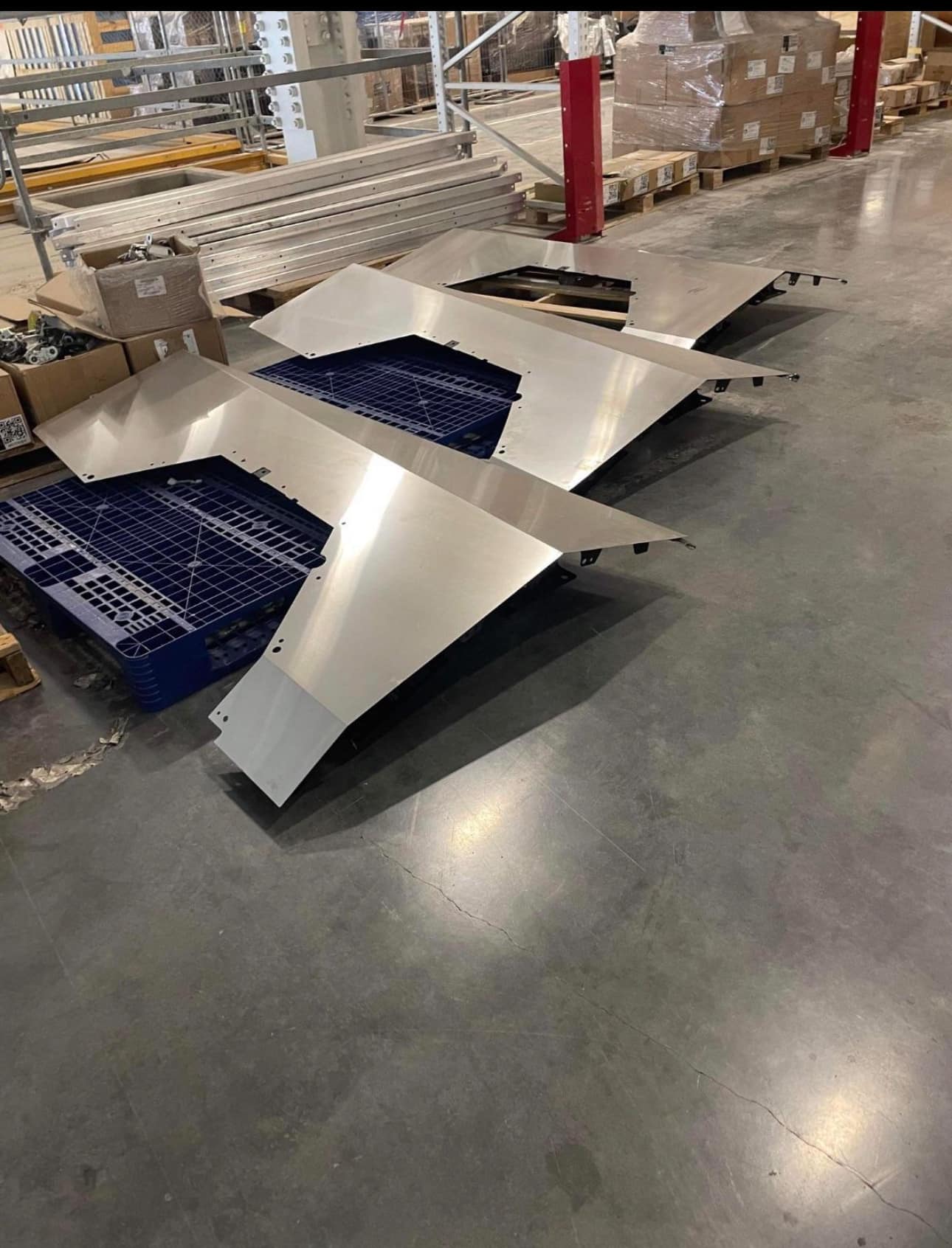

Some of the tabs we are seeing in this image seem like they may be to hold the fender on to the body. They are to hold the plastic closure piece and or wiring harnesses to the fender where the hinge and interior body meet.
4,228
7,750
Planet Earth
$49,900 DM reserved on 11/22/2019. Delivered 6/26/2026
The black mounting tabs on backside are most likely attached to the quarter panel with an aerospace grade structural adhesive. Welding them on would have caused color distortion in the stainless steel.
My guess is that the tabs are attached to the quarter panels using a template for consistency.
Might not be a video, but this image which I clipped from Bearded Teslas walkaround video. Look at the edge of the door panel by the mirror.

I have worked with lots of SS. 1/4 and more. If you have bends it is a lot stiffer. The promise of 3mm is that the edges will be strong enough so a cut edge , like we are seeing is not easy to ding bend of deform. From what I see I think it is 3mm.
