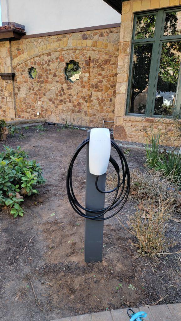

I appreciate the helpful suggestions, but the temporary solutions are too kludgy and/or expensive. I'll have it all done properly when the PowerShare goes in, including a freestanding charge post like this:
Tesla Cybertruck Universal Charger Delivery & Install esla-wall-connector-installed-on-pedestal-577x1024
https://shop.tesla.com/product/wall-connector-pedestal

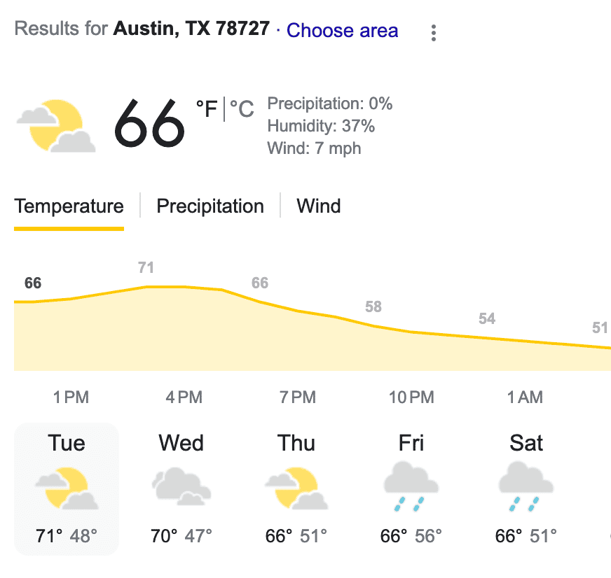

if its cold out good luck actually getting any energy into the pack most of it will be used to keep the batteries warm
Dude, I live in TX
Tesla Cybertruck Universal Charger Delivery & Install Screenshot 2024-01-30 at 12.16.08 PM
Most of the time, I'll need to cool the battery lol

i was directing it mainly to anyone else who is in a cold climate or in case you guys get a cold snap again and start loosing your minds like last time in 2021 :p
