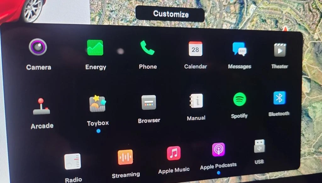

I'm also very interested in USB mp3 music playback...On the screen menu, does it show the USB icon like in the lower right corner of the attached screen shot from my Model 3?
Now that I think about it, that may only be when it recognizes a valid USB stick (which it won't seem to do for you)...I hope you can get it working...

No it doesn't show up there either. I did a little research over on TMC and a thread there suggested it might show up with a reboot of the screen while the drive was plugged in. So I tried that and still no worky.
