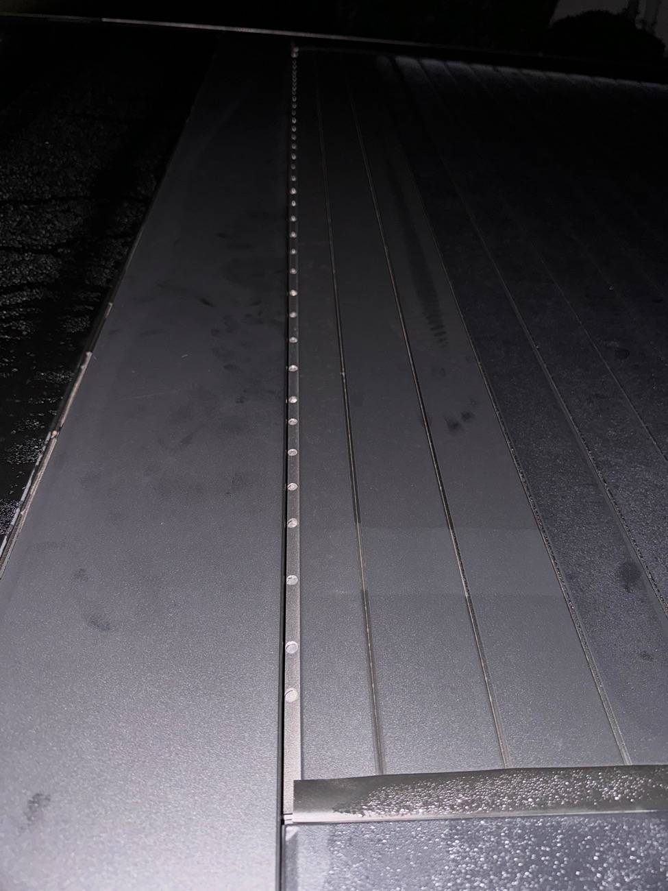

The back of my tonneau has the exposed holes and leaks when it rains too. Vin 20xxx

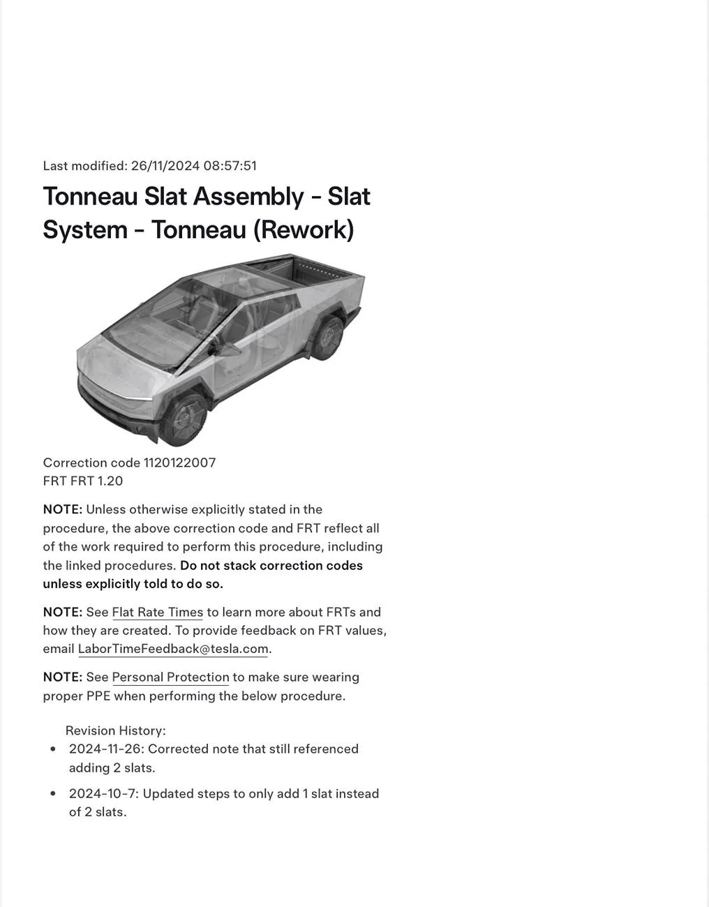

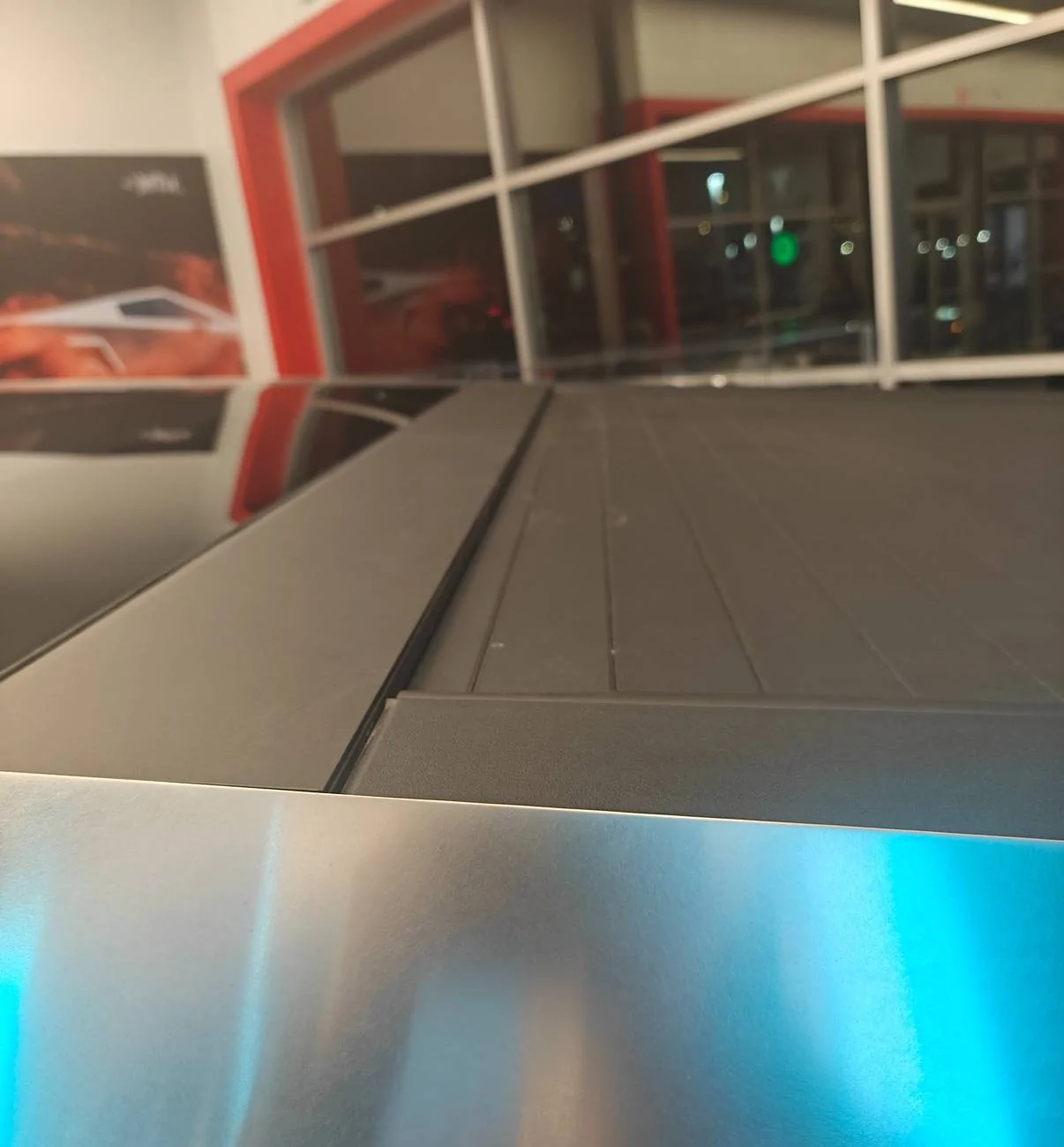

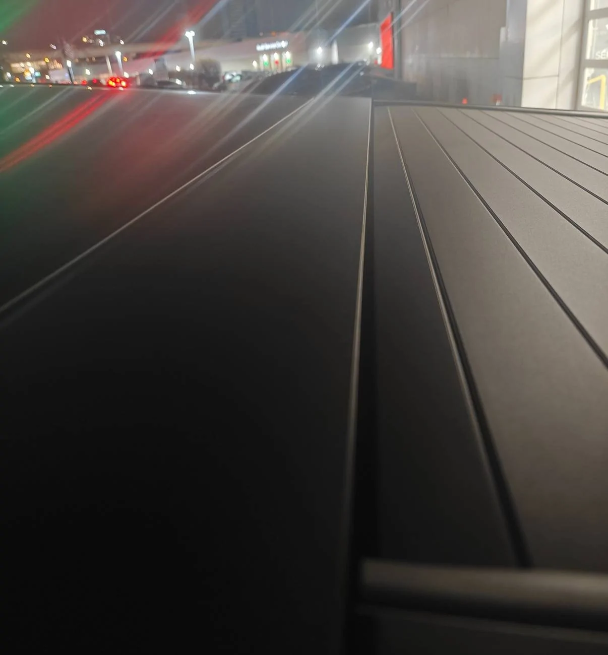

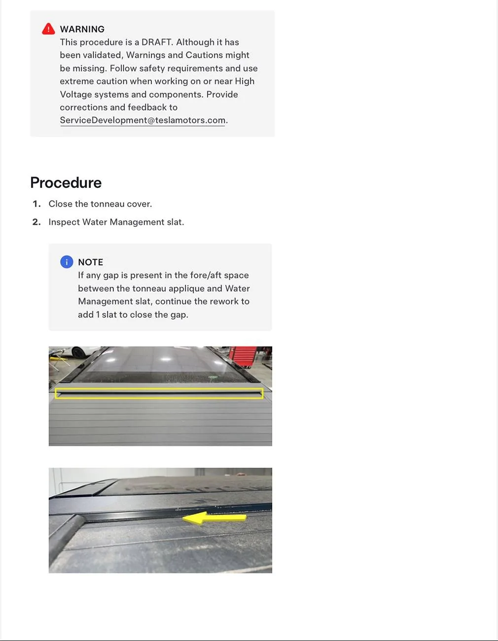

I had a chance to check few cybertrucks at tesla repair center and all had the last slat missing and holes exposed. I talked with a few guys there and it seems like all recent cybertruck like this. It is considered normal. I guess unless there is an official guidance from engineering we should not expect any fix.

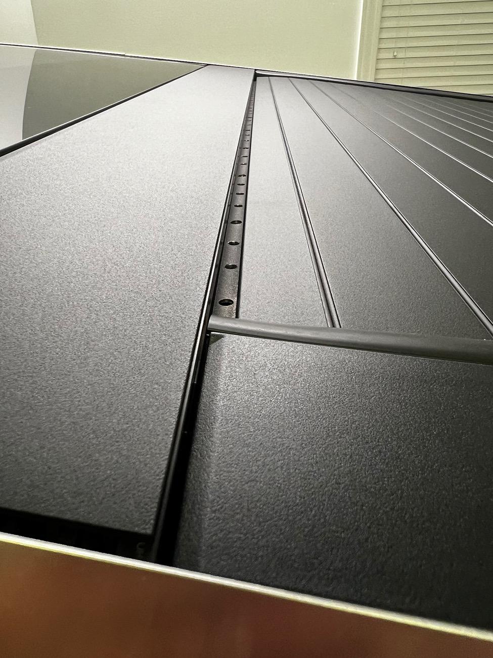

Here’s a better pic. It looks like something is missing. Can someone confirm if this is normal?
Put in a service ticket immediately…it’s not right. It’s definitely not within spec

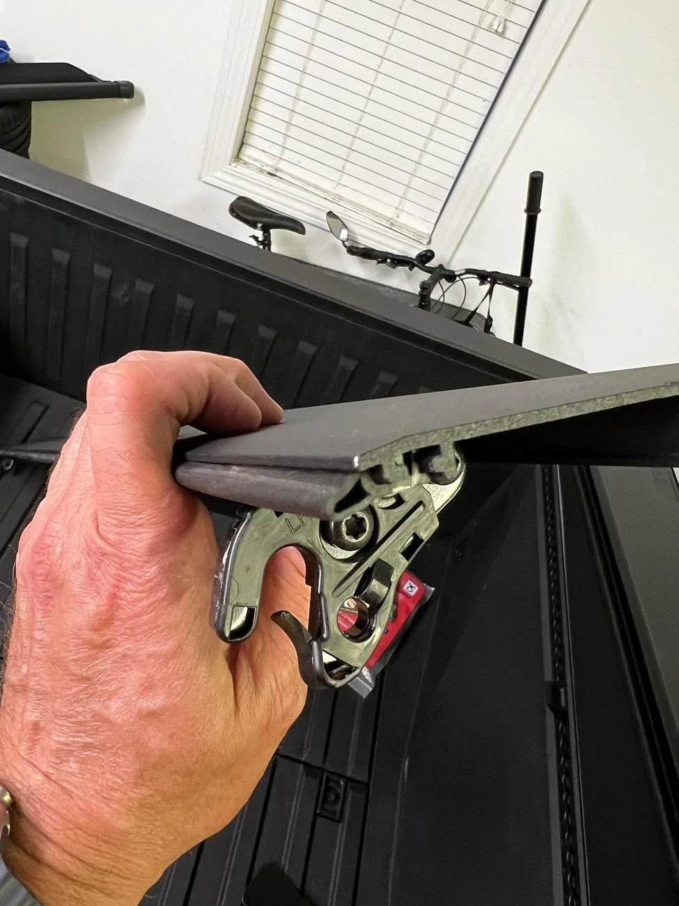

Here’s what mine looks like. No foam.
I think I’m just gonna slap a strip of FlexTape on the underside and call it good.
You better than me…no way I would have taken a “warranted vehicle” apart myself. Bless your heart!
I had a ticket open. They checked few vehicles and all the same and considered within spec.

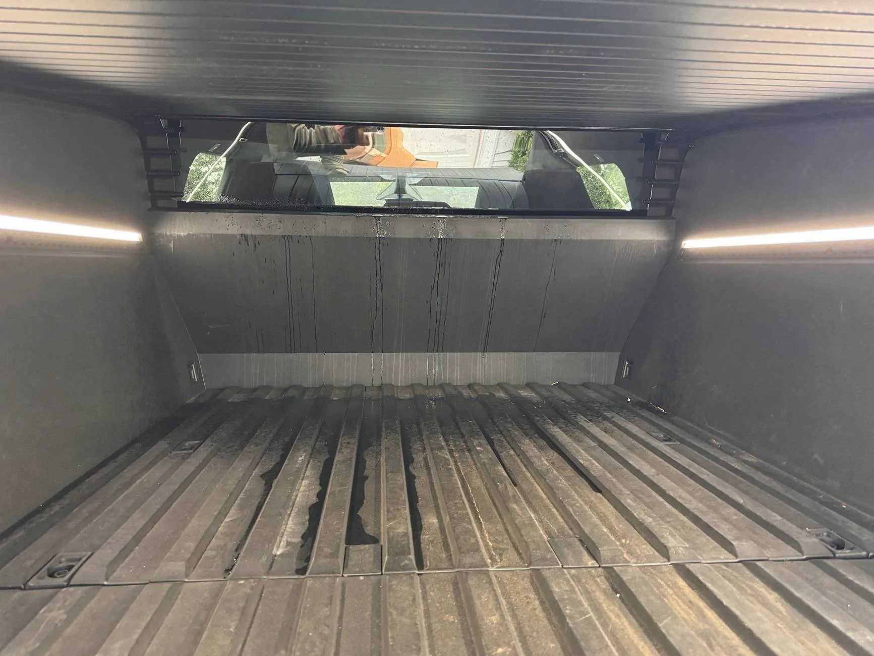

Mine doesn’t show that perforated section as much but it is letting tons of water in at the front of the bed. I expect/assume there will be some leaking near tailgate but the last 2 days of rain have the whole front wall/window area soaked and water pooling a bit. Set up a service for this and some door alignment and hoping it can be resolved.

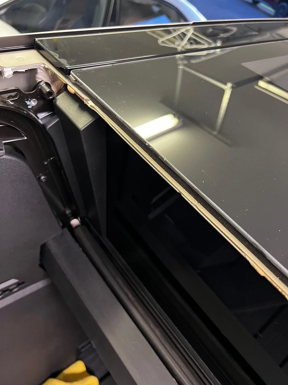

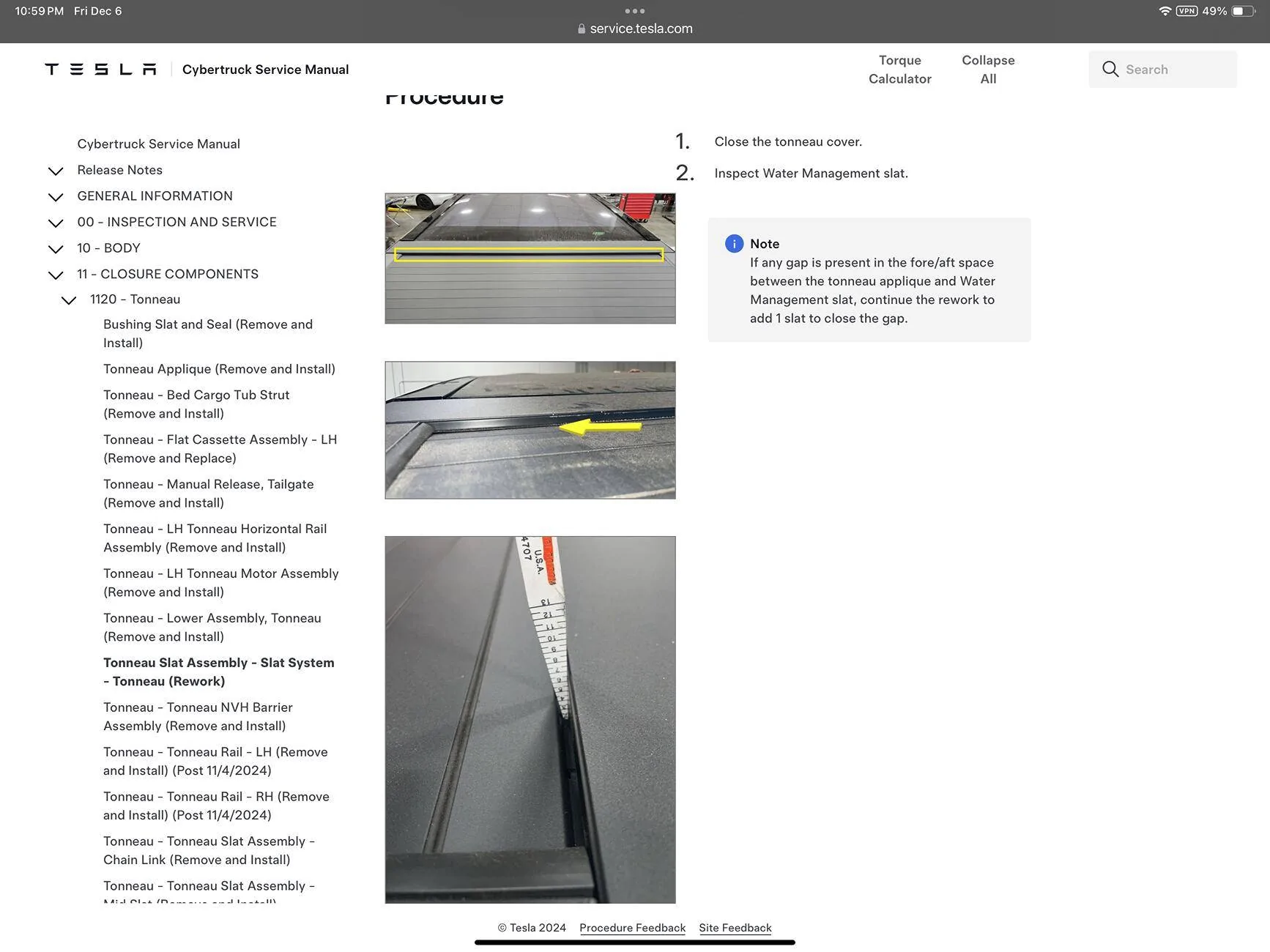

In most cases, the circled part is your main source of leak, not the X location.
