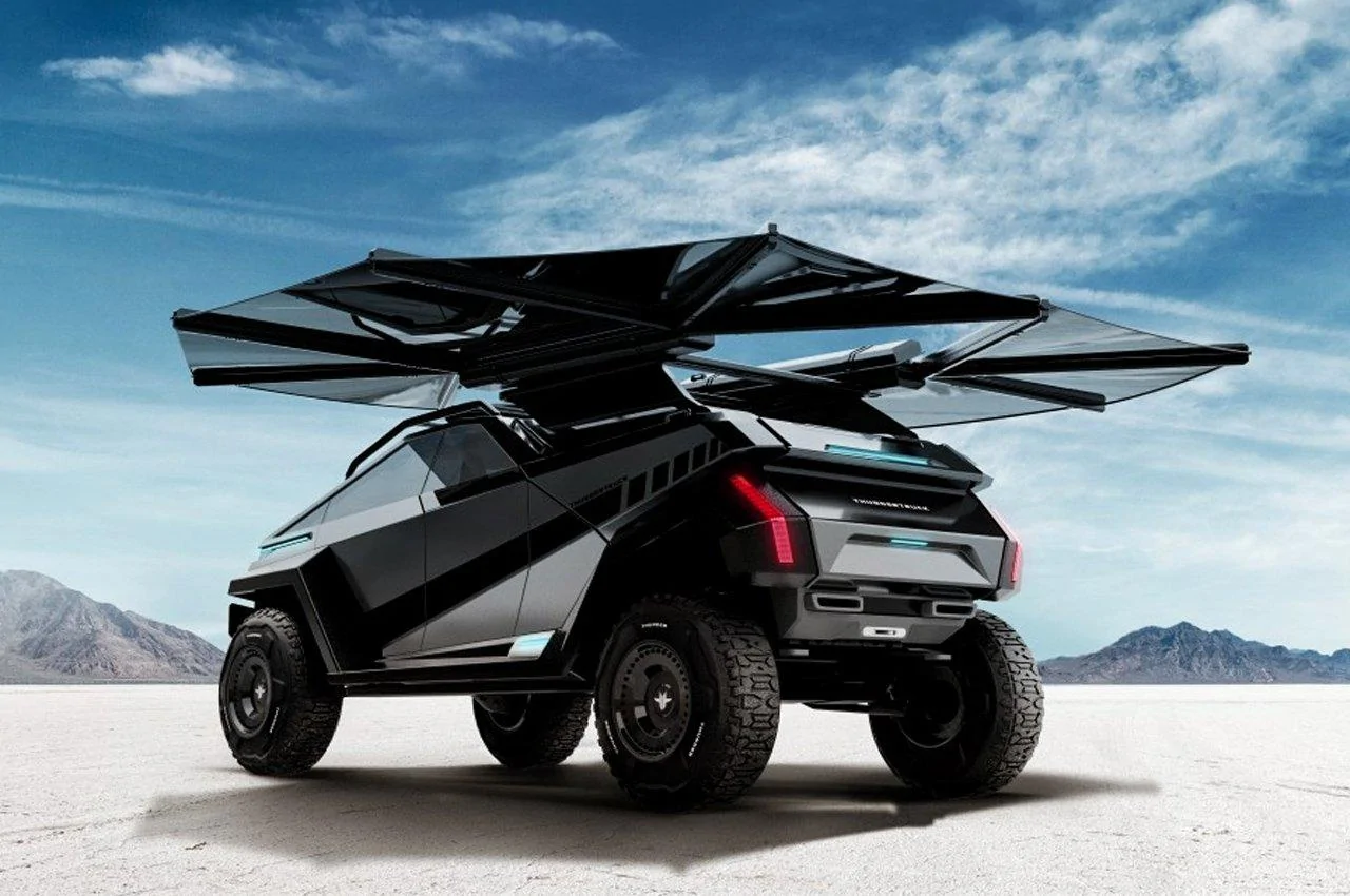

Is this what you want? I think this is a lot of weight and drag so I am looking for something much smaller in storage and simpler in design.
Tesla Cybertruck Vault Mounted solar panel system Wolfgang-Thundertruck-Electric-Truck_6

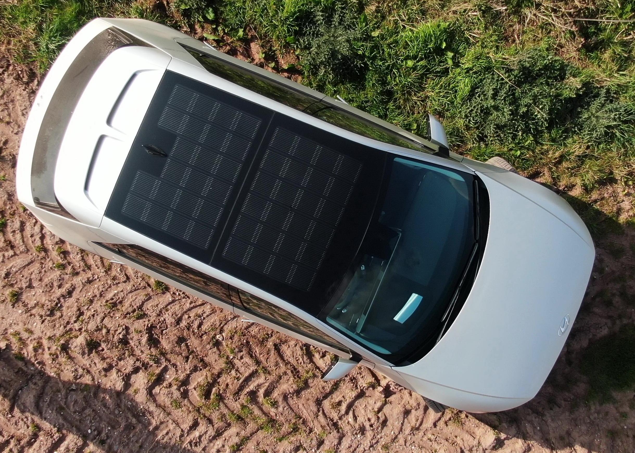

I have a Ocean Extreme on order, locked in last summer and hope to take delivery later this year as my CT holdover vehicle. ?
Ive got the Ioniq 5 with the Solar Roof option which is probably around the same size as that of the Fisker's.
I probably wouldnt have optioned it myself, but all the first edition 'Project 45's came to Europe with it prefitted.
Tesla Cybertruck Vault Mounted solar panel system solar Roof I5

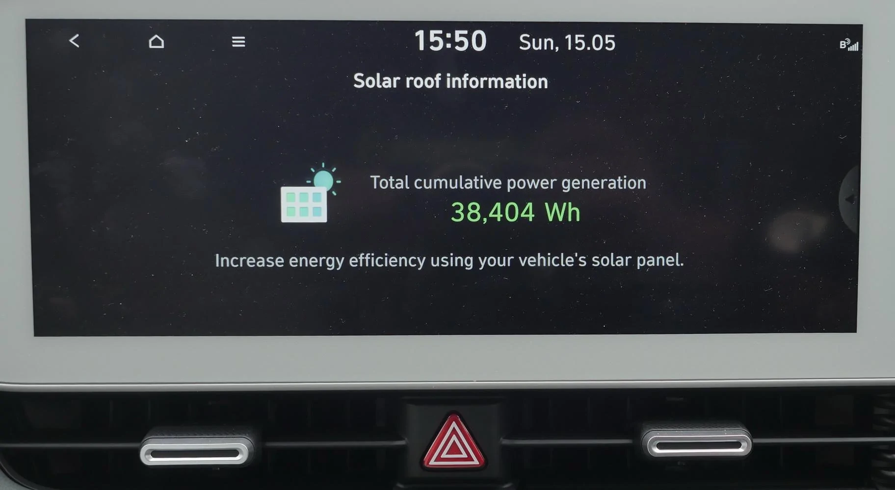

Ive been taking readings from it every week so we can have a look at the total solar accumulated energy over the last year.
15th May 2022 = 38404Wh
Tesla Cybertruck Vault Mounted solar panel system sol 15th May 2022 = 38404Wh

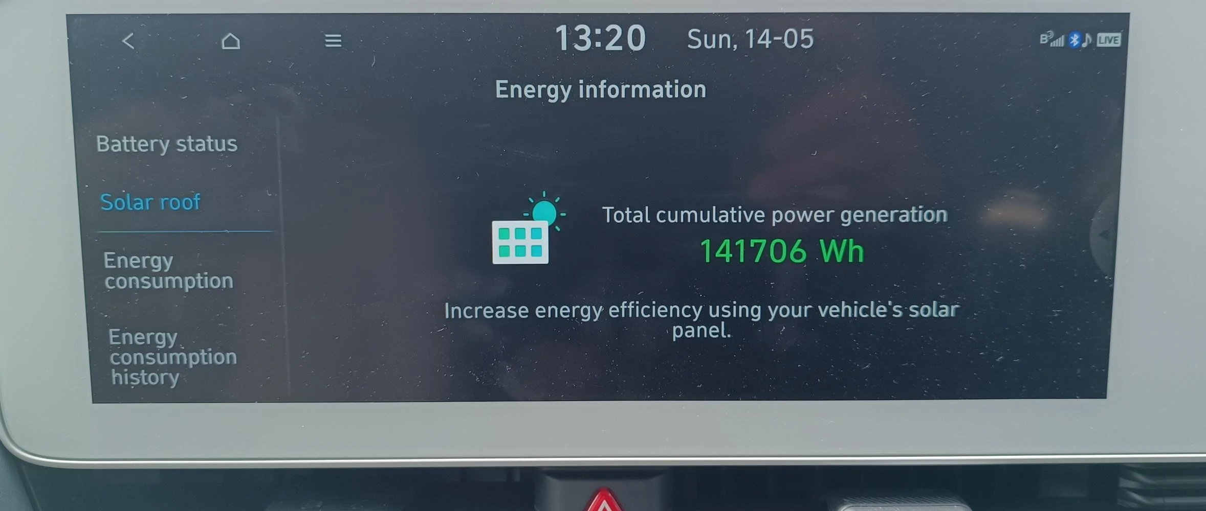

14th May 2023 = 141706Wh
Tesla Cybertruck Vault Mounted solar panel system Sol 14th May 2023 = 141706Wh
So total Solar Power from the roof over 1 year = 103302Wh = 103kWh
Which on a good day is enough energy to take me just over 400 miles
Worth noting I'm in the UK, so the Californian sun would probably generate at least 3X as much.
and with the size of the CT would be … half that?
but im curious as for your Fisker, how does this additional 400mi of charging/year factor into the real world effects?
Because even in California sun, let’s say that figure doubles to 800mi / year, or 2.2mi per day
is that a difference maker for you in any particular, discrete, use case?
or does it for you boil down to the comfort of knowing it’s saved you (in TX electricity cost terms) … $13 per year?
