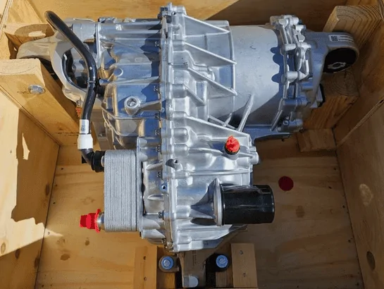

A quick look under the truck, it's clear that only the rear motor/inverter/gearbox assembly was replaced. The half shafts, CV joints, and suspension parts are the original.
Tesla Cybertruck Vibration problem fixed w/ motor replacement (new version) Screenshot 2024-08-02 at 12.08.19 PM
I don't know what a rear motor replacement costs. This used motor is offered on EBay for $12,500. Add Tesla labor rate at $245/hr to carry out a 100+ step removal and install procedure, I'm guessing it's around $18,000. Am I close?
