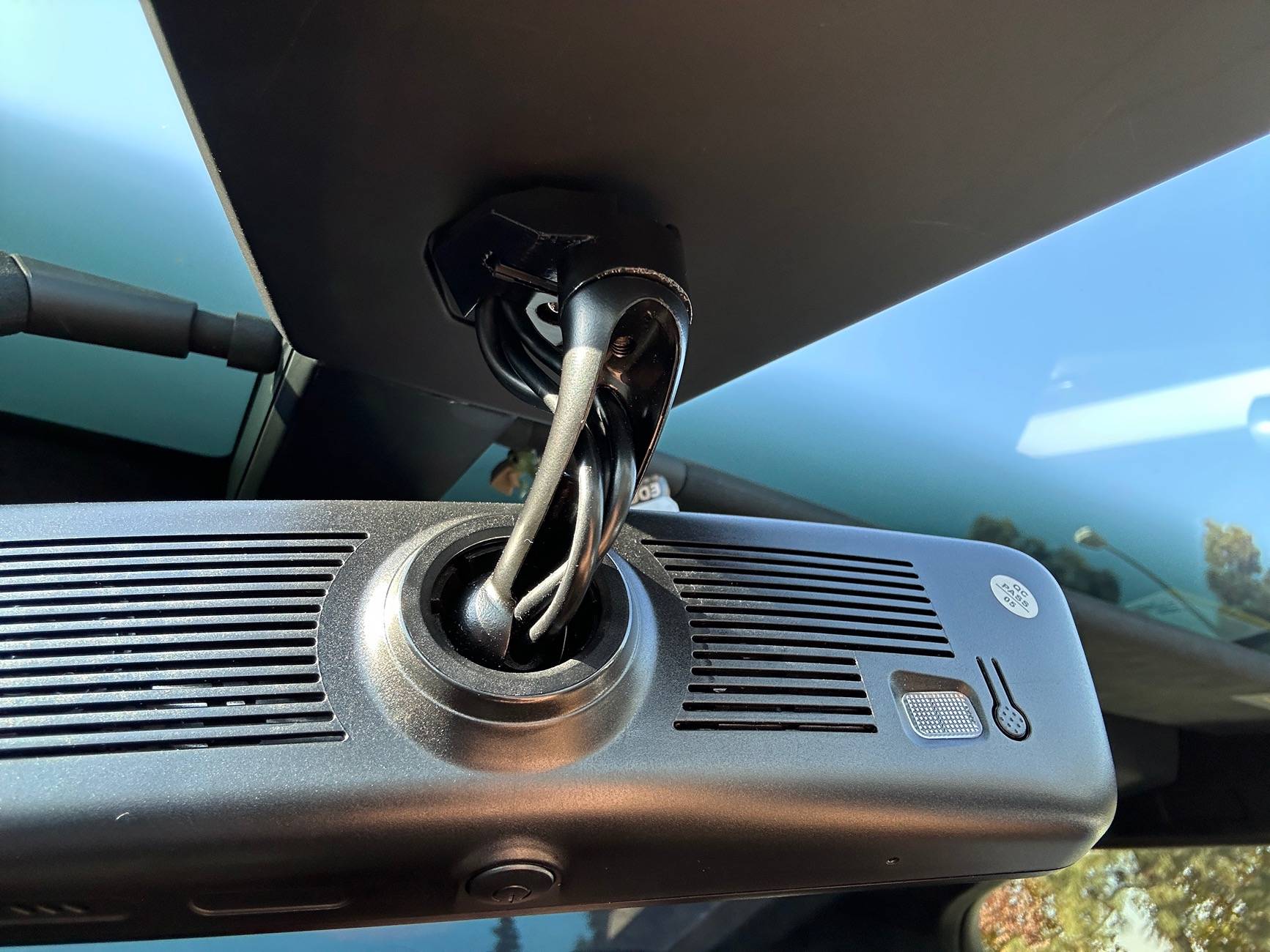

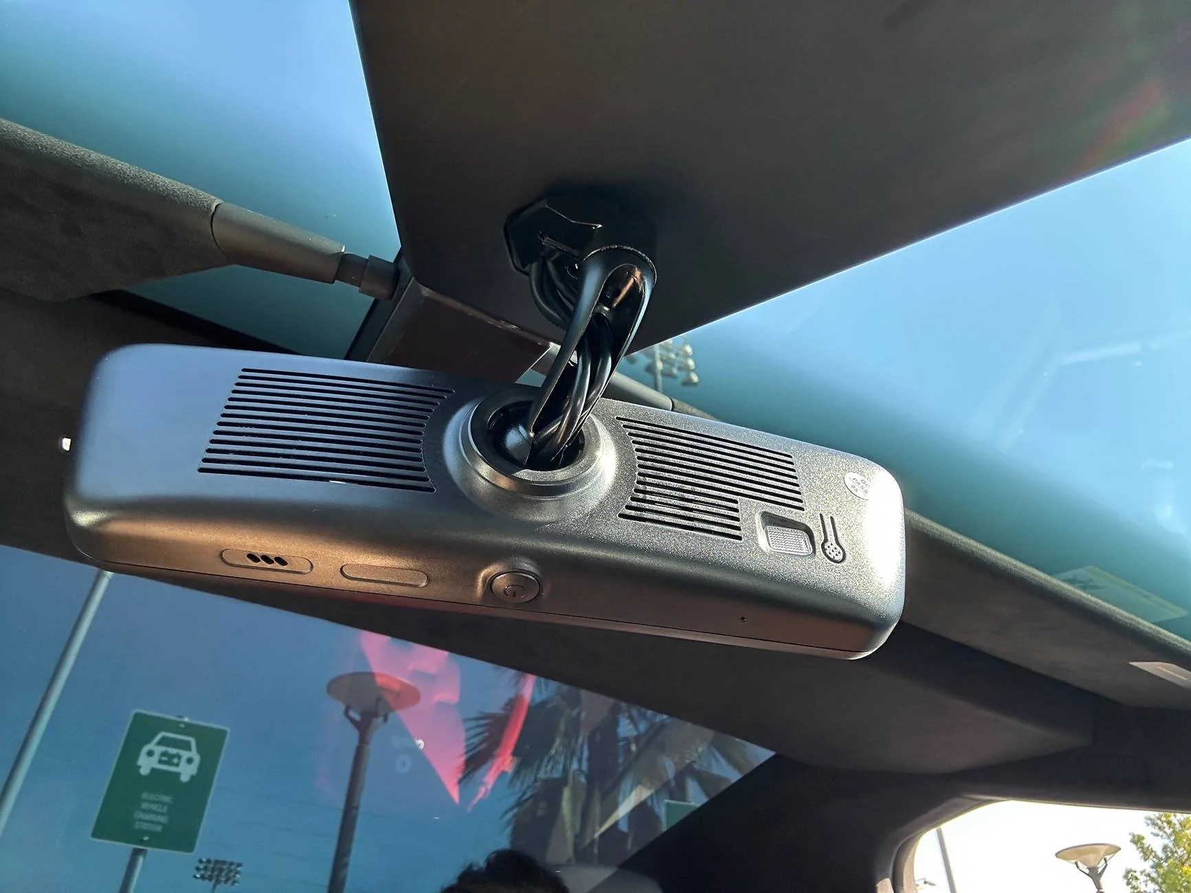

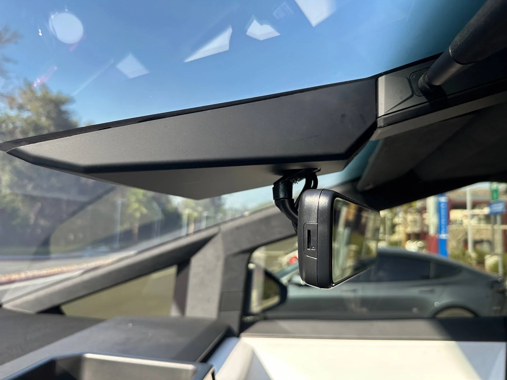

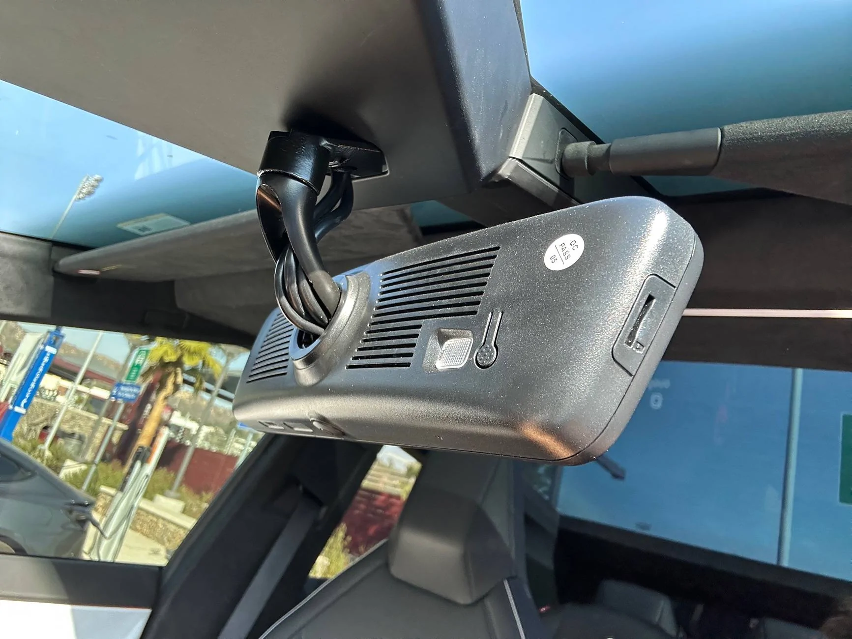

I've had my Cybertruck since February 2024 and the rearview mirror is the biggest miss on this truck. I've been looking all the available options out there and narrowed it down to Hansshow and Wolfbox. I decided to go with Hansshow because I like the OEM style bracket it uses to hold the digital mirror instead of just mounting it on top of the original mirror. Also it's a bit smaller and angular. So far I've been very happy with it!
I noticed most people opted to install the rearview camera on the tailgate area but I didn't want to do that because I didn't want a low angle view. Plus if you decide to use the tow hitch, you won't be able to see anything. I mounted on the top of the truck right on the plastic trim between the roof glass and the tonneau cover so that it can provide an overhead view of the rear while also looking into the truck bed (when open) if needed.
The overall install time took about 1 hour with half of the time trying to squeeze the wires inside the camera housing above the mirror. Routing the wires through the interior of the car and going outside was surprisingly easily. Anyway I made a quick video of my process below.

so I 3D printed the file provided (using Bambu p1p) and then I sprayed a few layers of UV clear coat on it too. Applied double sided tape to the bottom and was able to tuck more wires inside the housing (including the connector) so this is much cleaner Install! Super happy with the results !

make sure you print in ASA or ABS or it will melt.. i learned my lesson. i looked at this one also i went with a smaller camera cap :L)

yeah i don’t have abs/asa. So PETG will have to do for now. I sprayed coats of UV to help. I don’t park outside. But if it warps/melts. I’ll just reprint it again.
