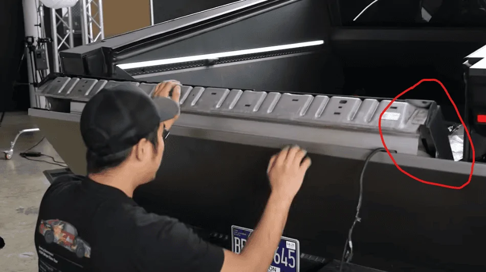

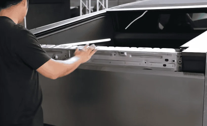

I just now looked at mine and confirmed the cable are taught. However, I noticed quite a bit of flex when pressing down on the top of the tailgate (when tailgate is down). I then reviewed the rear washer installation video and it does appear to not be very well reinforced. In this photo, you can see the end of the U-shaped metal panel and it is not reinforced on the end.
Tesla Cybertruck Warped tailgate issue after hauling load 1723306791831-ij
At first I thought maybe that grey piece along the length that the cable is passing through was a strut but shortly after, he shows another angle and there are no supports at all along the length:
Tesla Cybertruck Warped tailgate issue after hauling load 1723307028249-74
so it does, indeed, appear the tailgate is very weak to supporting any weight an the top when in the down position.

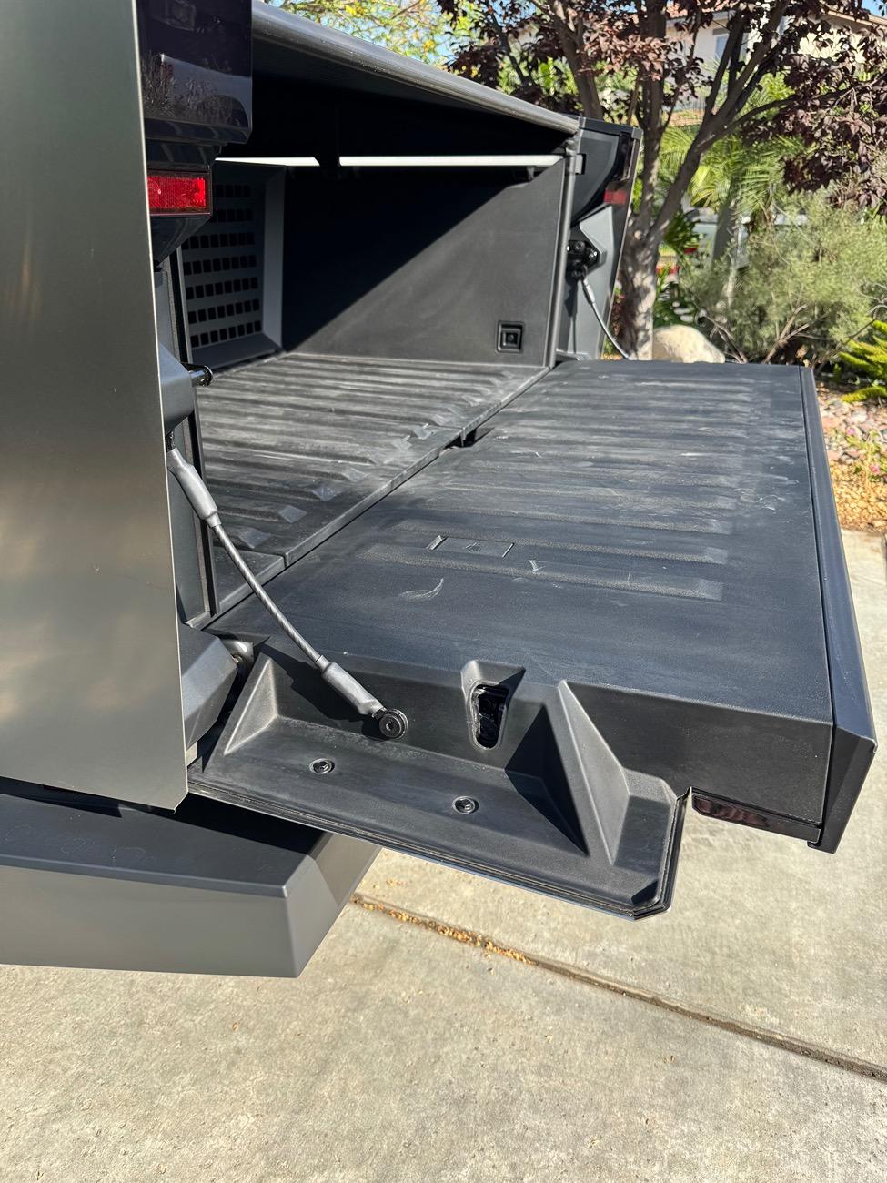

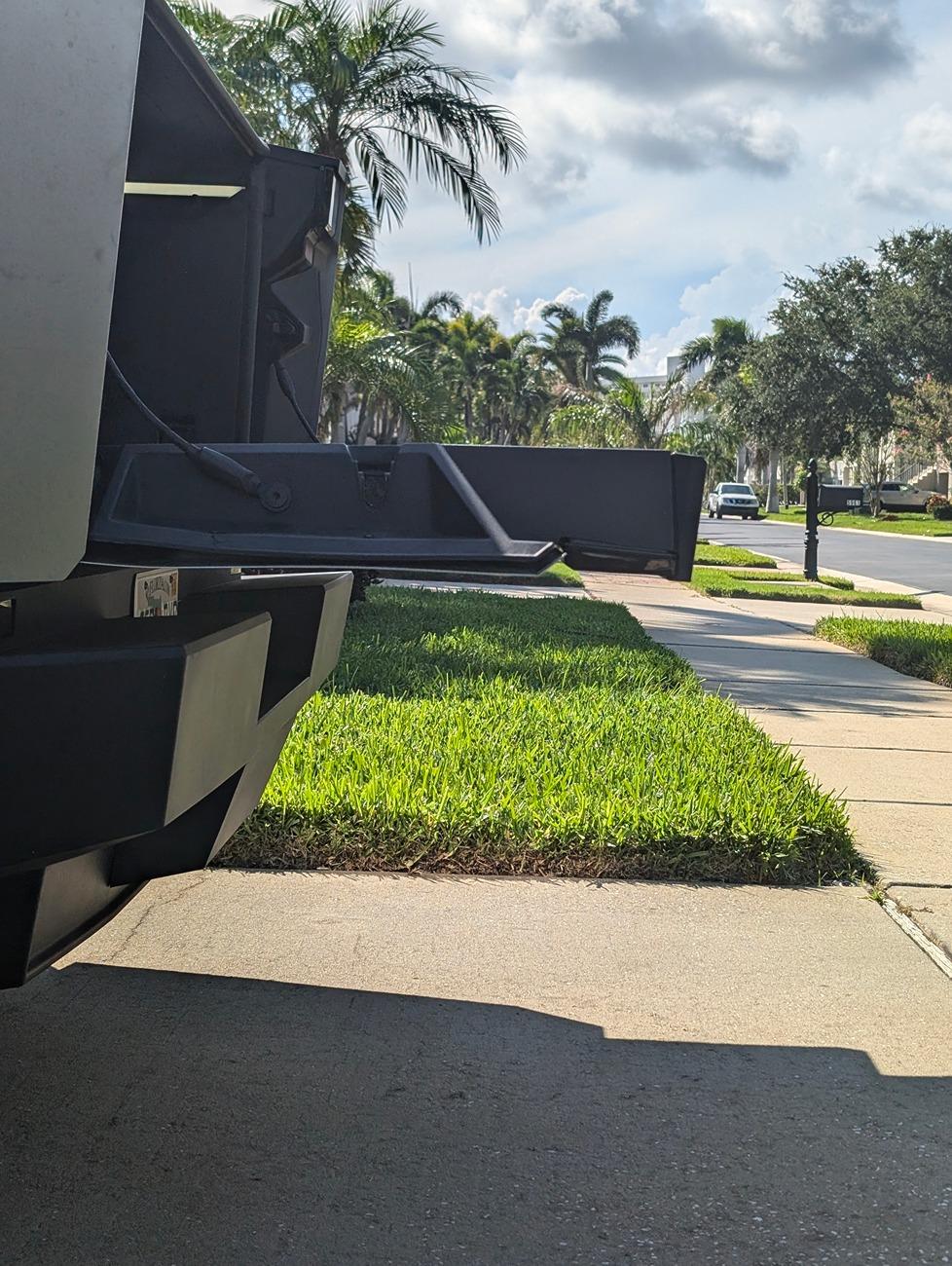

Both of mine are slack unless I push down slightly/stand on the tailgate.
And my tailgate is flush.

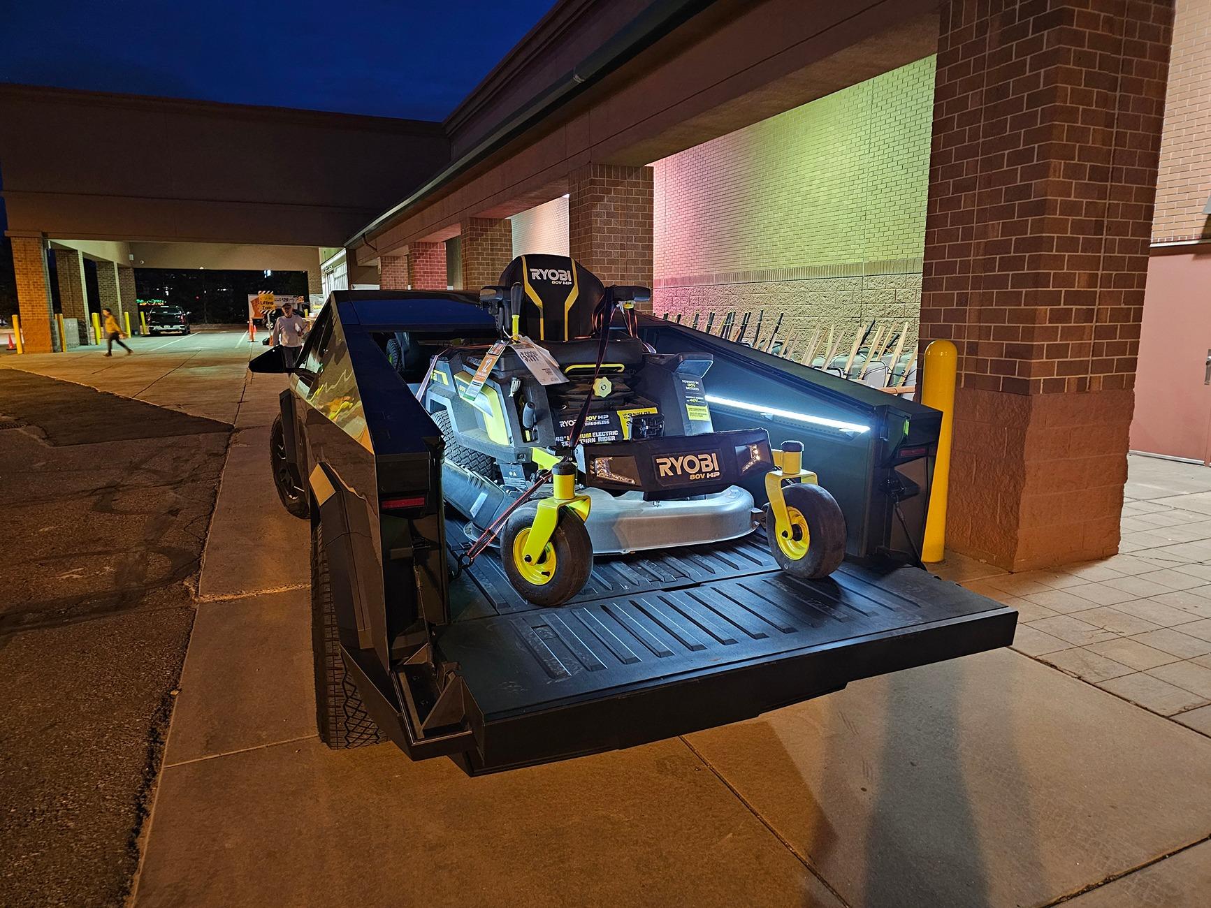

I loaded an electric ZTR mower (700lbs) with ramps on the tailgate and I don't have any bend. Both of my cables are tight when folded down (from the factory). I actually backed the truck into a ditch so that the tailgate was about 8" off the ground and kinda dragged it right off the tailgate to unload. I did check the cables before loading.

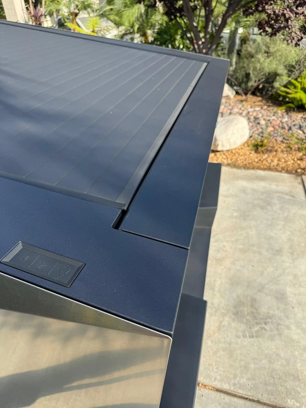

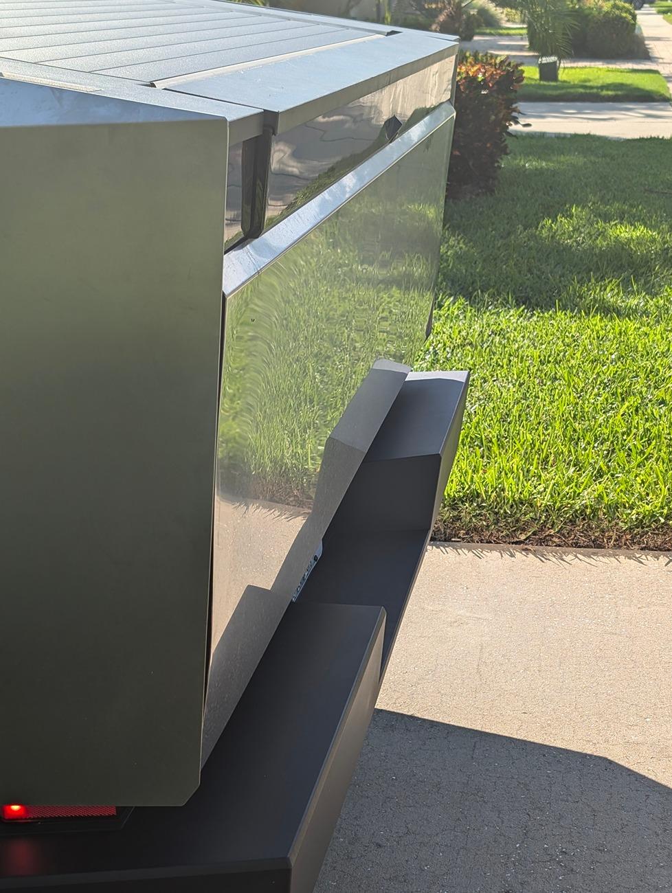

Here you go...
Yes it still functions properly. Just doesn't shut flush so hopefully it can be adjusted. Maybe I can live with it if it's simply a little bit warped.. will check on the cost for repair/ replacement.
