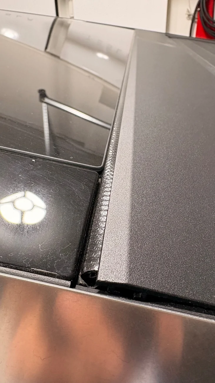

Car door edge protector and foam backer rod.
You insert that in the removable panel above the tonneau cover where the water gets in. You'll see a weather seal in there but that's not enough, reinforce it with the edge protector. I've tested it and no dust and water got in. I've washed my truck with a pressure washer and offroaded on the dirt roads and nothing got in.
Also, the seal at the end of the tonneau where it touches the tailegate? Insert a 3/8" foam backer rod in the hollow seal. It will tighten the seal between the tonneau and the tailgate when closed. I haven't tested this one but it looks like it would work.
Can you drop a photo here showing car door edge protector installed?
I get the backer rod, saw that install video
You may want to put another weather seal under where the edge protectoe would seat to prop it up more. I think without it’s fine. Try it first without the addl seal under. I already have the weather seal in there when I tried the other solution. I didnt remove it when I did the edge protector solution.
Tesla Cybertruck What features would get you to upgrade your existing Cybertruck to a newer model? IMG_2609

That looks fantastic and may be the first solution I’ve seen that would work with the cybertent and have to remove the aeroflap repeatedly. Has it really substantially improved your waterproofing?
Does it not allow the flap to sit quite flush or is that just the angle it’s shot at?
