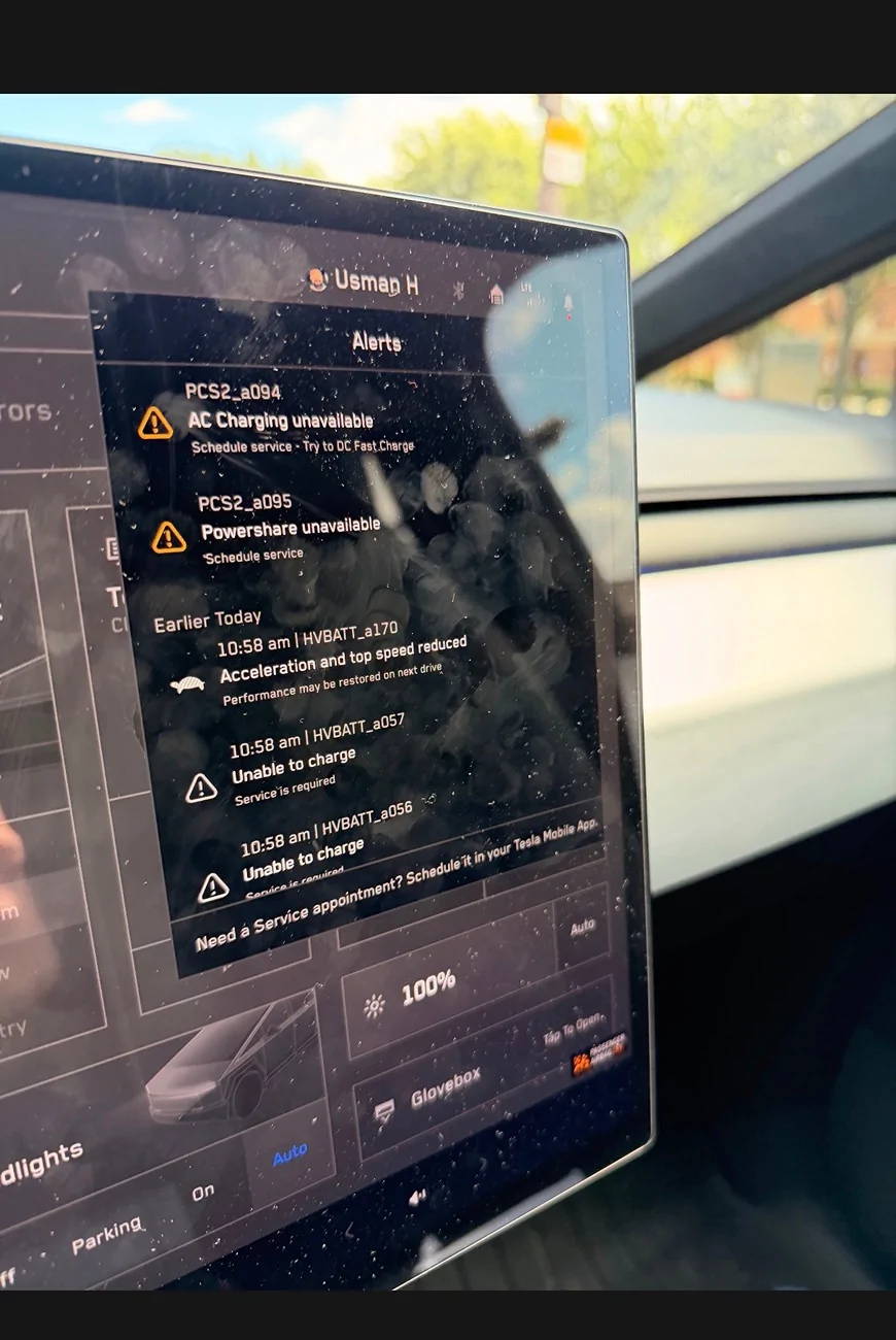

What to make of this? Tesla Service says it’s not PCS.
Uzi05
Feb 27, 2024
87
Houston, TX

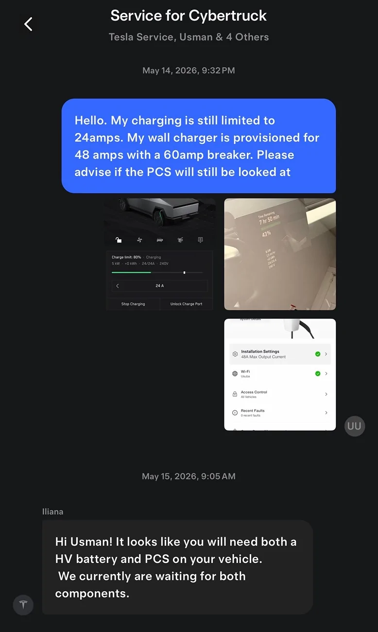

In April, I took my car into service because my car for a long time would not charge at 48 amps, I would have to drop it down to 40 amps to stay there or else it would drop down to 24 amps. I confirmed it wasn’t a wall connector issue.
They replaced some part and that didn’t help the charging stay at 48 amps. Then they made another appointment saying it’s most likely the HV battery. Then, within 2 weeks, my home charging limited to 24 amps with PCS warnings and then eventually no AC charging at all.
They confirmed in messages that they will need to replace the HV and PCS on May 12th with an appointment for 7/6.
When I came to drop my Cybertruck, they insisted that only the HV battery is needing to be replaced. I stressed to them that I’m certain I have the PCS issue that every Cybertruck is having right now. But they are saying they’re sure it’s just HV battery and my truck does not have PCS issue.
Luckily, I have a loaner now because only supercharging when the closest ones are 30 minutes away has been a huge pain.
I’m just disheartened and venting at this point. Why are they not just fixing the PCS? I see everyone else getting there’s done. I clearly have the same issue.

If service mode doesn't have the cyclo health alerts, it not the PCS. 40A charging is a different failure than the DCAC sub-module fault.
They should verify AC charging before returning the truck.
I do have the PCS warnings. Still they insisted now my truck doesn’t have the PCS problem 🤷
The HVBATT errors could be causing the displayed PCS charging fault (whereas PCS wouldn't cause that HVBATT fault). The key indication for PCS based charging failure are the DCAC health faults in service mode.
Wow, thank you for the reassurance sir. I hope I do get AC charging back at full 48A after the HV battery replacement. They said it’ll be about a week.
Oh 🤦‍♂️my little grey cells just reminded me that a pack swap includes the PCS (along with everything in the Ancillary Bay)

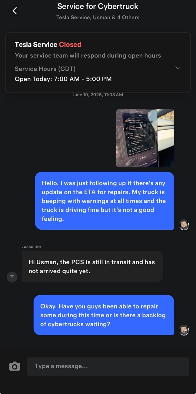

Not the answer you want, but they don't have the PCS parts, big backlogs, so they are delaying/pushing those repairs back as far as possible.
They won't touch it until home charging is completely not working because the trucks will just sit at the service center for weeks/months waiting for PCS parts.
