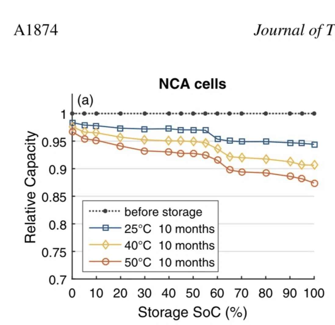

If you really want to get educated on the subject, there’s a thread over on TMC “Range Loss Over Time, What Can Be Expected, Efficiency, How to Maintain Battery Health” but brace yourself, it’s 322 pages over 4 years lol.
The TL;DR is that cells age with cycles, but far more by just sitting there (“Calendar Aging”). The lower the SoC in storage, the lower the degradation.
From this chart you can see that capacity drops over time, and faster at higher SoC. Note there is a significant decline between 50% and 60%, so that’s where your greatest advantage is. It also gets steeper from around 80% to 100%.
It’s fine to top-up when you’re about to drive, but store it the lowest value practical (down to about 50%). That’s where I keep mine, as I don’t use more than around 15% per day typically.
There is also lower degradation with smaller Depth of Discharge (DoD) so you should charge daily rather than running all the way down and filling up.
Of course, you could charge to 100% all the time and still be unable to hit the 70% capacity limit in 8 years that would trigger a warranty replacement, but you might miss the 20%+ of range you lost.
Also, don’t be alarmed by range loss in the first year. The cells have a break-in period and degradation will slowly subside.
I've looked at this graph many times and catch myself making the same mistake.
This graph does NOT show "over time" It only shows at 10 months.
And it shows that there's only 1% difference between 60 and 100%.
And since you can't set the max charge below 50%, it really says that the charge level doesn't matter.

10,319
34,199
I consider 10 months to be a time period.
I don't think you understand "percent".
It matters. Like, a lot.
Woodrick
Ed
Dec 30, 2023
4,786
4,762
Gainesville Ga
Consultant
Yes, it is a time period, but your statement of "over time" suggests a more continual process. For al this graph shows, it may have dropped to that number on day 2.
I absolutely understand percentage.
At 70%, the percentage loss was 5% (1-.95 on the graph)
At 80% it was 5 percent
At 90% it was 5.2%
At 100% it was 5.8% (or close)
Between a SoC of 60-100%, there's less than a 1% increase in loss.
The difference in degradation between keeping the battery at 60% and 100% over 10 months is SIGNIFICANTLY less than taking the wheel covers on a Model 3 off. Even the degradation is less than the wheel covers.
What is effectively says is that, in a Tesla, (which limits lowest max to 50%) the max setting is basically irrelevant at where you put it.
We know that Tesla has other recommendations. It just says that the batteries used in this study are not the same as the ones that Tesla uses.
Batteries are different. In some areas significantly different. Using case studies for other batteries is not an accurate representation of the batteries in a Tesla.
