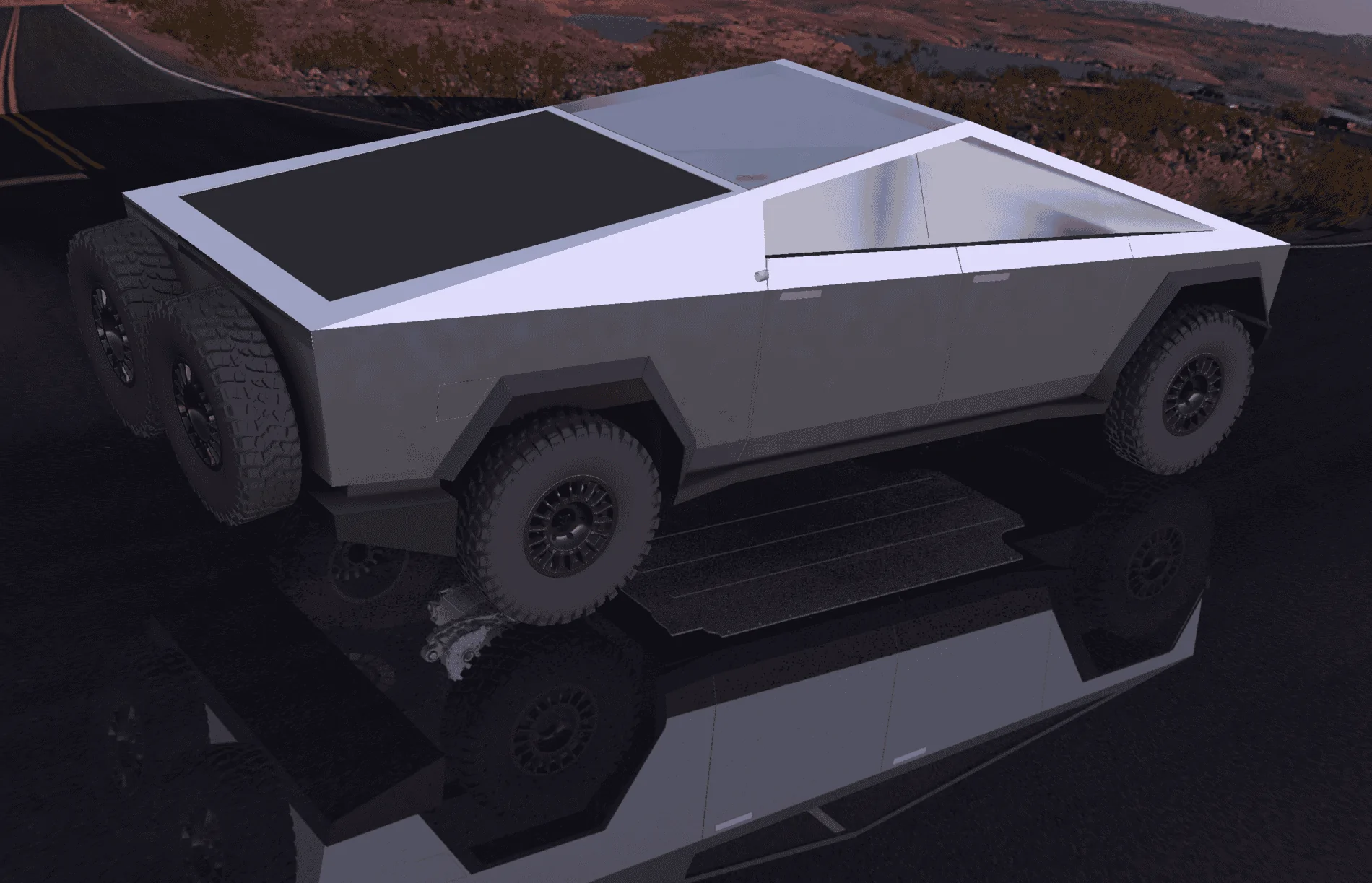

According to my CT CAD drawings there isn't enough space behind the rear wheels and rear electric motor and drivetrain (from the M3) to fit a spare the same size as is on the prototype, without reducing the rear departure angle. Even then it's close to the rear bumper and would need some fancy engineering to support a tow hitch. You can see the underbed spare in the reflection along with the motor in the below photo. BTW that's a model s battery pack underneath for scale as well.
Sadly I think the only way to have a spare onboard will be third party accessory rear mounted spare option like this:
Tesla Cybertruck Will the truck come with a full size spare? Spare Wheel Options
Also a standing spare in the front of the bed probably won't work for a 35" tyre under the vault cover as this is the maximum height of the front of the bed. It tapers down to the back of the bed to 24".
As for remote areas in the outback and cross country driving, a spare is a must. A tyre that size is also un-common and would likely not be in stock at a local regional dealer, resulting in 2-3 days of waiting for a spare to arrive.
As for alternatives: having onboard air helps together with a puncture repair kit and tyre foam can would keep you out of trouble for some of the most common tyre failures. Failing that some bead lockers will give you run flat capability depending on the tyre you use.
