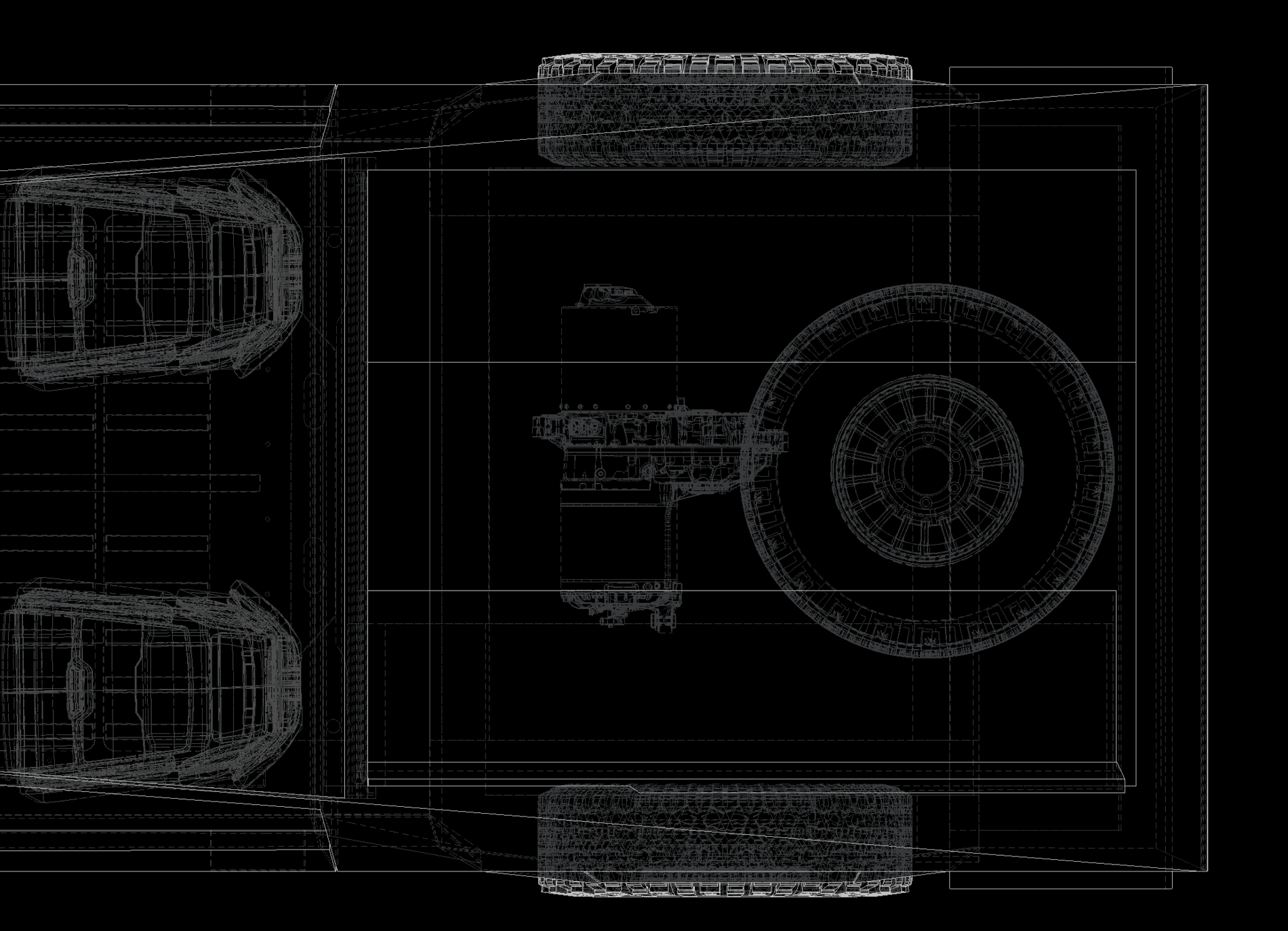

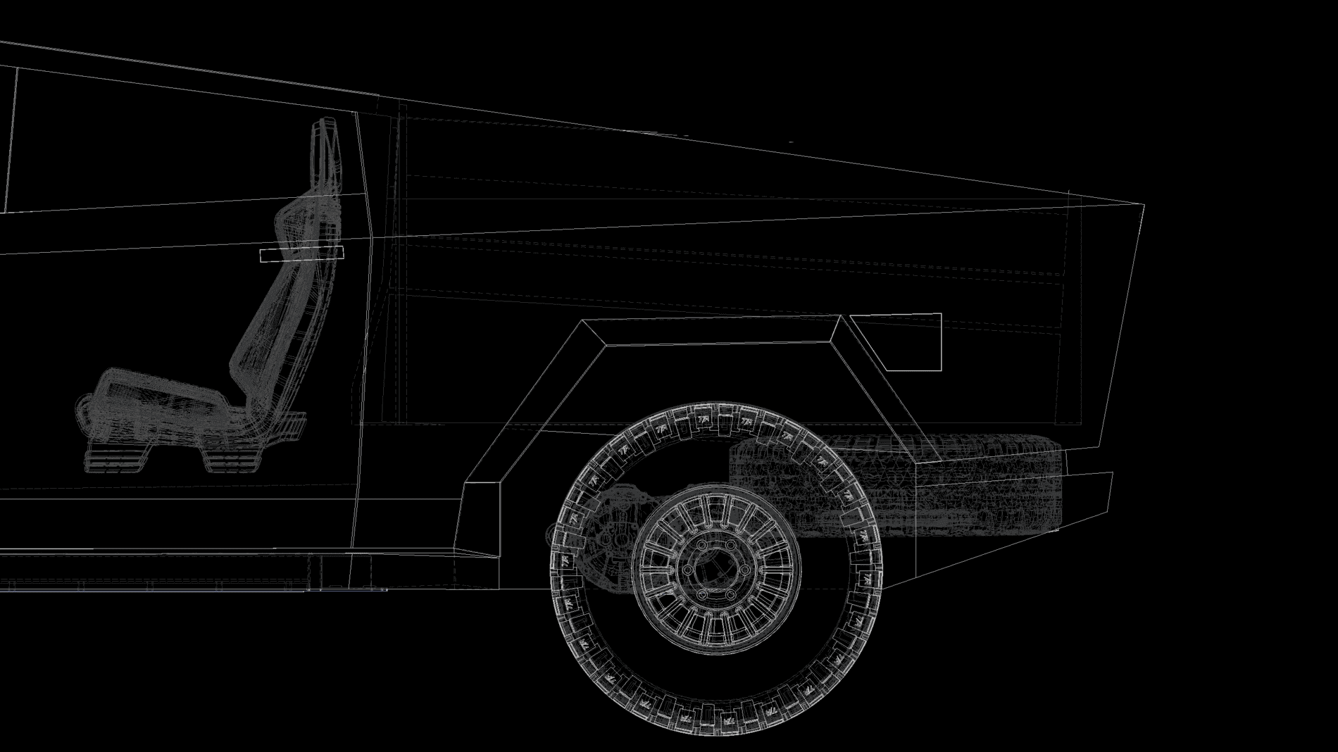

It seems to me that most people posting here have not mentioned storing the spare in or UNDER the frunk. Have any of you with CAD (or other similar) skills tried to fit a full size spare there?
I'm wondering if the bias about this is because we've been conditioned for decades with "you can't put a spare there - it's where the engine goes!". ;)
I tried putting the spare in the frunk of the CAD model before. It does work if you have some sort of draw that slides it halfway under the dash. But its not a good spot for absorbing crash energy. Plus I'd rather have a large frunk for tools and luggage.
They just need to jiggle the wheelbase and rear bumper design 4" or so. A rear draw that comes out the bumper mid section would be perfect. You could then make the spare optional or remove it as required for more storage...or even use it to support the tailgate to extend the bed and move some bumper lights back.

I think the whole spare vs storage was probably a big discussion when Tesla engineered the Cybertruck. Some people want a spare, some people want more storage. It'll be impossible to make everyone completely happy.
One of the biggest issues I have with my truck is there just isn't enough non bed storage. I've got a container mounted in the bed but it's not that big so I still have a decent size bed. Other than that, I've got a glove box. If Tesla decided to altar the Cybertruck a bit to include a spare, at least we'll have a vault and Tslot/Ltracks in the bed so we could customize things however we want for storage and it should still be easily removeable. I personally lean a little more towards wanting tons of storage rather than a spare.
I agree that you can't have enough storage on a truck. I went back to my CAD drawing and really the best solution would be to have a rear draw behind the bumper. I saw an option on the first page of this thread, where if the motor assembly/casting would be low enough you could have a full bed length draw up to the vault cover roll. That way you could have the spare over the motor, and still have that "underbed" storage as a pull out drawer. Much better than having to dig under your bed load.

But after looking at the CAD dimension there's not really enough room there for a full length drawer, unless you make the bed higher, which is not what you want. There's also an issue of mounting the suspension arms structurally somewhere with the tyre in between, But it would be enough to make a drawer for the spare just behind the bumper up until the rear motor, where you could take the spare out, or option it without. That underbed storage is a waste of space IMHO if you can't get to it with something in the bed.
I'd like to see the wing storage and frunk. The frunk could be quite large there's about 1.5m³ (52cf) of which about 1000l (35cf) could be useable even with the motor underneath and up to the firewall. Question is where the cooling will go etc for the aircon and batteries (if it has any with 4680s). It would be really nice to see the front grill go up with the hood, that way you could have a slide out drawer there too that actually goes under the very long dash inside, without having to reach.
One thing I also noticed is that the wings/rear wheel arches are not very wide, and because there are no wheel arches inside the bed you will be quite limited on what width tyres will fit in there (it actually needs those wheel flares to keep the tyres "inboard". But wide tyres aren't great for an EV and providing they do the 35" without a ridiculously low profile tyre it will be fine off road too.
P.S. that drawer would also make a good slideout kitchen to rival Rivian.
