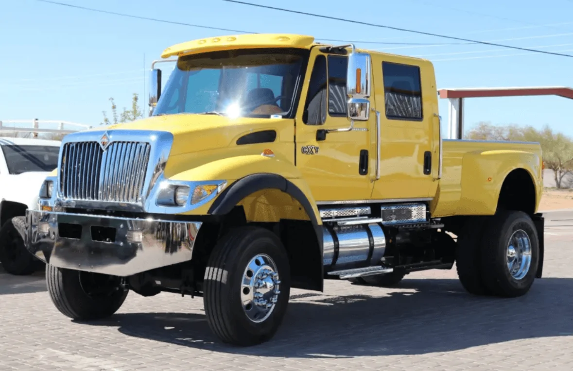

Allow the rear wheels to turn at a larger angle than they currently can. Let them turn as much as the front wheels do and now you're still pretty darn maneuverable. You also have room for 2 more feet of battery pack which adds up to quite a few kWh I'm sure.
Every few degrees you add to the rear steering, you take inches off the width of the bed - doubled, because both sides.
I don't see much overlap with the Semi because as an ordinary driver I have no use for a semi truck, but I could make plenty of use of an 8 foot bed. In my mind the only thing you're giving up here is the ability to park it in a garage, something that most truck owners don't do anyway.
That's because you are thinking like it's an ICE vehicle, not an EV. It's just a platform that has torque and speeds at certain loads. Unlike an ICE drivetrain, it's not specialized to certain narrow use profiles - electric motors have broad, overlapping curves instead if narrow bands. And under loading them you don't waste much energy as you get back in reliability.
The original Semi prototype was just four Model 3 motors. The current one is similar to the Cybertruck, just a little larger with a physical clutch and single gear.
You want a long bed, you want long range, you want high load capacity you want reliability... the Semi platform does that already.
You don't need a Semi, but that's what it takes to go that range.
I see what you mean. A truck body built on the semi platform. Now that’s a great idea!

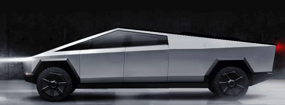

Tesla Cybertruck Would you be willing to give up 4" of headroom for more range? 1703002019927
^^ This.
With that design you'd have less of an angle on the rear slope of the cab, giving more headroom in the rear seat as well.

The thing I dislike most, like in the MY, is that the glass is hard on impact over bumps. Could of all been solved by moving the apex back a bit and making the tailgate a but higher.
Doing the opposite and making it 4" lower to get more batteries in is just silly talk.
It then simply becomes a 2 seater.
