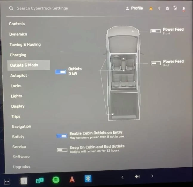

Curious about the "Power Feed" in the Frunk as well.
Wonder if it will be
  • Low Voltage +/-12v or
  • Mid Voltage +/-48v <--------------
  • USA Voltage +/-120v
Tesla Cybertruck Roof Auxiliary Power Tap / Power Feed Specs (48V) 05) Outlets & Mods - Cybertruck Controls_ Our First Look at Tesla Cybertruck Center Screen Co
05) Outlets & Mods - Cybertruck Controls_ Our First Look at Tesla Cybertruck Center Screen Con...jpg
same question here. have we seen a photo or video of said power feed in the frunk? Still sort of salty that they didn't put in a 120V in the frunk. the more I think about it the more it'd be nice to have as an option even though I'd use it like once a year

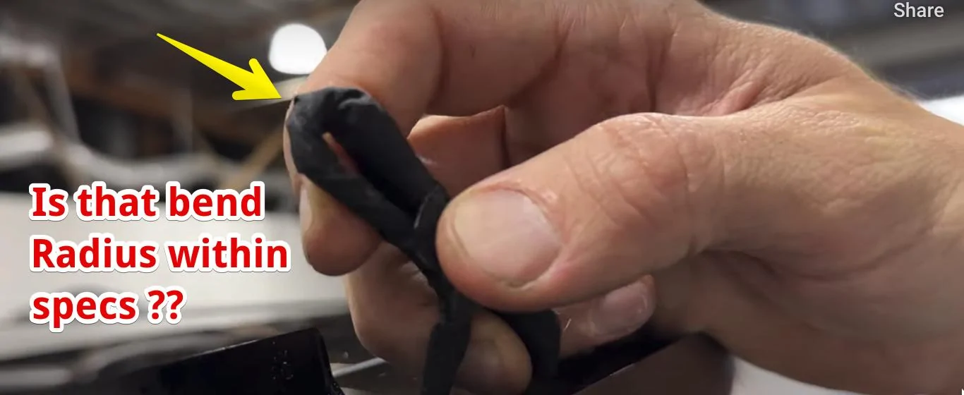

The bend radius of that cable seems over the minimum allowance.
Roof Auxiliary Power Tap : Power Feed Specs (48V) | Tesla Cybertruck Forum - News, Discussions...jpg
There are no bending radius rules in the NEC for single conductors 1000 volts or less.

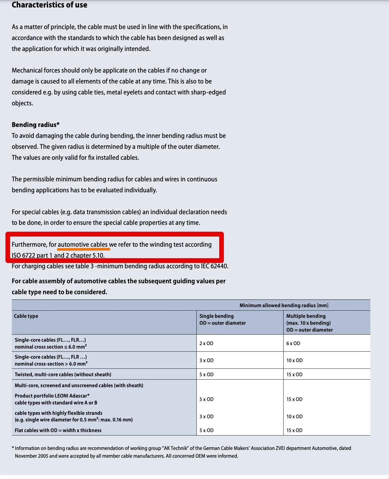

Still doesn't stop the bending from fatiguing and possibly breaking the wires.

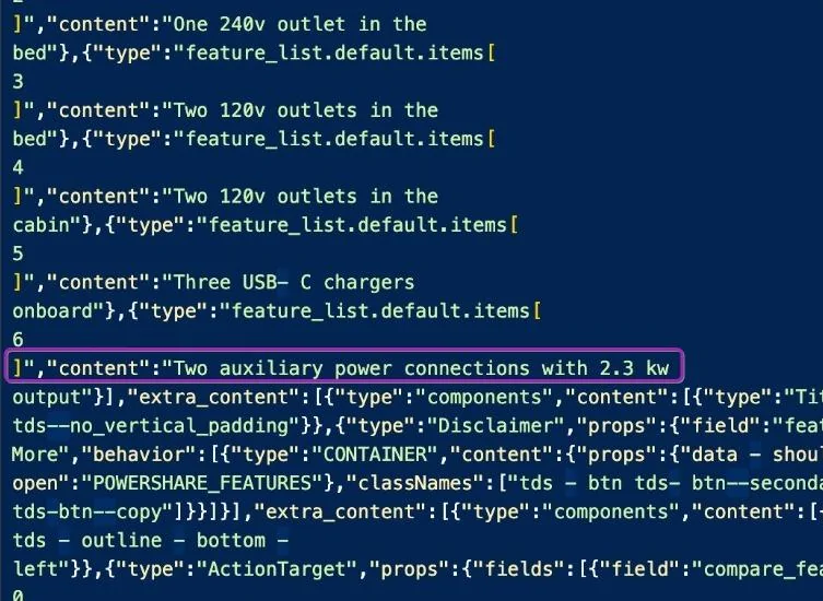

Also looks a bit thin for 2.3kW at 48V, so 47A. Is there another one maybe?

I haven't seen anything else yet. I should really have a look at it better to see if there's anything bidirectional or similar. Or anything relating to solar/MPPT.
There is a claim of 400 watts for the frunk in the latest T-Sportsline video. Next post.
(400 watts) / (48 volts) = 8.3 amperes

They claim 400 watts for the frunk in the latest T-Sportsline video.
T Sportline: "Confirmed with Tesla, both [roof | frunk] auxiliary power taps are rated to 400 watts. Both are protected with solid state circuits, if you exceed 400w, they shut off."
