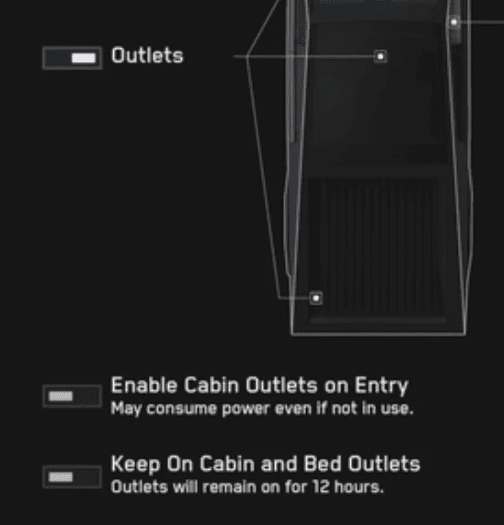

I have a cutoff switch with a NEMA 14-50 plug that I usually plug into an ICE generator during power outages. This time I plugged into the CT, turned it on with the app and "no fuss, no muss" the house had power, including the well. It used about 1% per hour through the evening.
We have propane for hot water and heater and, except for the refrigerator, we didn't run our appliances much. Not hearing the generator is delightful. It did turn off after about 10 hours, don't know why, and I turned it back on from the app without any drama.
