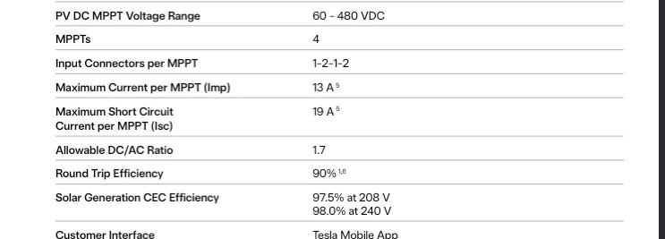

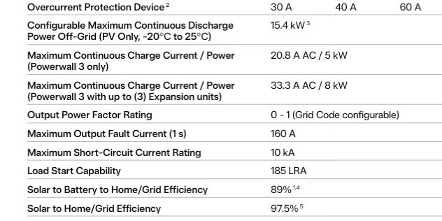

The Powerwall 3 allows a DC coupled system which wastes less solar energy (97.5% solar to home/grid efficiency). Each Powerwall can connect directly to 20 kW of solar panels with it's 6 independent MPPT's and inverter built into the unit. Without external inverters the system design/install is a bit simpler. Here in the PNW I wanted to maximize winter production for self-reliance and the DC coupled system does that.
