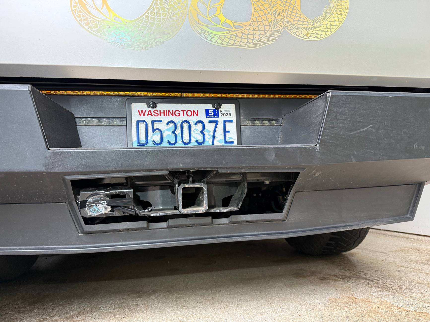

I needed some back up lights that would show over the top of my receiver hitch plow. I also wanted to maintain the stock look and wiring.
I started with this ACI 39" BACK-UP LED LIGHT
https://shop.agricover.com/product/backupledlight
this is the light strip just above the license plate in the below picture.

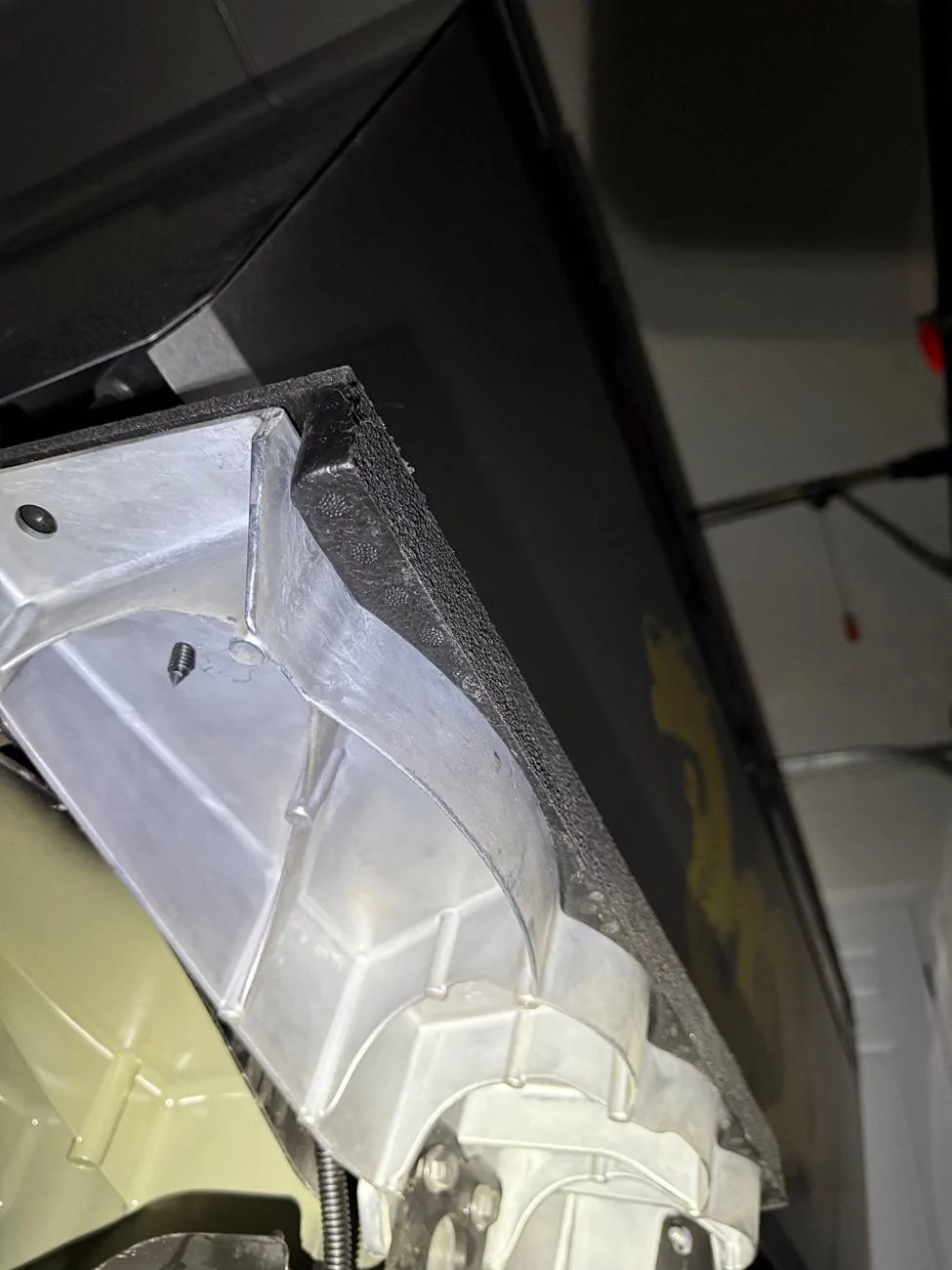

By the way, this is what the energy absorption of the bumper looks like.

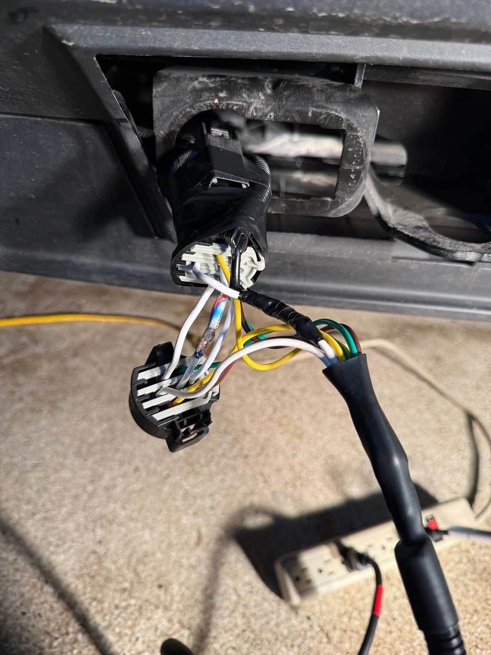

To maintain the stock wiring, I used a 4-Way Trailer Wiring Harness with 5 ft Wires 4-Pin Trailer Wiring Jacketed Cable 4 Flat Trailer Wire Extension Connector
https://www.amazon.com/dp/B08BNBZR4T?ref=ppx_yo2ov_dt_b_fed_asin_title&th=1
I just tapped into the reverse wire and ground wire of the pigtail. Didn’t use the four-way trailer wire extension.

I was worried that tapping into the trailer connector would cause a trailer to be detected and bugger the FSD, but it doesn’t seem to know.

This is a good walk through, thanks! It doesn't take much, any amount of extra light even reversing is a great upgrade.
I was thinking of doing something like this also. I personally would want it on its own switch instead, but great idea.

Good job, I'd like do something similar as well. For me the reverse camera is too week in the dark, maybe my aging eyes.
It's not just you, the reverse camera + lights at night are pretty weak.

Looks great OP, I always thought another brake light would be helpful too. Current setup I feel drivers dont understand I'm braking.
The towing that I've done in two Teslas are sensitive to the weight of what you are towing before they affect AutoPilot. Light trailer was fine if you used modest speed and braking. Heavier 12x6 U-haul kicked it off right away.
lol, guess they found a use for that millions Of Dollars mega cast machine from France that they stopped using.

One strange thing I recently noticed. When the car is on, the backup light strip blinks with very low power, barely discernible in the daylight. I'm interested in theories as to why it would do that. This is wired in to the trailer backup light circuit. Once the car goes to sleep, the blinking stops.
