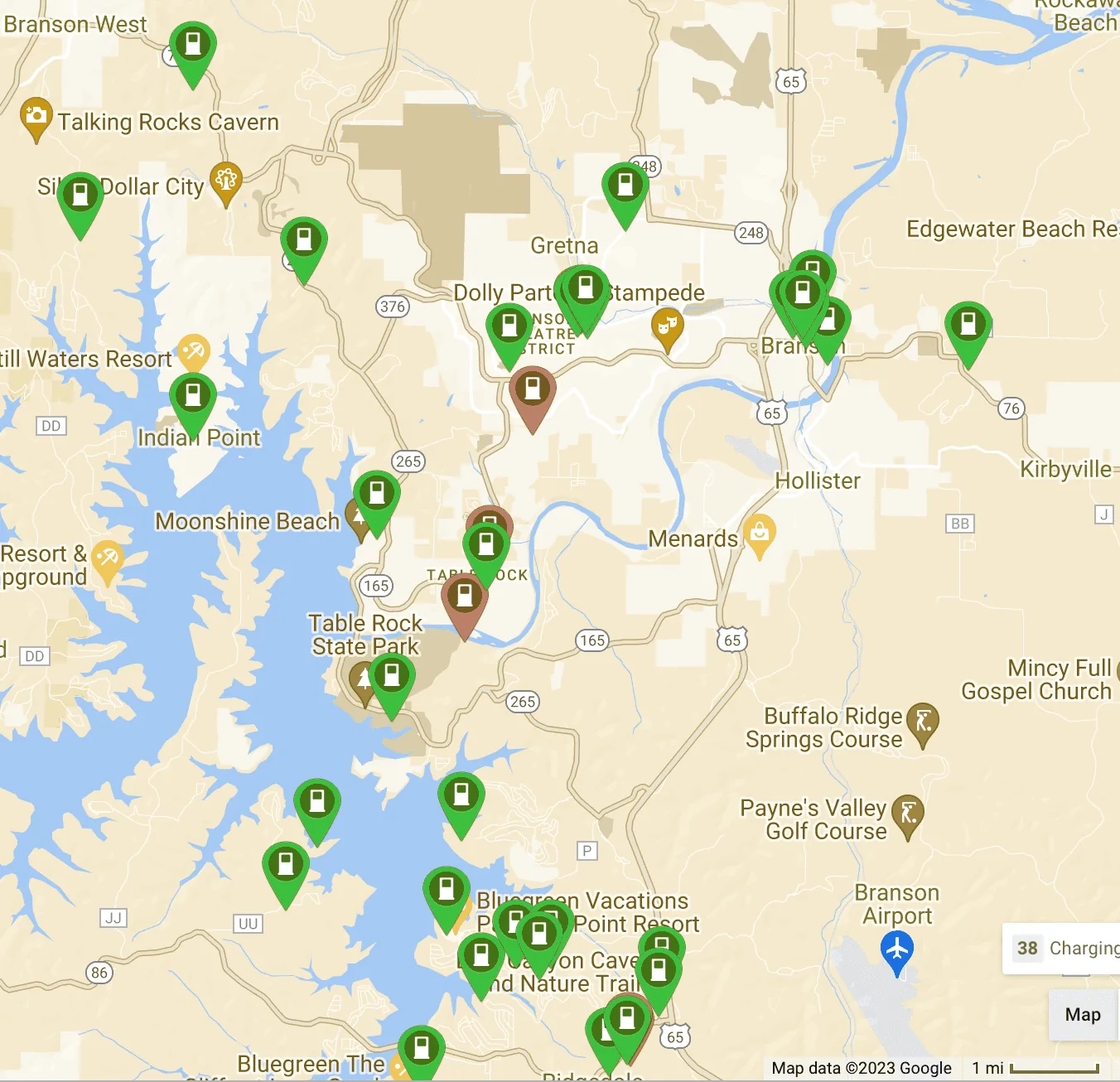

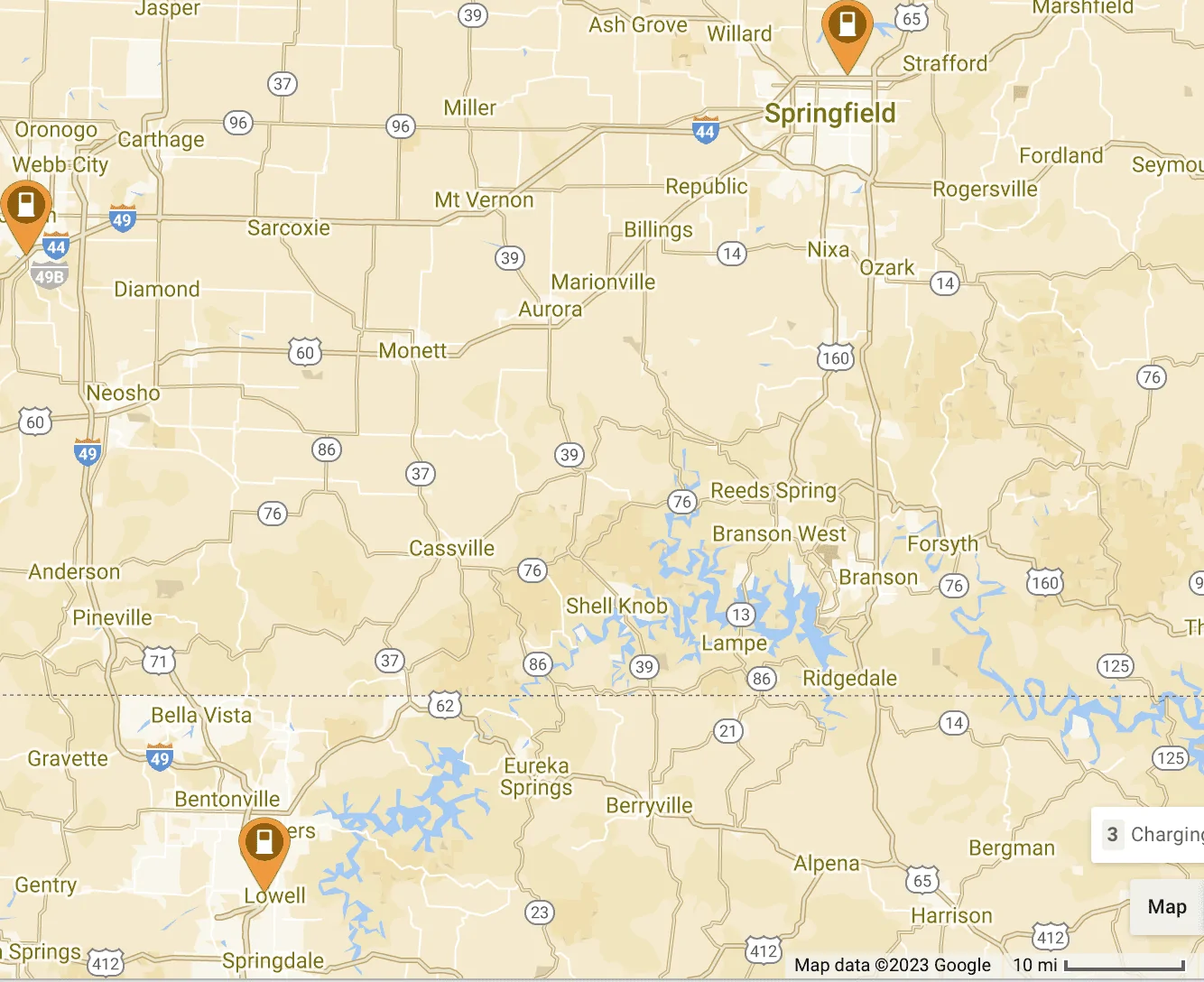

There are three Superchargers within 100 miles of Branson, and several Destination chargers inside of Branson. Lots of Level 2 charging.
See, the thing is, you drive through towns with Superchargers, and sleep in places with Level 2 charging. Then you go further.
Not that there's alot left that's more than 100 miles from a Supercharger, especially if you're willing to take the scenic route. Which is, in this case, the shorter route.
Who wants to use a Level 2 charger? I don’t. The super chargers top the list of reasons to get a Tesla.

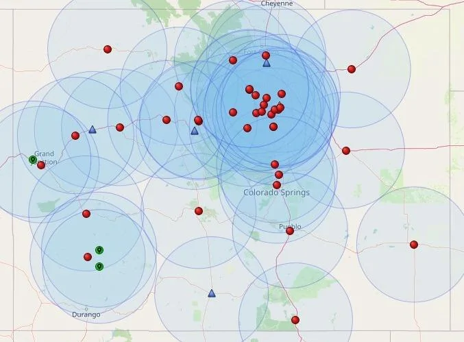

Colorado ... radius 50 miles:
Tesla Cybertruck 350 mile range Quad Motor rumored to be 1st trim launched I3vqASn

~70% recovered by regen in my TMX.
Can you please post a link to the source of the map? Would be interesting to have for our next trip next year in the States to pickup the CT.

Sorry. It is the crowdsourced (Patreon supported) site: https://supercharge.info/map . It is fantastic to watch the changes page over time: https://supercharge.info/changes
I used filters just for CO, then used the round "target" icon to get the "range circles" and adjusted the radius to 50 miles.
I'd add to this another level... fastcharger.info. That is the CCS quasi equivalent of the site. We don't know the number of sites that will move over to NACS, but it will certainly be some. We can assume though that with a cheap adapter, the Cybertruck will be able to use CCS chargers. They may not be the best or fastest, but 62+kW CCS chargers are everywhere in Colorado. Canon City, Woodland Park, and Buena Vista all have 62 kW chargers. Alamosa has a 200 kW station today. I'd really like to see Tesla expand there (and central Wyoming), but as it sits today, there are already options to charge. You just might be stuck with 62 kW in some areas.
