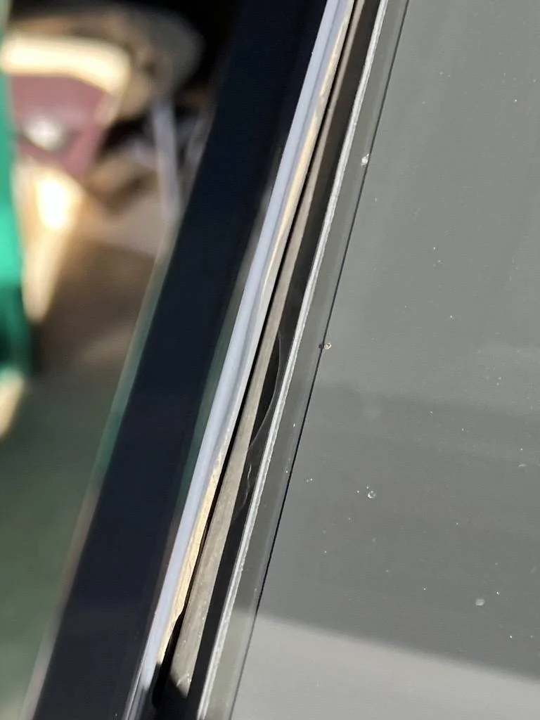

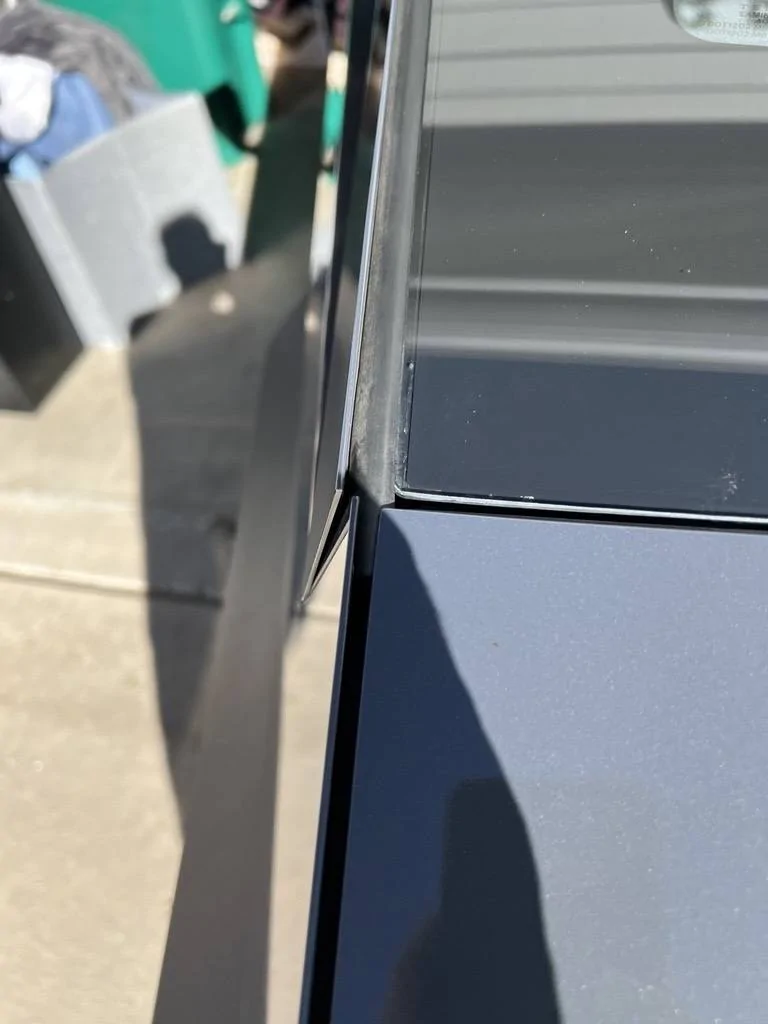

While cleaning my CT I noticed that the front trim pieces that go over the doors are starting to detach like other reports.
I took a couple of pictures and have a scheduled service with the Springs location 3-3-25 (delivery of parts or would be sooner).
They informed me today that they will be replacing both parts under warranty.

Tesla Cybertruck PSA check your CT: loose nut front trim pieces detaching - Service Scheduled - Resolved Front trim delaminating
Tesla Cybertruck PSA check your CT: loose nut front trim pieces detaching - Service Scheduled - Resolved Gaps in adhesive installation

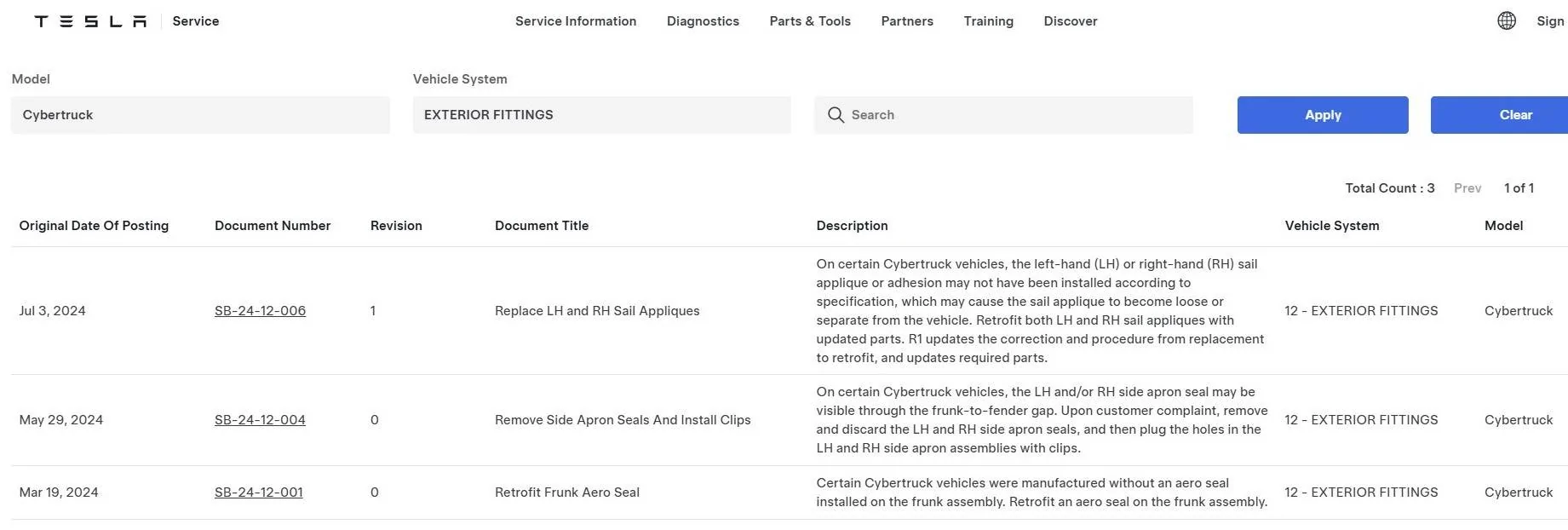

There was a detailed video on it talking about the loctite, fixes, etc aspects in 8 months ago!
Title: Inspect your Cybertruck Cantrail Panels - Mine was Loose
8 months ago - June 2024
