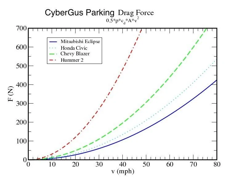

I’ll finish with a cartoon-simplistic reiteration of the scenario:
• at EPA testing conditions, the ICE F150 that has only 12:8 gallons ma in its tank has a max range of 320mi, unladen
• speed effects drag exponentially, so, e.g., a vehicle traveling at 80mph experiences 4X the drag experienced by a vehicle at 40mph
• vehicles, like trucks, with larger frontal planes, experience greater drag than smaller vehicles, like sedans - exacerbating the effects of speed on drag
Tesla Cybertruck 40,000 Production this year prediction 8BE5E34D-FB88-4045-AB8D-F18774303CE1
• at optimum EPA testing conditions (including 48mph average) the ICE F150 has a max range of 320mi, unladen
• if you take that identical ICE F150 and instead run it at 75mph on the highway continuously, it experiences ~3-3.5X the drag as when it was EPA-rated at avg 48mph
• so at continuous 75mph, that ā€œ320mi max rangeā€ F150 with 12:8 gallons of fuel in board now achieves materially less range - let’s call it 220mi max range, unladen, merely because it’s going faster and so experiencing 3-3.5X more drag
• now take that same ICE F150 at 75mph continuous and reduce its tire pressure by 1 psi, range hits further
• now take that same ICE F150, and decrease air temperatures, the air is more dense, and drag increases, range hits further
• now take that same ICE F150 and make the cold air dry (not humid), air is more dense, drag increases, range hits further
• and after all that, now attach a 7,000 lb trailer that increases not only rolling resistance but in terms of drag may as well be a parachute out back, and run it at 75mph, etc., and the end result is that unladen <220mi max range is now cut in half due to the parachute trailer out back
all the above is equally true if instead of the F150 you substitute the Lightning
put differently: go talk to my grandfather, and tell him you have an ICE F150 with 12.8 gallons of fuel in the tank. Next tell him you’re surprised and upset that you hooked a 7,000lb breadbox RV up, ran it at 75mph in 50° weather, and ā€œonlyā€ got 90 miles down the road. Then wave your hands excitedly saying ā€œbut the EPA said I had 320mi of range unladen in ideal conditions!!ā€
my grandfather, like anyone else familiar with towing effects on range, will look at you like you just arrived on our planet and are experiencing physics for the first time

Now do it for 75mph!
Aero = 1/2 ((0.002377) (110))^2 (0.4) (40) = 230.09 Ft Pounds, or (230.09)(0.001989) = 54.69 KwH
That's (0.5) x (coefficient of air times velocity in feet squared) x (drag coefficient) x (surface area of entire system) ---- surface area is if you looked at the CT and trailer head on and figured the size hole it would punch through a wall as it drove through...
Rolling resistance =Total weight x 0.015 = 13,500(0.015)(0.001989) = 40.27 KwH
That is (weight) x (coefficient of rolling resistance of a tire on pavement)
Gravity: 0 KwH (only comes into effect when traveling UP HILL on average meaning your ending point is higher than your starting point and for this example, it isn't.)
Taking the math above and add those three forces together and you get a requirement of 86.03 KwH to tow a 7,000 pound trailer 100 miles at 75 mph. This means we should be able to haul a 7,000# trailer 157 miles with a 150 Kwh battery pack in the CT.
To figure out other speeds, replace the green number with the answer to this equation:
1. Multiply (0.002377 x 5280 x your speed and then divide by 60 and then divided by 60 again)
2. Multiply that answer by itself.
3. Multiply that answer by 0.4 x 40 x .5 x 100 to get the Aero hit you take for the speed you are going.
4. Add your final answer in #3 above to 40.27 to get the total KwH you'll use to go 100 km on a flat plane.
5. Divide the battery size (I think it'll be 150 KwH) by the answer to #4 and multiply by 100 to get the total distance you can travel on a fully charged battery.
