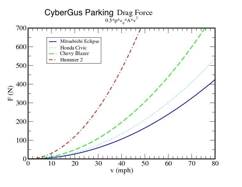

Keep in mind that we are talking about interstate speeds. Drag/wind resistance is the biggest factor.
Which is why the following chart (joke title aside) looks the way it does:
Tesla Cybertruck 40,000 Production this year prediction 44E1553D-9340-46BB-9E4C-0F211D2ACCC6
the increase in Cd, times the increase in A, at higher V-squared, means that
compared to the Model X as the CT approaches hwy speeds it will become subject to exponentially more energy required to counteract Fd
rolling resistance is a separate matter, but here again weighs against the CT, on the basis of not only weight, but also tire types/materials (given the CT’s payload rating), and tire size (massive in the CT)
At 75mph, the CT will be materially less efficient vehicle than the Model X in terms of both Fd and rolling resistance
not because anything’s wrong with it, but because it’s a truck
