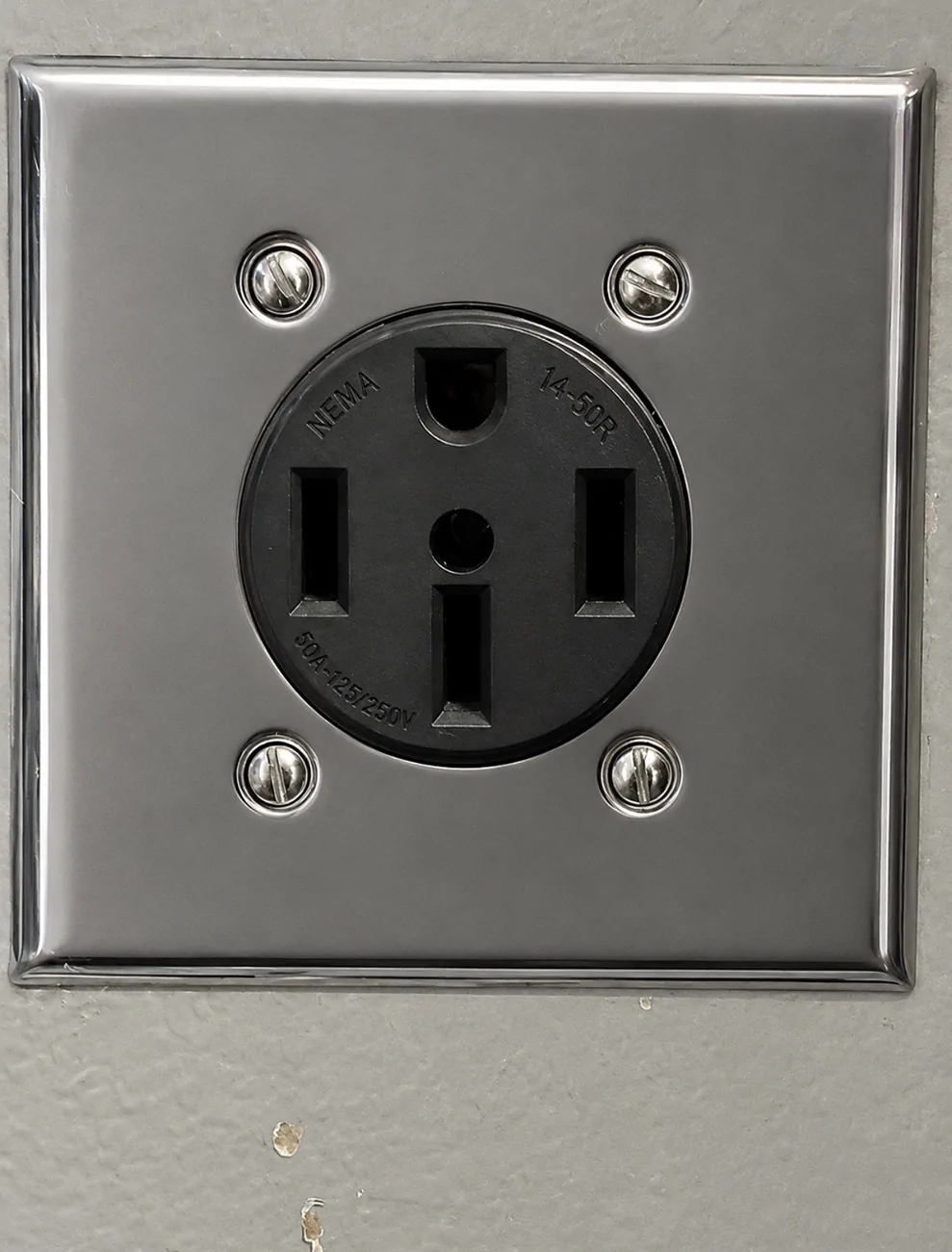

Nice.
Did you already have a 14-50 outlet, or installed just to charge your car? Also, do you use the evdance unit because it gives you 40A or any other reason?
I installed (Bryant- same internals as Hubbell, but more affordable) 14-50 for car charging. I like the Evdance for the faster charging. I leave it available at home all the time and generally leave the mobile charger in the car for occasional use elsewhere. I added a TT-30 adapter to my mobile kit as it is useful at many State parks and campgrounds. The Evdance has its own app for scheduling and charge rates and such, but I never use it since I am making my own power and can control that stuff through the Tesla app as well.
