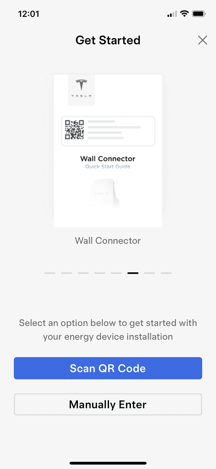

FWIW, I was able to DIY install Gen 2 and Gen 3s wall connectors. For the last install I used the Tesla One app which is for professional installers but worked great for me as I was able to configure everything. My guess is that would also work for the universal connector. Enclosed is a screenshot of the product install page.
Tesla Cybertruck All Foundation Series owners will receive $2,500 voucher for Tesla Shop (to purchase Powershare Home Backup Equipment or other products) IMG_0238
