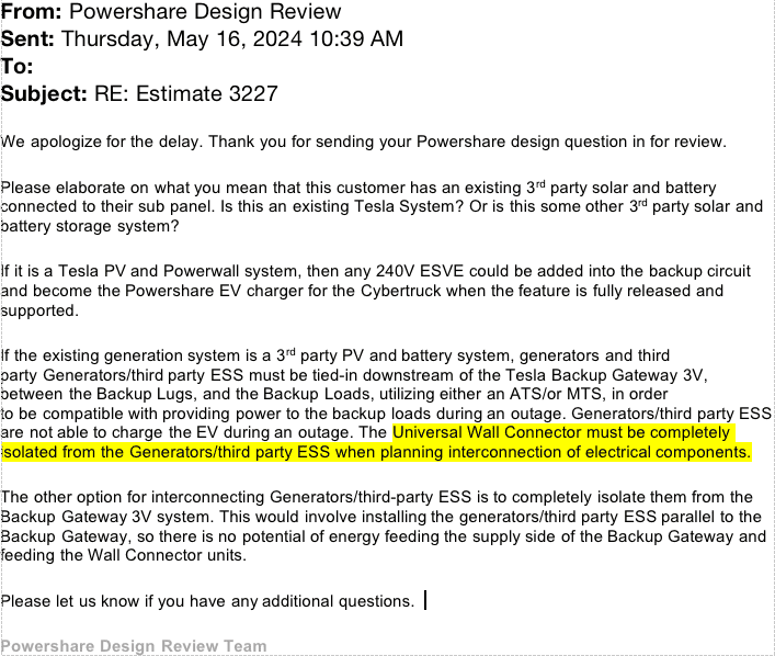

That's a great question, to which I do not believe has been addressed anywhere that I have seen.
Here is what the Powershare Design Review Team said in response to my question to my assigned installer:
Tesla Cybertruck Anyone Decide Not to Install PowerShare? Screenshot 2024-05-16 at 1.54.12 PM
So, Powershare will backup your house during a grid outage as long as CT's battery charge is more than 20%. Excess solar power cannot be used to replenish CT's battery while the grid is down. Of course, when grid power is restored, one can recharge the Cybertruck using the UWC or mobile connector as usual.
