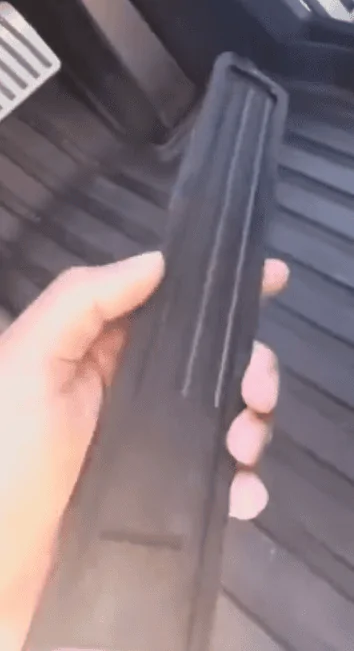

The cover is just thin metal bonded to the plastic pedal with adhesive. There is no back bevel holding the cover on, I just inspected the pedal in my Cybertruck. Therefore, if it slides forward, as depicted in the TikTok post, there is no way it could hold the pedal down, against the spring tension.
Aren't there side channels in the pedal cover that grip the side of the pedal when it's slid in place?
Tesla Cybertruck Brake Malfunction; hit light pole 1713194719770-js
10,348
20,797
I think you might be right. You made me inspect it again, this time with a flashlight in addition to my inspection mirror. It looks like it might slide on into some grooves molded into the sides of the plastic pedal. It definitely doesn't wrap all the way around the backside of the pedal, but there may be some captive grooves. I tried to slide the pedal cover up but it wouldn't budge, so I can't be sure.
Still, if that's the case, it makes me wonder why the Tik Tok person didn't actually slide the cover down onto the grooves for his demonstration? Because, unless the grooves are extraordinarily deep, by the time the pedal cover slid all the way up to the ceiling of the footwell, the pedal cover would no longer be captive, due to the tapered nature of the pedal.
Good evaluation. Can't remember the last time I took anything posted on Tok Tik seriously.
My guess is it slid up enough to catch the footwell and still had some engagement with the pedal. The pedal taper is slight so I think it can slide a good amount and still be captured. There seems to be a projection near the bottom of the footwell that can hook the end of the pedal.

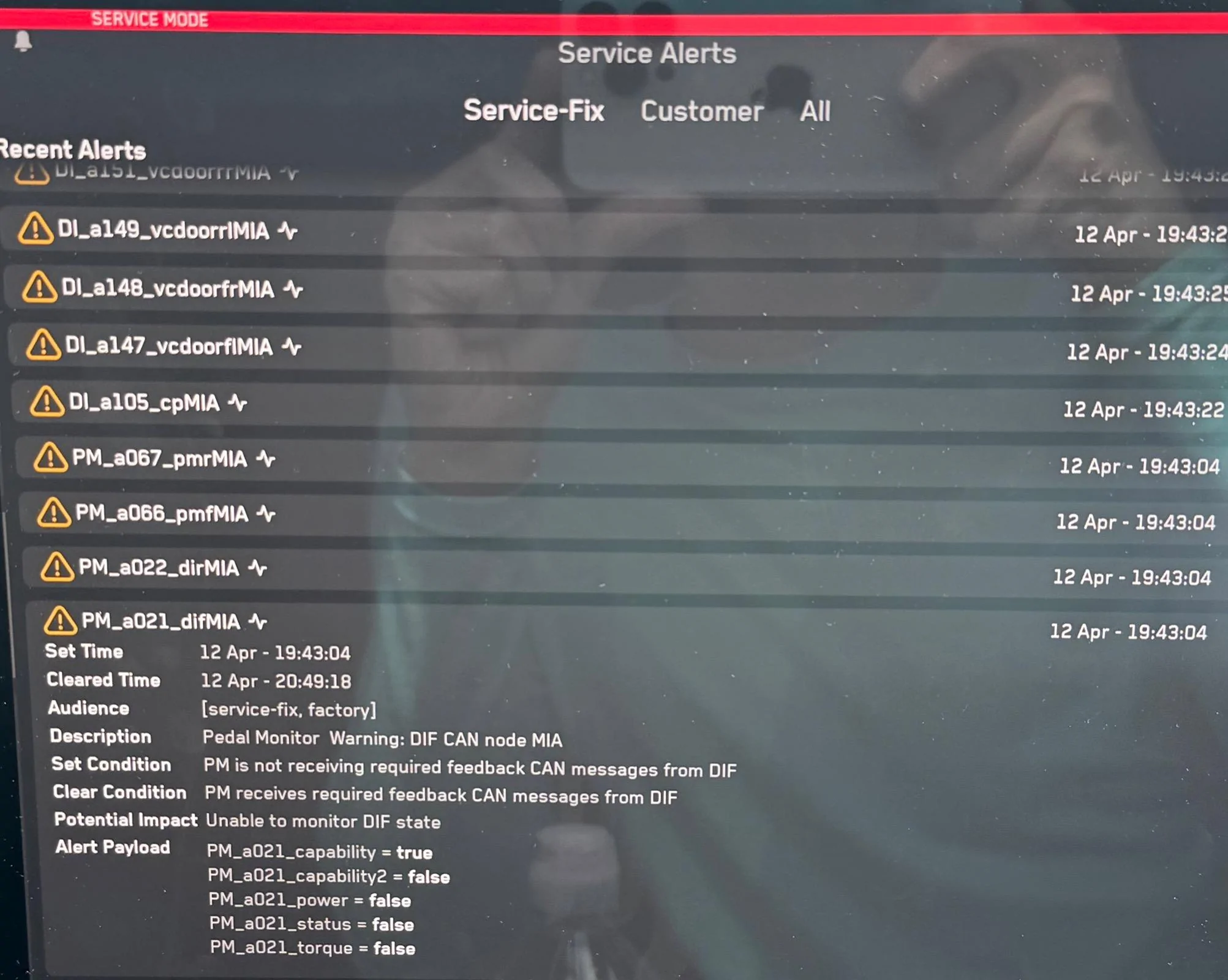

Might be more than one accelerator related issue:
Tesla Cybertruck Brake Malfunction; hit light pole 1713204122938-w0
-capability2= false might mean one of the 2 hall sensors isn't reading.
