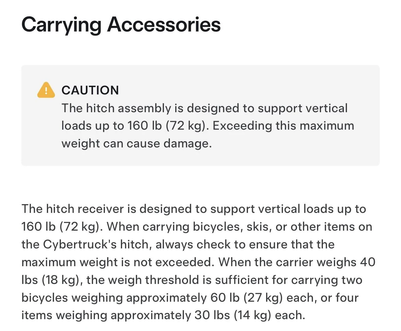

I am in disbelief right now. Is this true ?
https://www.torquenews.com/11826/te...e-vertical-loads-model-y-no-more-160-lbs-or-2
"The hitch receiver is designed to support vertical loads up to 160 lb (72 kg) "
This would help explain all the issues others have had towing stuff.

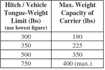

Boss Truck Accessories - Hitch Mounted Motorcycle Carrier -Instruction manual
https://www.discountramps.com/images/art/04100 Boss-instructions.pdf
* Do not overload. Maximum capacity is 350 lbs. on a hitch receiver with maximum tongue weight rating of 500 lbs. Maximum capacity is 400 lbs. on a hitch receiver with maximum tongue weight rating of 750 lbs. See chart below
Do not exceed the tongue weight limit for your vehicle or the tongue weight limit for your hitch receiver.
These may be two different figures. It is your responsibility to ensure that your hitch receiver tongue weight limit is equal to or less than the limit for the vehicle. This should have been determined at the time the hitch receiver was installed.
To determine the maximum weight capacity of your Hitch Mounted Motorcycle Carrier, see the chart below:

I need Tesla to clarify if 160lbs really is the vertical load limit. Can anyone help me? Just to put it into perspective of what I’m dealing with, if the Cybertruck does have a vertical load limit of only 160lbs and I can’t haul bikes off the hitch, then I would have to cancel my camper ($24,000) and range extender ($16,000) so this is a $40,000 question for me lol @greggertruck any chance you could help me get to the bottom of this? I just need to know if this is accurate or copy/paste from model Y owners manual.

This question was raised by me, I’m the one quoted in the article, this is my use case. My question is, why can I do this on every other pickup truck except the cybertruck?
This does not seem to be a veritcal load as it is described in the owner's manual

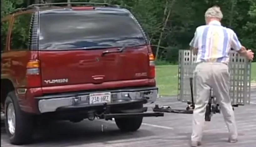

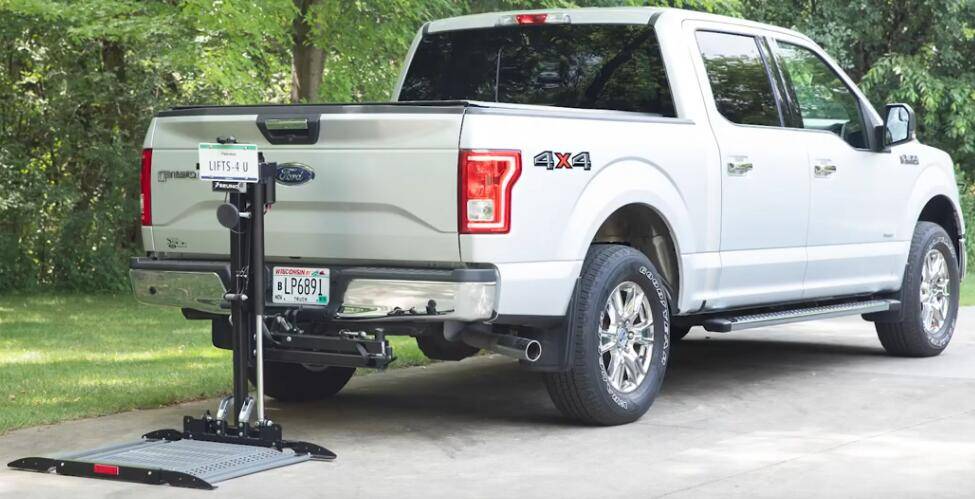

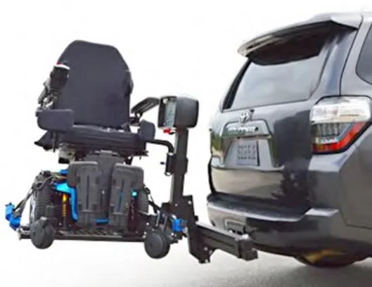

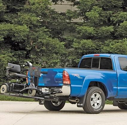

This is not just a recreation issue. Need minimum of 350 lbs to support mobility & accessibility devices and thier cargo carriers.
Certainly some people (passengers but could be drivers) need powered wheelchairs or mobility scooters and a hitch mounted cargo carrier on back of their street-legal vehicle. U.S. population has increasing share of older people.
After waiting total 6-8 years for non-Foundation series affordable Cybertruck even some 2019 Cybertruck reservation holders might need theses devices.
With coming FSD for Cybertruck, there will be even more reason that Cybertruck needs to support this accessibility.
Many competitor vehicles support minimum of 350 lbs for hitch mounted cargo carrier:
Many models of Toyota mid/full-size SUVs and full-size Tundra pickup truck
GMC/Chevrolet 1500 series (or higher) SUVs and full-size pickup truck
Some Cadillac SUVs
Ford F-150

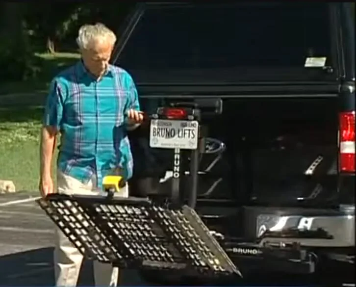

Bruno Out-Sider Scooter/Powerchair Lift ( hitch mounted )
The Out-Sider maintains all your seating and cargo space by installing into the hitch of your van, truck or SUV.
Provides customers with convenience and safety by allowing them to easily raise and store their unoccupied scooter or power wheelchair outside their vehicle.
Installed Weight with tail-gate/hatch-door SwingAway: 142 lb. (64 kg)
Installed Weight without SwingAway: 105 lb. (49 kg)
Lifting Capacity: 350 lb (159 kg)
https://www.bruno.com/scooter-lifts/out-sider

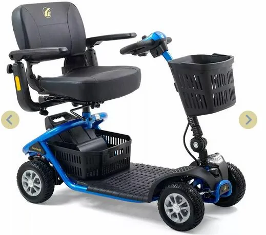

Golden Technologies LiteRider 4W
Weight: 133 lbs

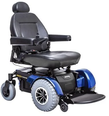

Pride Mobility Jazzy 1450
Weight: 250 lbs
https://www.pridemobility.com/jazzy-power-chairs/jazzy-1450/specifications.asp
