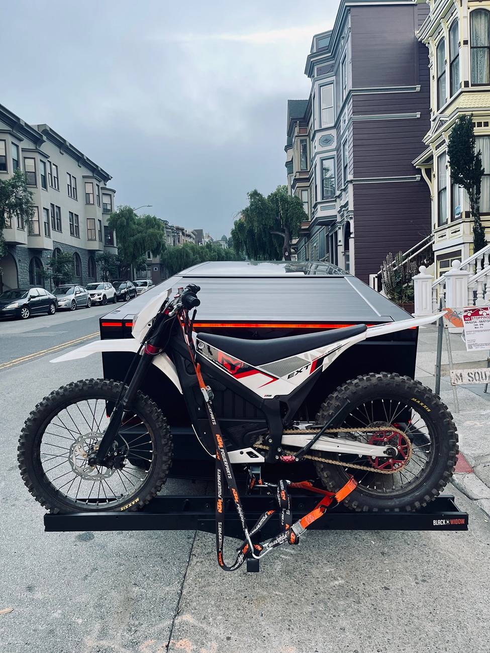

Towing weight applies the force differently than say a bike carrier, or a hitch step that sticks out. So two different limits, one (1,100 lbs) for towing and the lower one (160 lbs) for other scenarios.
This is not unique to the CT, there are other vehicles that are fairly similar in that regard.
Since I weigh more than 160 lbs, I won't be putting a hitch step on there. :)
A hitch step would be rated for the full 1100 lbs. hitch rating because it can't impose a side load. In a static situation I'm sure you could put two tons on a hitch step without damage (assuming the hitch step you bought could handle that much).

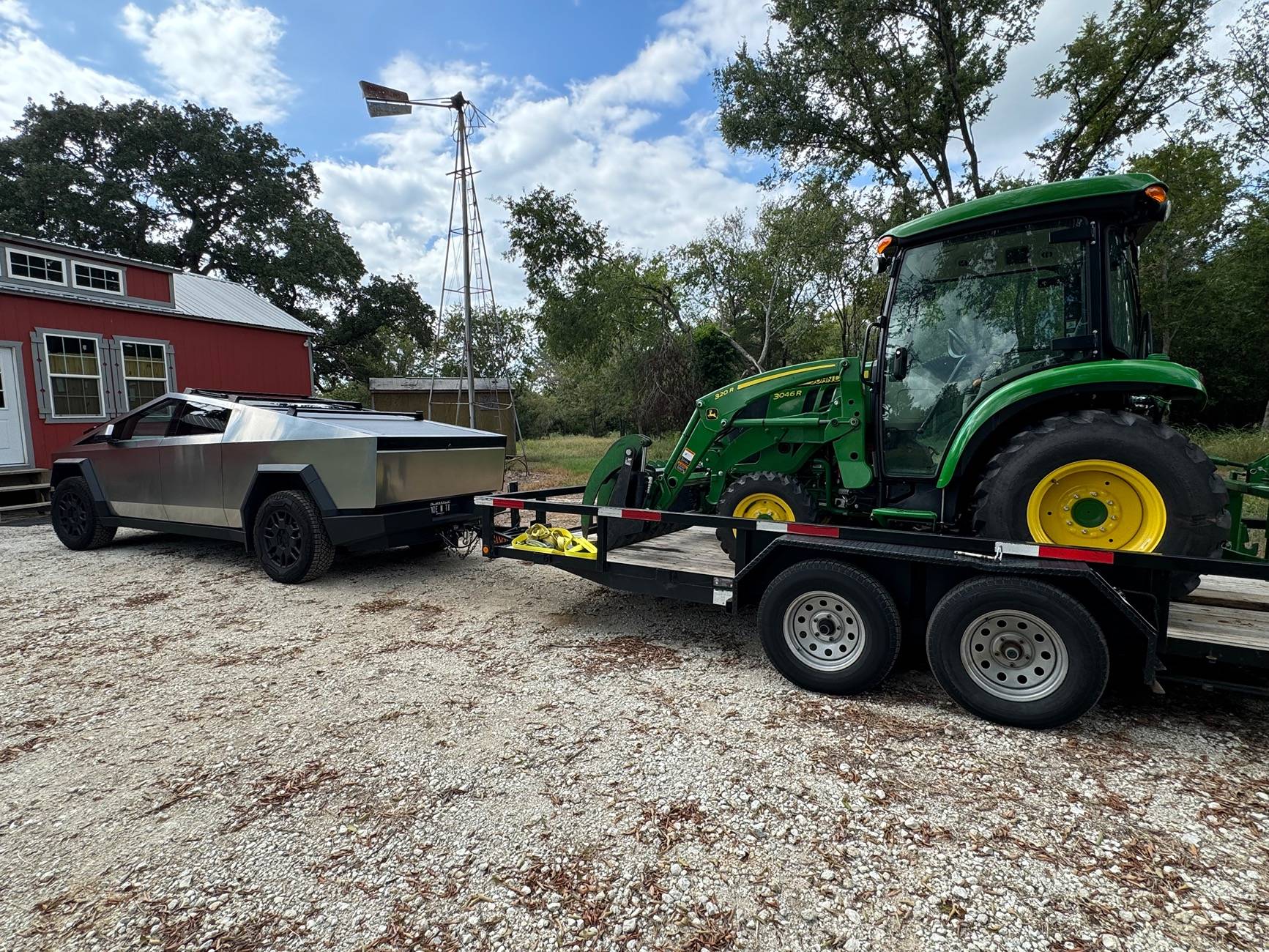

Agree 100%. I tow my 10k lb tractor all the time, county bumpy dirt road, across ranch, 90mph on highway… Truck tows amazing. Towing an ATV you won’t even feel it back there.

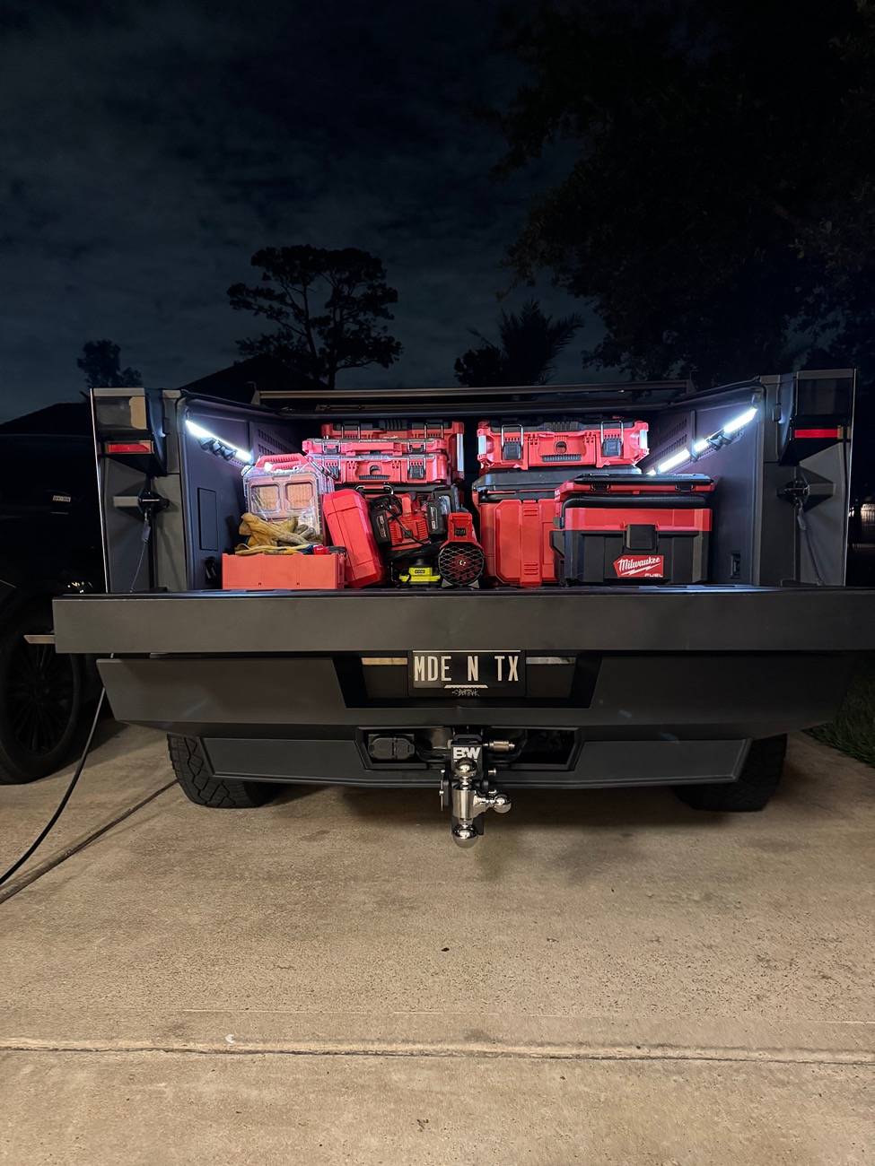

Also for what it’s worth…The BW 5” drop stow & go hitch fits awesome on our trucks. In the receiver it folds back to stow perfectly. Pricey, but best looking and quality I could find that would fit exactly.
